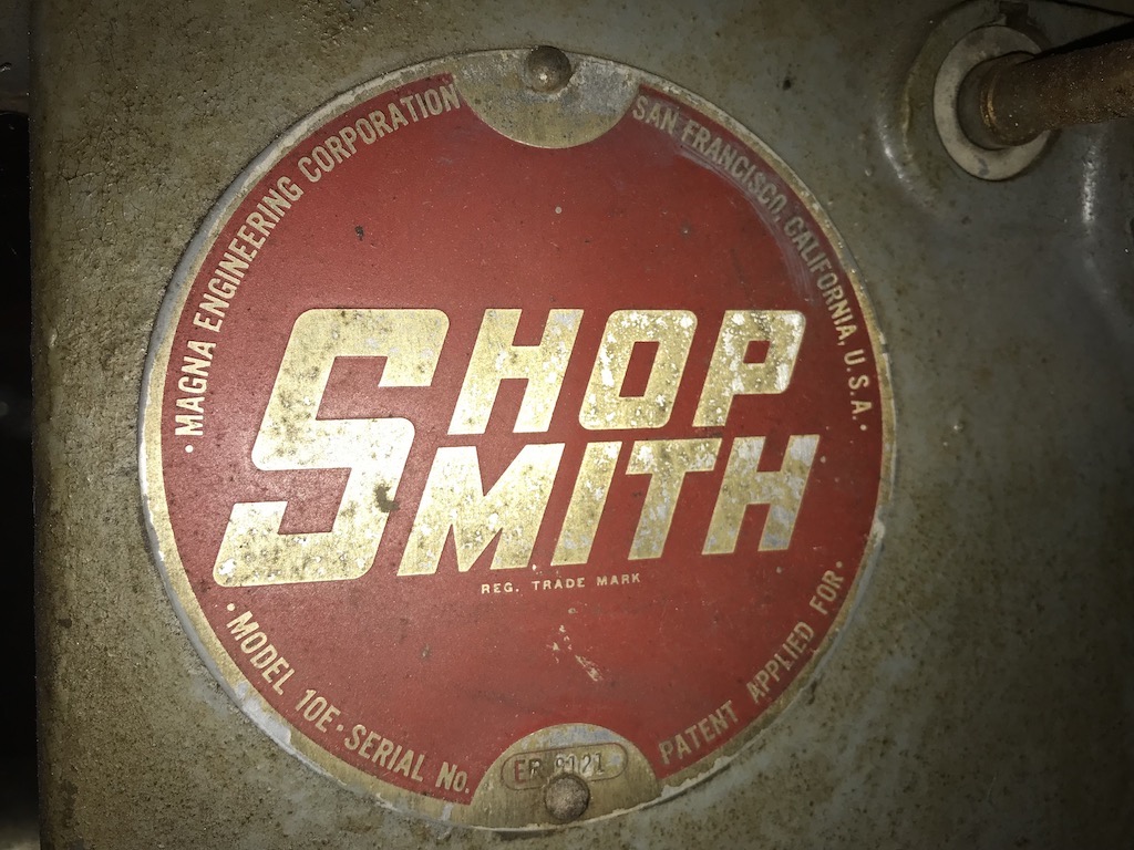

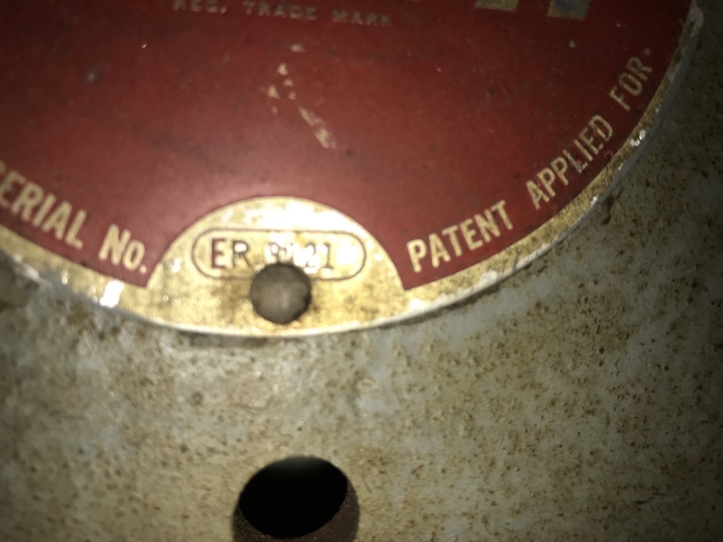

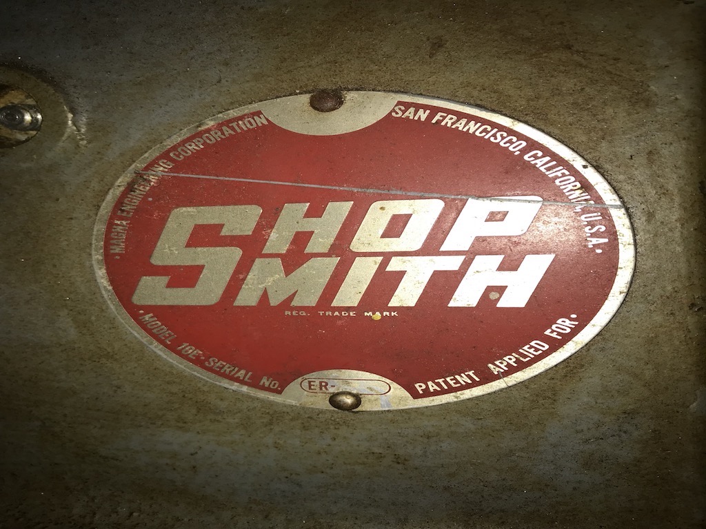

What is the serial number on this machine? Can you post pictures of the two "badges" for us? Demo machines had a logo badge on the back of the headstock so customers could see it while watching the Shopsmith being demonstrated. None of the production Model 10E or 10ERs I have seen have an extra Logo/Serial Number Plate on them.Also I've noticed that this parts machine has two ShopSmith round badges. One with the serial number and the other without.

Here are some pictures of the other machine I purchased that you requested. The serial number is ER9121. I will be using this machine as a stand alone drill press. This machine also has the shaft kit for the extension for the 4E jointer. I took pictures of both badges. Operators side and the other. Serial # is on the operators side.
- IMG_2411.JPG (235.83 KiB) Viewed 20826 times
- IMG_2412.JPG (137.27 KiB) Viewed 20826 times
- IMG_2413.JPG (239.68 KiB) Viewed 20826 times
