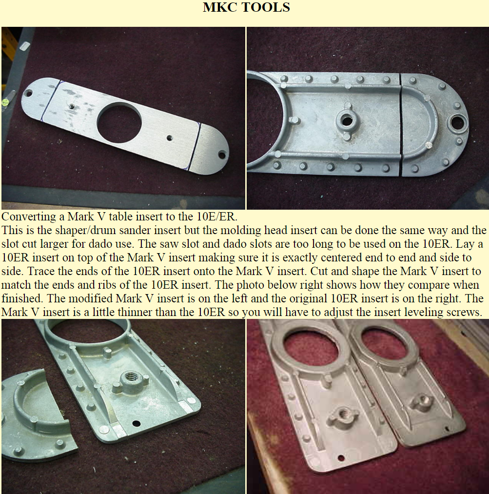

Don't forget Skip at MKCTOOLS the Dean of things 10E and 10ER
He shows how to modify a Mark V Insert to fit the 10ER
see: http://www.mkctools.com/mkvinsert10er.htm
