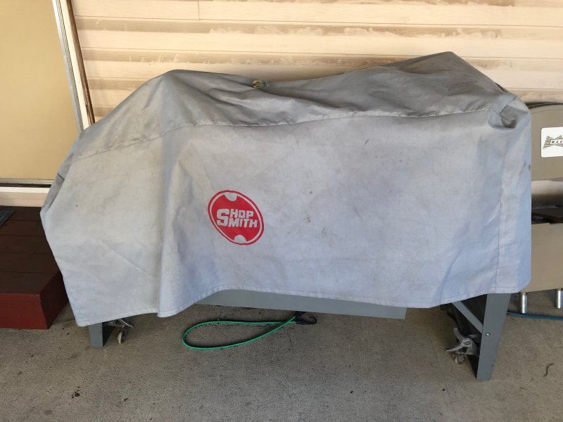

Dansmith wrote:John, T9 sounds like a good way to go regardless of the lack of humidity around here. I've been meaning to try some of it, and just haven't gotten around to it. I guess it's time.
I saw your update over in this post, saying that it had weathered the winter just fine. Out of curiosity, was that with or without the Boeshield T9?
Without.
Dan,
Did you end up putting a cover over the equipment like a breathable material or a tarp? Also, is there any roof structure over it as well to keep rain/snow off? Any other protection advice that you have for outdoor equipment?
Without.
Dan,
I put a breathable lightweight cotton like cover on it. It is pretty much protected from the weather in that it is under my fully enclosed upper deck, so it gets no rain or snow, unless the rain or snow is blowing horizontally which does happen around here. Lowest temperature this winter only got down to about minus 2. The afternoon sun does heat up the area where the 10er is located so any moisture might evaporate. The sun's rays here feel very warm, maybe due to the elevation.
As far as advice protecting outdoor equipment, keep it dry and live in a dry climate area. Humidity around here is minimal.

My working 10ER is under a carport. It has been covered since last fall. I have no room in my shed. But I like it that way. No sawdust coating on everything.
Now if it would just warm up I could start turning again.

amboyna wrote:My working 10ER is under a carport. It has been covered since last fall. I have no room in my shed. But I like it that way. No sawdust coating on everything.
Wow! Thanks for sharing. If you can maintain it under a carport in WA with your humidity there, then I should be able to do it here in AZ. Do you just keep it waxed, or any special tips that you use there? Or maybe do you accept the inevitable surface rust and just routinely clean it up and re-wax?
You are certainly right about the humidity here. Humidity is 83% right now.
I do have most bare surfaces waxed. Especially the way tubes.
The Shopsmith cover is the key.
With that said, minor rust does show up. But I deal with it.
