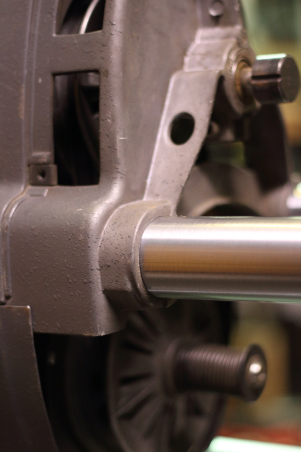

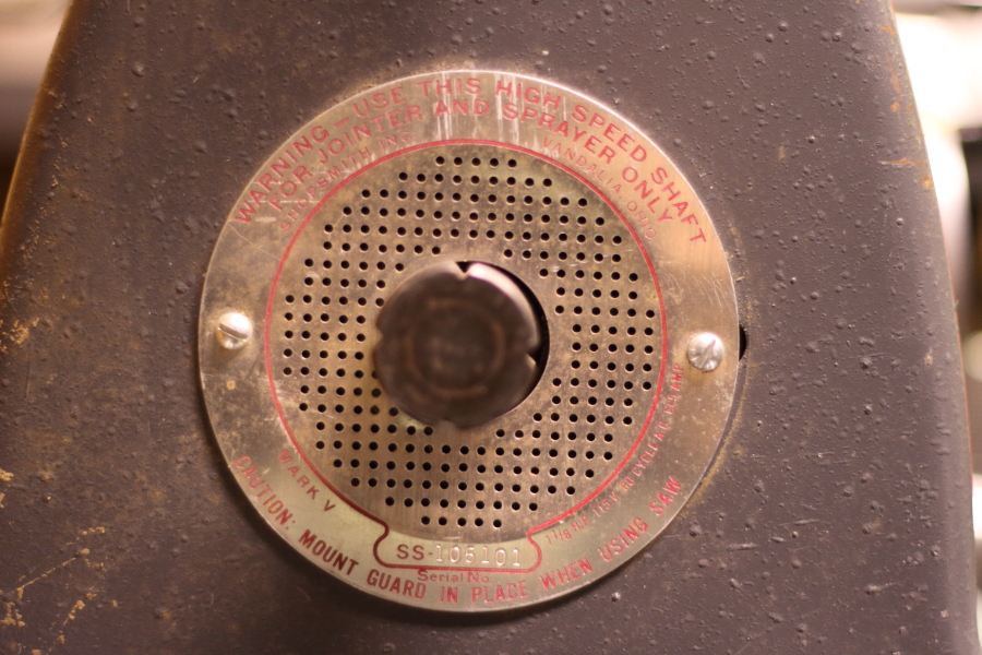

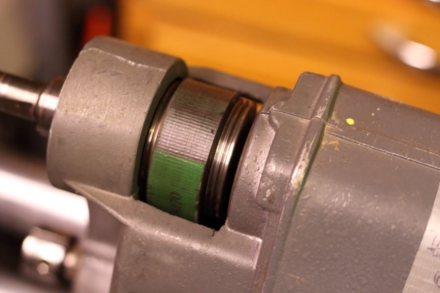

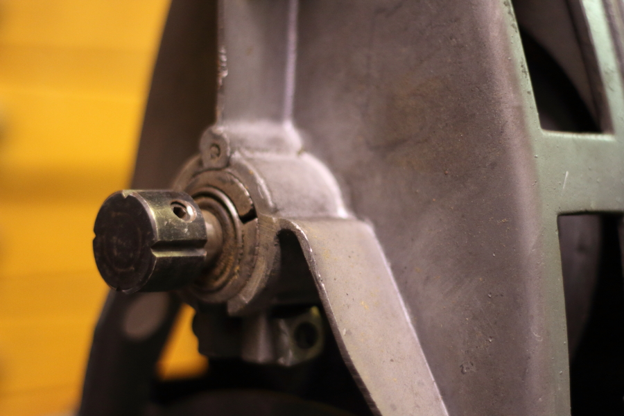

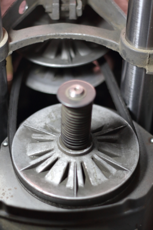

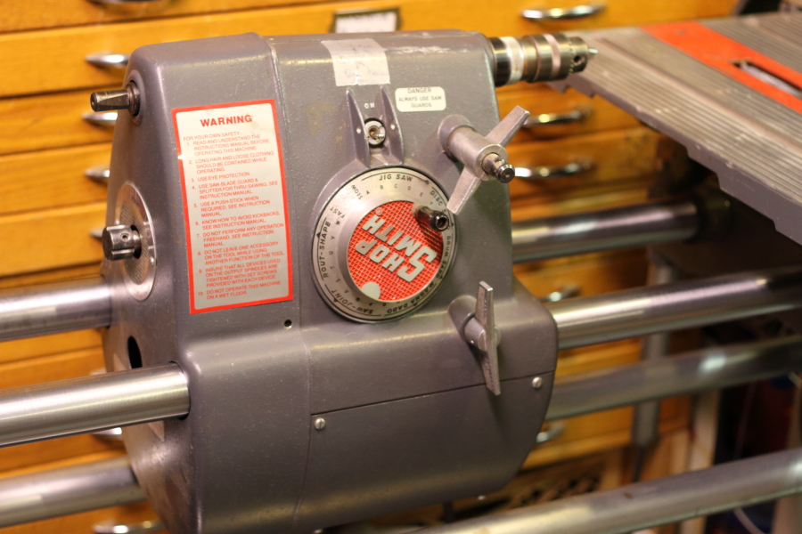

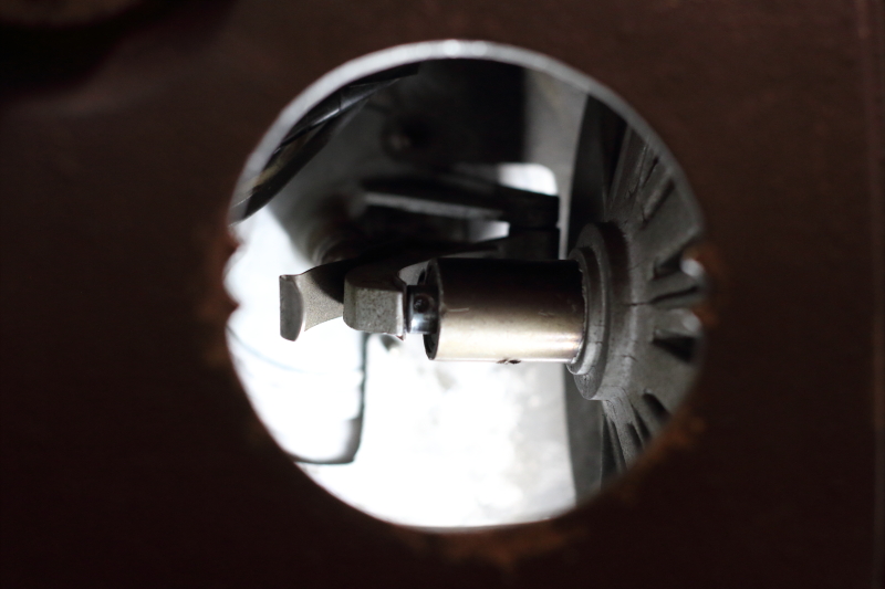

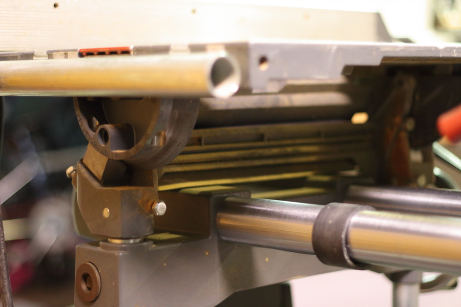

Below is
1 - Headstock with textured gray powder/paint.
2 - Alignment of shaft in cover plate is clearly off and adjusted to the max.
3 - belt in 4th groove
4 - adjusting offset. adjusting back a groove and re-tensioning.
Edit: The offset is difficult to rotate. Is there a recommended lube for this? I have to use a small screwdriver in there and a hammer to tap it around the circle. Tensioning will be difficult. Seems there should be a better way to tension a belt like a lever and lock.
EDIT 2: Broken bolt/screw above the offset tensioner. What is that for? Extraction looks fun.
Wondering if the belt wore in to this angle.
- headstock
- shopsmith-mkv-1.JPG (472.29 KiB) Viewed 8963 times
- plate alignment
- shopsmith-mkv-2.JPG (535.11 KiB) Viewed 8963 times
- vbelt
- shopsmith-mkv-3.JPG (411.89 KiB) Viewed 8963 times
- offset tensioner
- shopsmith-mkv-4.JPG (384.43 KiB) Viewed 8963 times

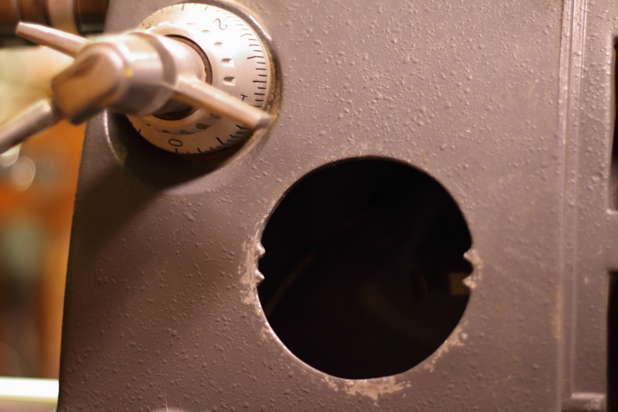

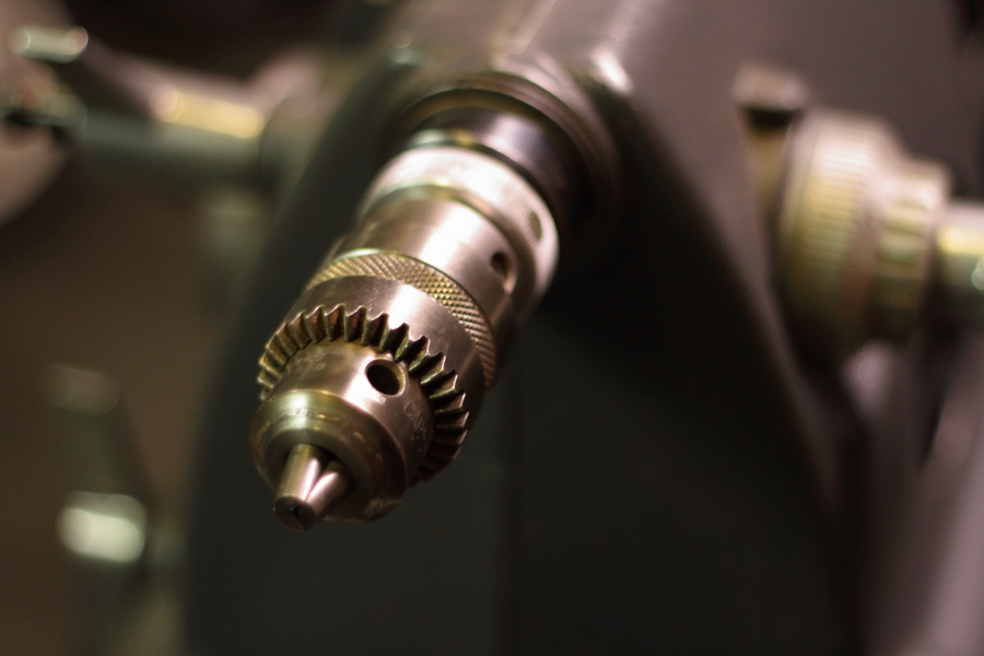

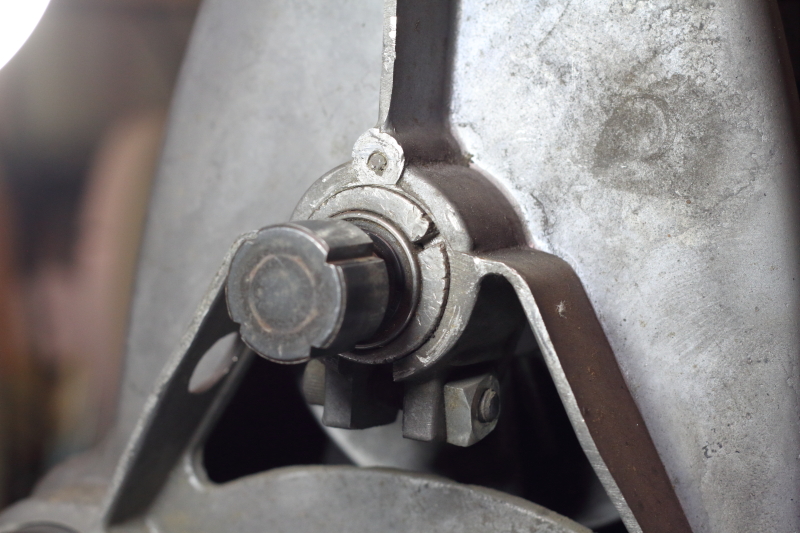

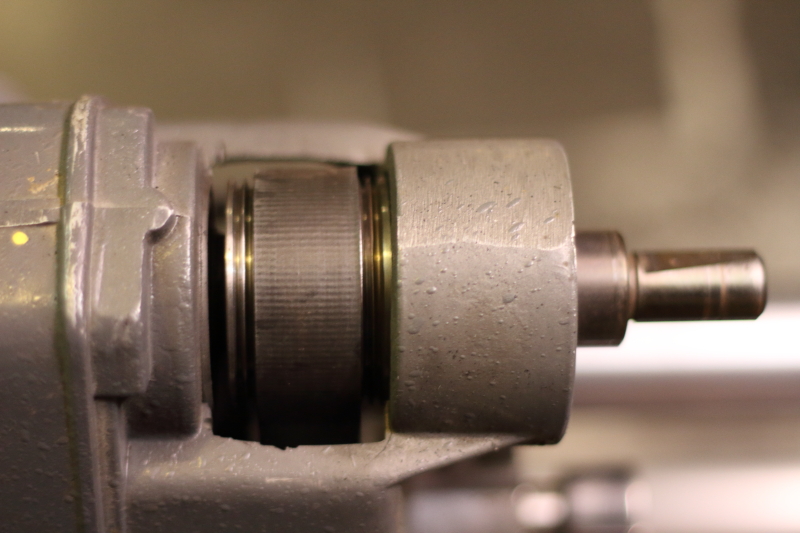

Below is
5 - Lower sheaves
6 - tablesaw double trunions
7 - bunghole
8 - drill chuck
5 - Lower sheaves
7 - bunghole
8 - drill chuck
- lower sheaves
- shopsmith-mkv-5.JPG (367.39 KiB) Viewed 8963 times
- tablesaw
- shopsmith-mkv-6.JPG (387.7 KiB) Viewed 8963 times

- drill chuck
- shopsmith-mkv-8.JPG (347.32 KiB) Viewed 8963 times

Re: 1st SS! Neused MkV Video - Bearings, belt, lube, all 3?
The 'need' is to have the pulleys rotating when adjusting the speed control. It does not need to be under power. Using the sanding disk on the quill shaft to manually rotate the pulleys is adequate so long as the pulleys keep up with the speed control changes.
The poly-v belt appears to be in the third groove.(only two are showing) We counting grooves, not ribs.
When the eccentric is adjusted, the idler shaft moves. That is why the vent plate is mounted with sloppy holes.
Sweet. Does it make the tension adjustment easier if in slow or fast speed at the dial?JPG wrote:The 'need' is to have the pulleys rotating when adjusting the speed control. It does not need to be under power. Using the sanding disk on the quill shaft to manually rotate the pulleys is adequate so long as the pulleys keep up with the speed control changes.
I would say 4th groove, hard to see in the pic from the shadow. I moved it stockside one groove and now there are two grooves on each side of the belt.JPG wrote:The poly-v belt appears to be in the third groove.(only two are showing) We counting grooves, not ribs.
Heh, why didn't I think of that?!?JPG wrote:When the eccentric is adjusted, the idler shaft moves. That is why the vent plate is mounted with sloppy holes.
The adjusting eccentric bushing is sliding out as I turn, which is why I asked about what speed it should be at. It looks like PO beat the thing with a flathead screwdriver or something. I'd like to replace it at some point. For now I guess it is re-tension, run to high speed, oil the sheaves, cycle speeds, recheck.
OK Guess what the purpose of the broken off screw above the eccentric was.
A big headed(washer head?) screw prevents the eccentric from moving out. Replacement is a must!!!!!
I dare say that was causing the poly-v skew.
The OEM screw may be self threading and therefore 'hard'. Extract with care!!!!!
P.S. Fast / Slow / wherever should not affect tension nor the effort to adjust it. However moving the idler shaft may cause the motor belt to resist movement when rotated.
I always increase poly-v tension by rotating the eccentric CW(from slot at 06:00). This moves the idler shaft towards the motor shaft and running torque will tend to move the eccentric towards a tighter poly-v belt. I would move yours from slot @ 02:00 to 10:00.

I can't wait!JPG wrote:OK Guess what the purpose of the broken off screw above the eccentric was. A big headed(washer head?) screw prevents the eccentric from moving out. Replacement is a must!!!!! I dare say that was causing the poly-v skew. The OEM screw may be self threading and therefore 'hard'. Extract with care!!!!!
That makes sense. Any easy way to press that whole tensioning assembly back in? I pressed with a board, but it looks like the speed dial arm inside is counter-pushing it out.JPG wrote:I always increase poly-v tension by rotating the eccentric CW(from slot at 06:00). This moves the idler shaft towards the motor shaft and running torque will tend to move the eccentric towards a tighter poly-v belt. I would move yours from slot @ 02:00 to 10:00.
