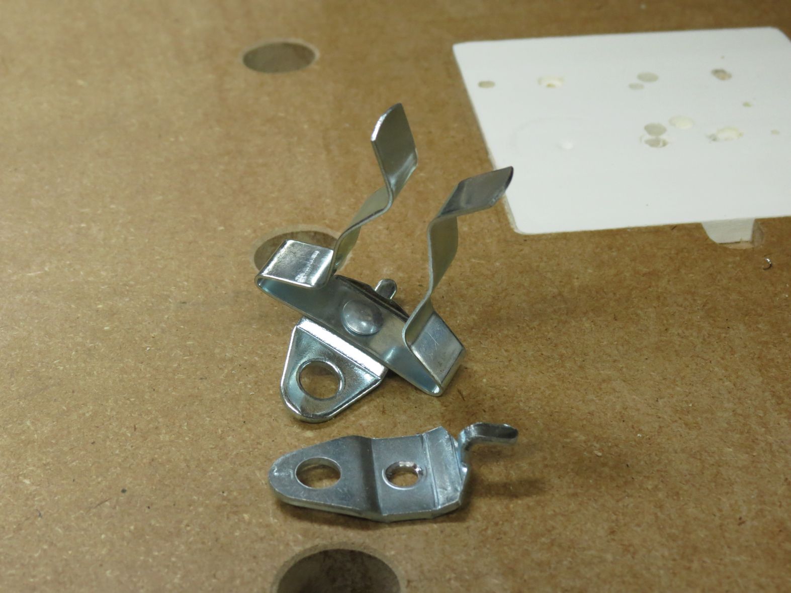

I did find some clips which are designed to mount to pegboard so that is what I went with. I've not used these before so I hope they work well enough. The first task is to get the pegboard clip portion off, so to the drill press to take care of that. The rivet is gone and the clip that I need is left.

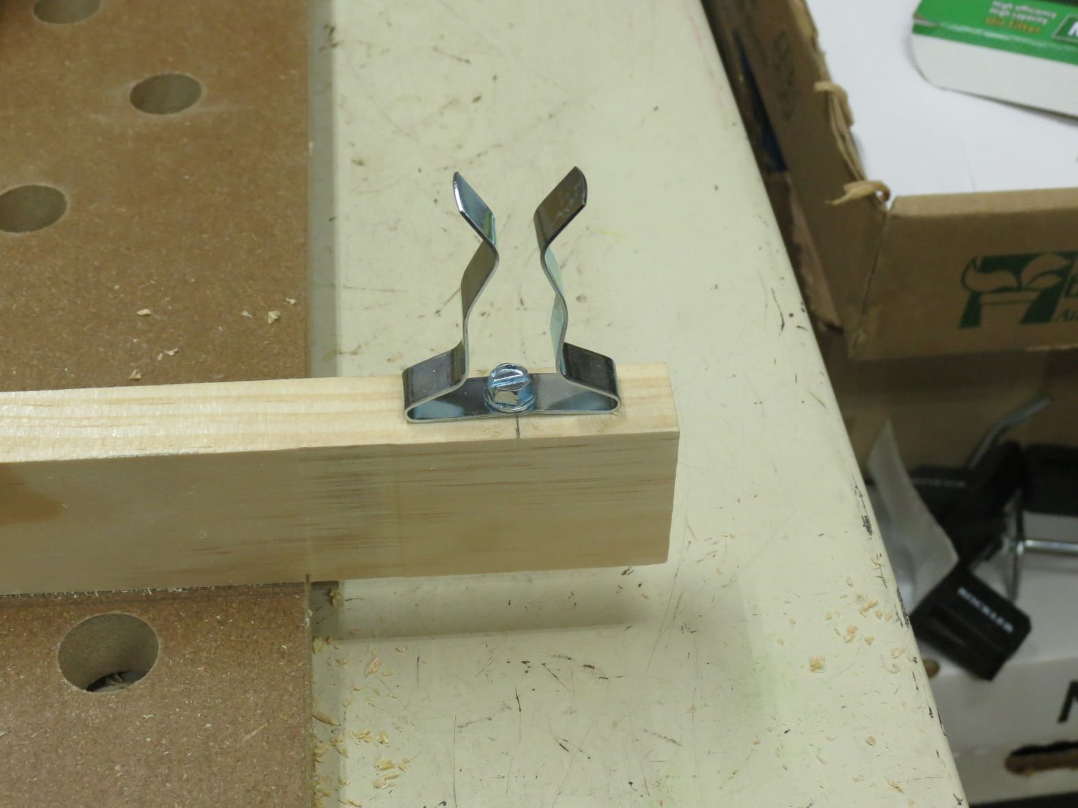

The hole from where the rivet had been is now used to mount the clip.

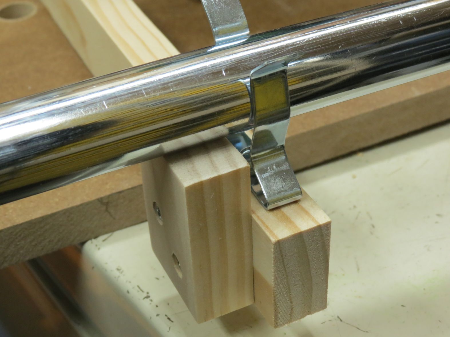

This next bit is a stop to regulate how deep the tubes can go. Not sure if I needed it but I added it any how.
Now if I measured everything right this should just pop on and off the extension tubes....... But I can't really play with it now so one day in the spring when the temperatures allow I'll test it.

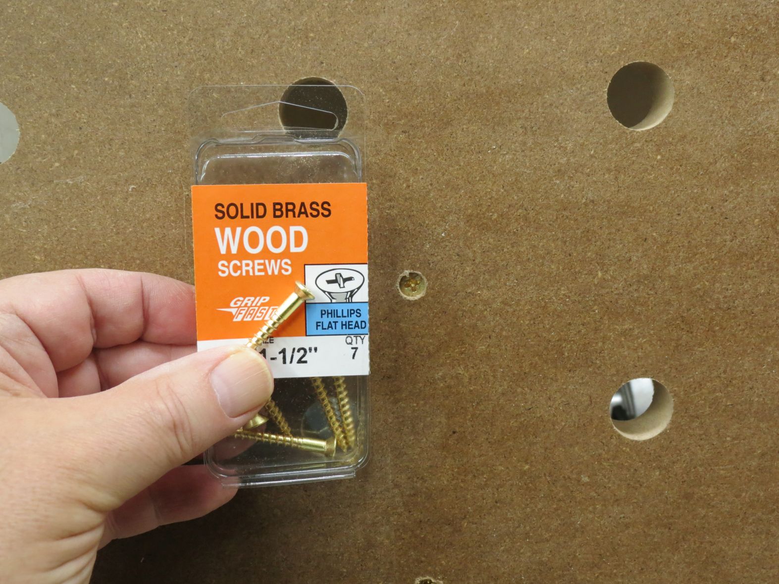

BTW those cross strips the clips mount on are held to the top with brass screws that are recessed. I don't think it is a problem but being they are now brass the saw blade or router bit or what ever tool might hit them will not get damaged by them.
