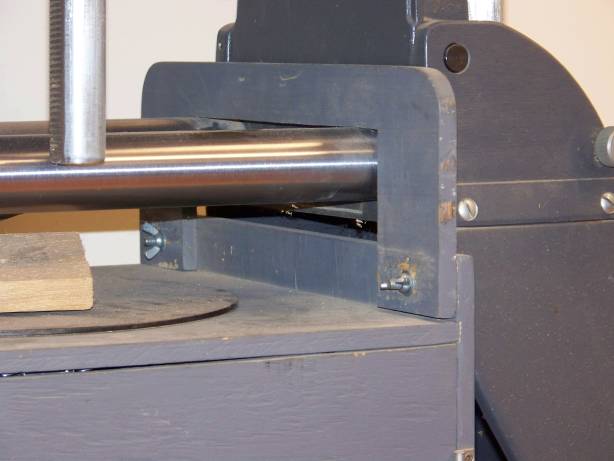

As I replied in a different post, when I made mine, I modifided the the cross bar over the tubes to be a upside down "U" shaped piece. Roll the SS over the cabinet, lower the SS and fasten on the bars over the tubes, raise both SS and cabinet.
- ShopSmith_cab.jpg (26.56 KiB) Viewed 9475 times
