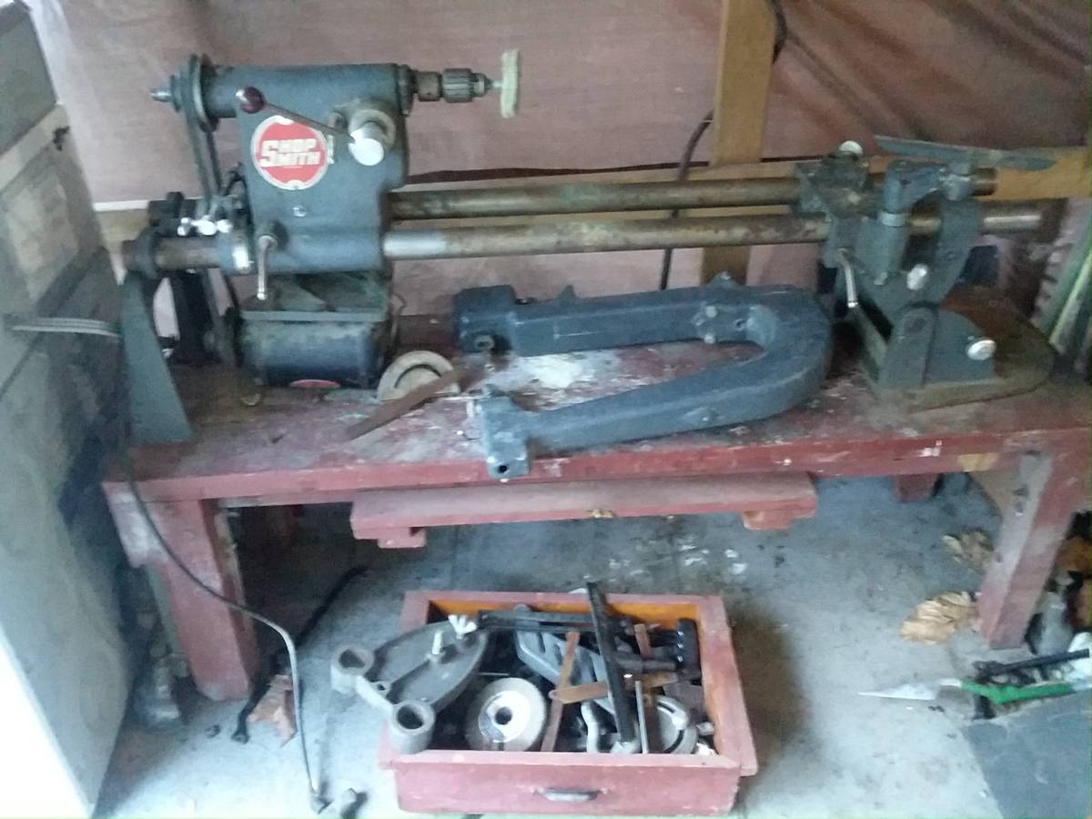

badtheba wrote:Here's photos. I just decided to unload it at work because it's hearted and I don't really have room for it at home right now. Nothing really special came with it except the speed changer. That and the fact that no one really had to drive out of their way for it made it desirable.ImageImage

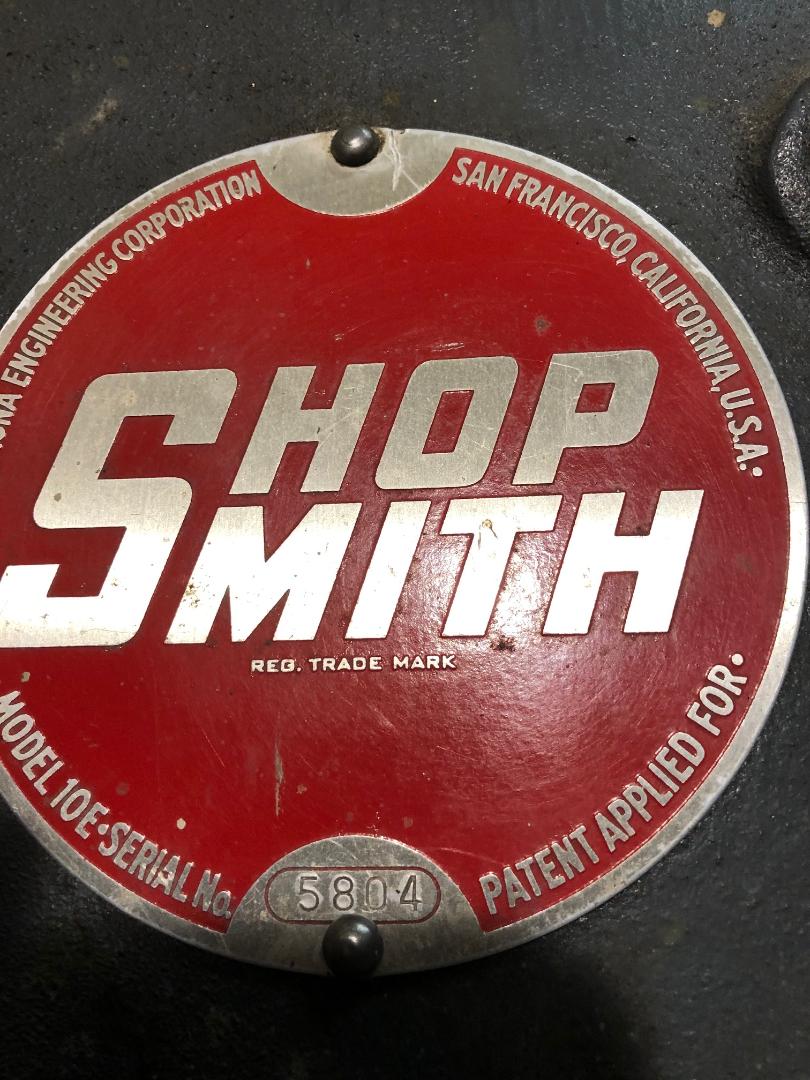

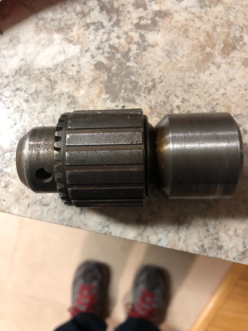

Nice looking machine. Definitely less rust than the one I bought yesterday. Drove 160 miles figuring it had the rare chuck adapter based on photo 1.
And I was right. Also had a speed changer with the numbers going to 8.
Now the problem is getting the adapter off the chuck. Stuff that sits for 70 years...
Curious as to what motor came with your ER.

It came with a GE 1/2hp, that swivels on its bracket. Bigger diameter than another GE 1/2hp I have.
I've also accumulated several motor options. I have 2-3 motors about this size, several good treadmill motor options for when I attempt a variable speed DC lathe option, and one baldor 2HP 3450 rpm that can be wired 110 or 220. I'm putting off any refurbishing on any of the rest until I get my first one completed though.
The speed changer on this one was in great shape. The other speed changer I have has been welded more than once. Though it's still functional, I wanted one that wasn't modified.

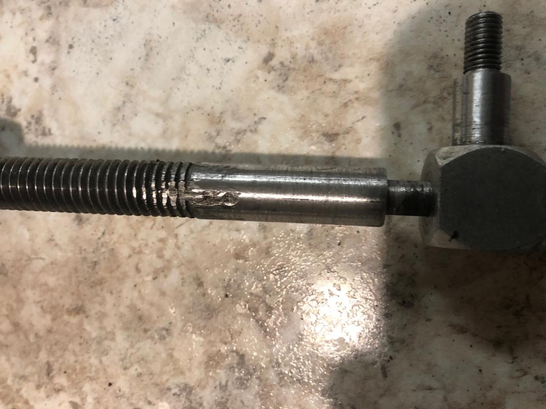

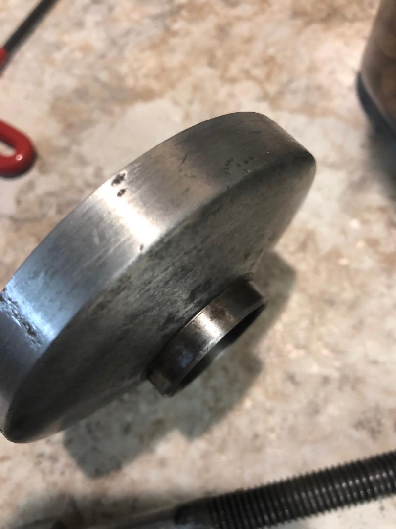

A word of caution re the 0-8 speed changer. I would simply refrain from going above 5. Check the sliding sheave. It should NOT have the step at the bore. The step prevents adjusting until the belt rubbed on the shaft.
Never ever adjust the speed and allow the springs on the control screw to become fully compressed. Doing so causes the breakage mentioned above.

I'm a little lost. Is this the sliding sheave?
The previous owner did crank it to 8 where it scarred the crank shaft threads.
See photo 2.
