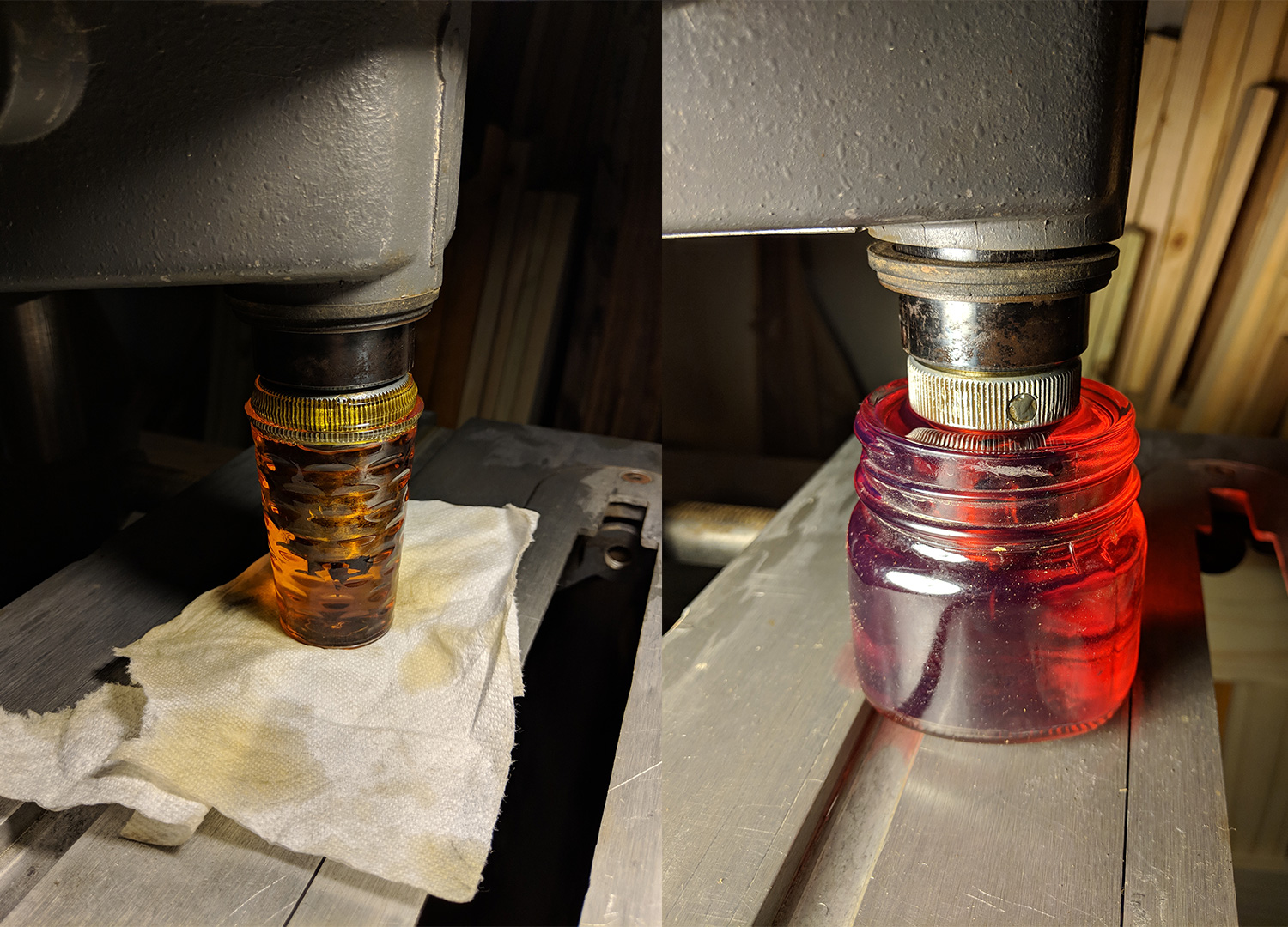

farmerwd
Posts: 24
Joined: Thu Jan 31, 2019 9:46 am
Location: Dallas, Texas
Re: The wisdom of the masses
Post by farmerwd »
Alrighty!
Status recap:
1. So I tried wrenching on it as gently as I could - no avail. I didn't expect as much, but it was worth a try. I'll look around for some of those strap wrenches this weekend.
2. I thought I'd found a perfect option to submerge the thing in penetrant... See orange liquid in the photo. Turns out the penetrant found a stress fracture in that and found it's way out lol. For future reference, dollar store salt shakers fit the quill spindle *almost* perfectly.
3. At this point I was trying to remind myself to be patient, so I worked on busting some rust off of the pipes, and left the lathe center submerged in pure ATF-4. I had some old bottles on hand, no acetone, so I figure it wouldn't hurt.
4. Watched the quill removal video and laughed because I just about did it when I took apart the handles to clean / oil the locks. Good to know that's an option available to me if all else fails.
Next steps: We will see how the bath did this evening, but I started thinking on the way to work today - what would happen if I set it all up to lathe some heavy scrap, say a 4x4 chunk, just without the set screw in place. Would the heat of the machine + the centripetal force of the wood spinning allow for the rust to experience some sort of torque safely? Or at least in a manner the system is designed for? Seems better than hammering at it or drilling into the lathe center at this point.
Food for thought.
Left - PB Blast - Right, ATF-4
Brand new to Shopsmiths - Working with & working on a MarkV - SS54109.

Try Kroil. It is better than any other penetrant I've ever used. It really works. Let that sit for 24 hours. Then heat. Then wedgie.
Also, if everything else fails, I would remove the shaft completely, remove the plastic coupler, then heat it hotter and try again.
It may be that its not rust, but physical burring is causing the jam, in which case even heat may not solve it, you may have no choice but to use a gear puller. I would suggest at that time you're going to have to sacrifice the drive spur, and use a power hacksaw or grinder to cut off the end and keep cutting till you expose the end of the quill shaft. At that point you can put a gear puller on it and simply crank it off. With any luck you will be able to clean up the burr with some light filing and be back to work...

I doubt ATF without the acetone will work.
I am curious where one finds Kroil to purchase.
I am still a believer in kerosene.
Turning a 4x4 between centers sans set screw may be fruitful.
