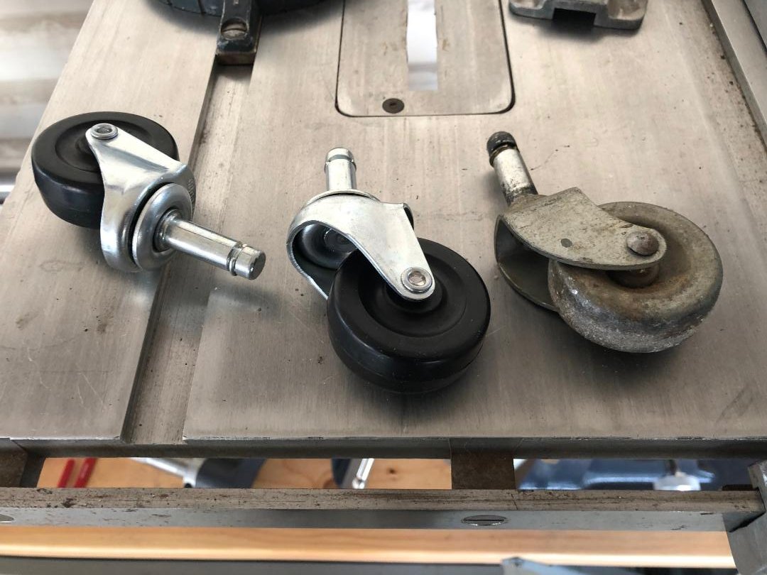

Went to John W. Negus Co. yesterday and purchased a nice set of casters for my 10ER. Made by Allgood in Canada, they were only $5.50 each. Part number AG-SO803-437SX1. Post length is 1 7/16". Shopsmith post length is 1 11/16". So this post is only 1/4" shorter than stock. Wheels are made of hard rubber. Salesman said they were rated at 80 pounds each.JPG wrote:Do let us know what you end up with!
Installed and ready to go. Thanks again Everett!
- casters.jpg (137.2 KiB) Viewed 19956 times

Re: Caster Upgrade
Thank You for posting that 'solution'.
We must realize we be altering the original design intentions.
I think the solution above is an improvement.
The original design had a ball end on the caster stem that rode in a similarly shaped socket at the bottom of the piston bore. That provided the bearing of the weight and required some grease to lubricate as well as rotation bearing.
The 'solution' above has a shorter stem that makes the shape of the new stem moot.
The 'solution' has the bearing race that supports the weight from the lower end of the piston directly to the caster frame.
Only unanswered question is the resultant height(piston lower end to the floor in all three cam positions).
P.S. I like the quality spring retaining clip as opposed to those cheap brass(?) 'things'.

Re: Caster Upgrade
All three cam positions work perfectly. The 2" profile on the new caster is the same as the old caster.
The hard rubber wheels does not move as easy as the old steel wheels. That is the only difference I have found so far.
Machine still pushes fine though.

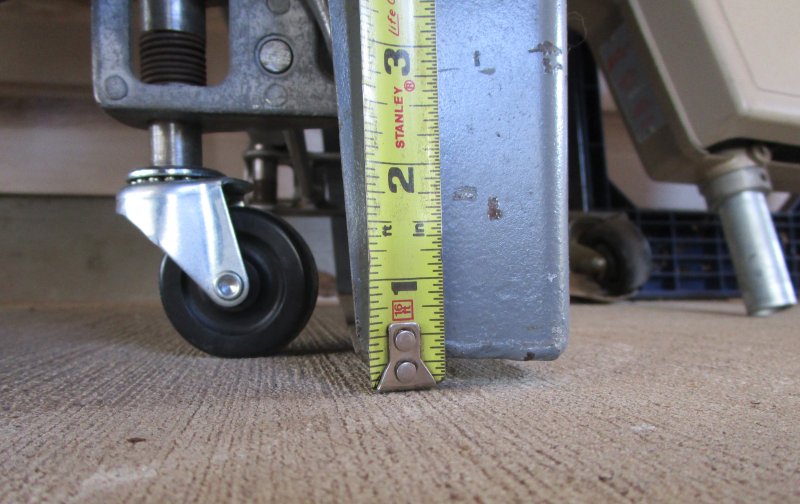

Perhaps perfectly was not the right word to use. Here are photos showing what I have with the new casters on. In the half up position (not shown) the base does scrape a little on the concrete. Several factors may be involved. Broom finish on the concrete. An extra 100 Lbs. from a drawer and tools. Or maybe the fact that the wheels are hard rubber, not steel.JPG wrote:What is thy definition of 'perfectly'?amboyna wrote:All three cam positions work perfectly. The 2" profile on the new caster is the same as the old caster.
- Caster_01.jpg (66.57 KiB) Viewed 19886 times

Re: Caster Upgrade
I think a washer or two will make it closer to 'perfect'.
Re: Caster Upgrade
Never thought of that. Thanks. I will give it a try.JPG wrote:I think a washer or two will make it closer to 'perfect'.
