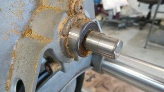

I gotta ask what the idler shaft looks like with the belt cover off. The vent plate pix looks like the bearing is sticking out the rear too far.
As for the eccentric/bearing moving 'into' the headstock, there is nothing to prevent that other than the control sheave etc.
The bearing inside the eccentric is positioned and retained by the set screw under the eccentric.
If the idler shaft pulley(idler sheave) is not positioned correctly the poly-v belt will not be positioned correctly relative to the drive sleeve pulley.
Both the eccentric and the bearing should be very close to flush with the surrounding part of the headstock.

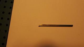

Question; in dis-assembling the 510 I noticed the key falling out of the keyway soon as I removed the quadrant assembly, along with the control sheave.
What is supposed to keep it in? is this a typical key?

There is a 'spot' near the end of the keyway near the middle of the idler shaft. That spot deepens the slot. The key end is bent so as to drop into the spot. The idler sheave slips over that area and prevents the key from coming out. The idler sheave is positioned/retained on the idler shaft by a very small almost inaccessible 'hair clip' (for lack of a better name) that is shaped like the clip on the caster piston but is much smaller. The clip drops into a small groove in the shaft.
This is true with both versions of the idler shaft.

JPG wrote:I gotta ask what the idler shaft looks like with the belt cover off. The vent plate pix looks like the bearing is sticking out the rear too far.
"The older I get..The better I was"
Re: Poly V belt replacement
YEP THAT ain't right!!! THAT explains a lot of stuff re speed range.roneg wrote:JPG wrote:I gotta ask what the idler shaft looks like with the belt cover off. The vent plate pix looks like the bearing is sticking out the rear too far.
Time for a complete disassembly and put together correctly. *
Is the set screw under the eccentric 'over' the notch in the bearing? I am guessing it is not.
Considering recent posts/questions, the PO got it pretty well screwed up.
WE WILL get it corrected!!! *
