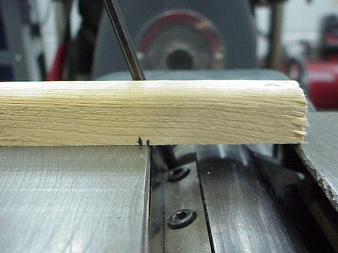

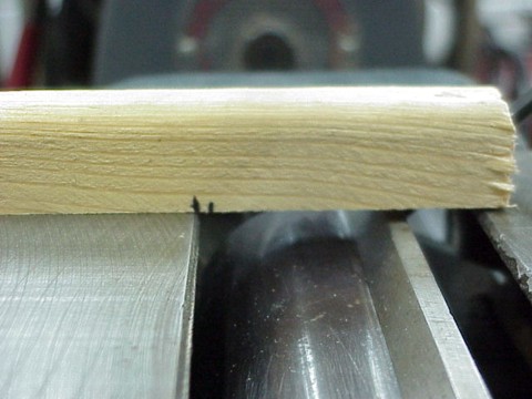

I'm really struggling with this whole process. I tried the metal ruler technique from the SS manual. After the very first attempt I couldn't get the knives to "grab" the metal edge of the ruler at all.
Then I tried using a flat wood stick as some in the woodnet forum swear by. The marks on the stick show the precise movement caused by the knife movement. Then supposedly you use that stick with the marks to adjust all the knives.
Before the knife grabs the stick, mark the very edge of the outfeed table on the stick.
[ATTACH]58[/ATTACH]
Then after rotating the knife you mark the position of the stick. The movement should be 1/8" or less.
[ATTACH]57[/ATTACH]
Seems like such a great idea, but I just couldn't get any repeatability at all. Any ideas?
