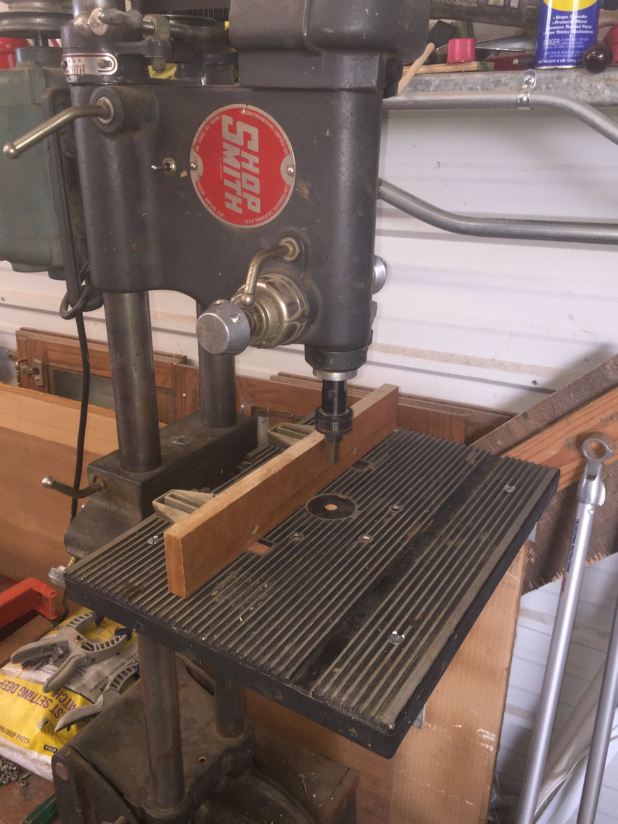

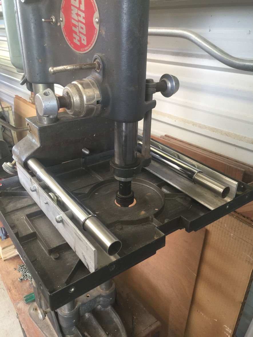

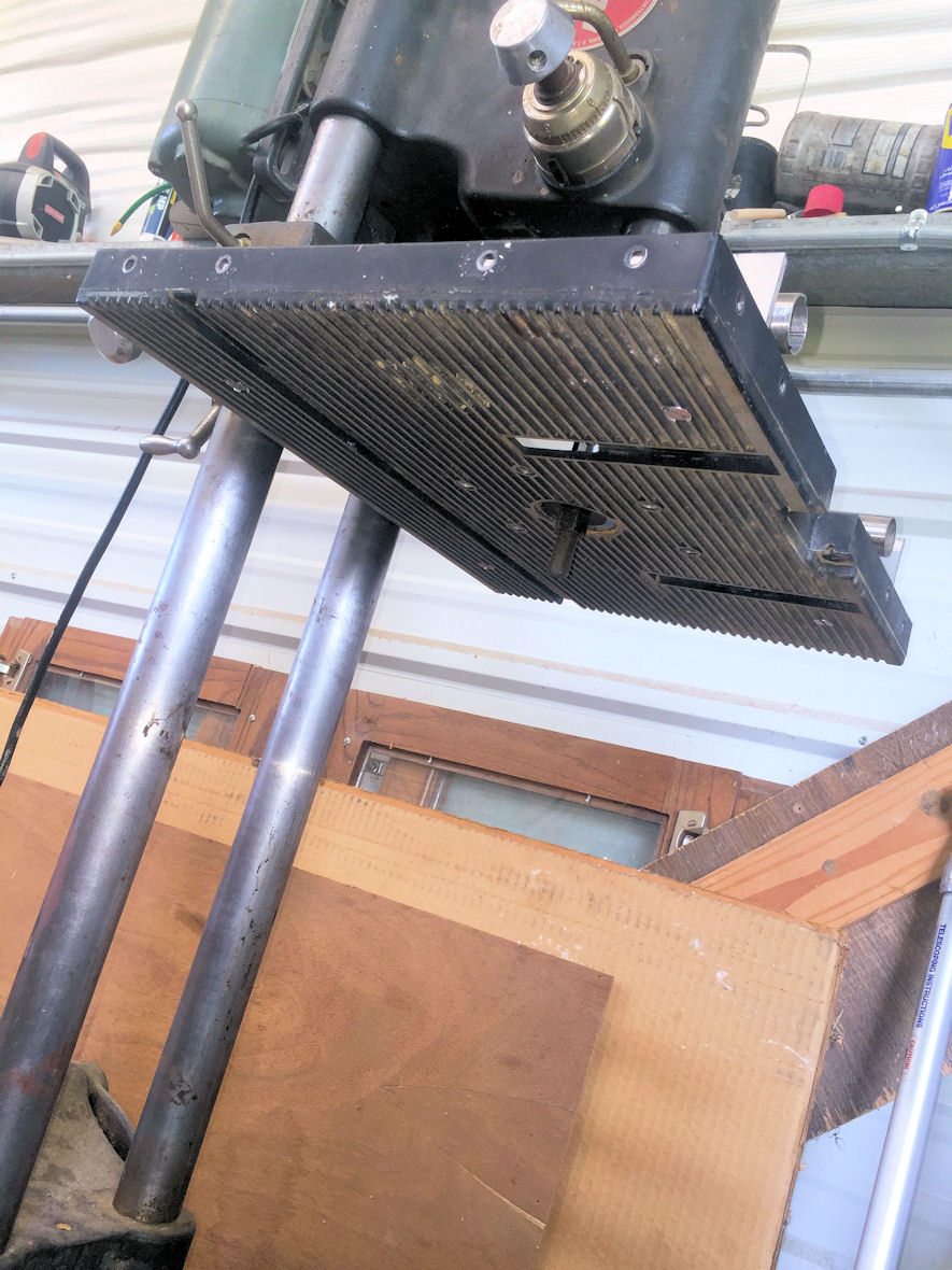

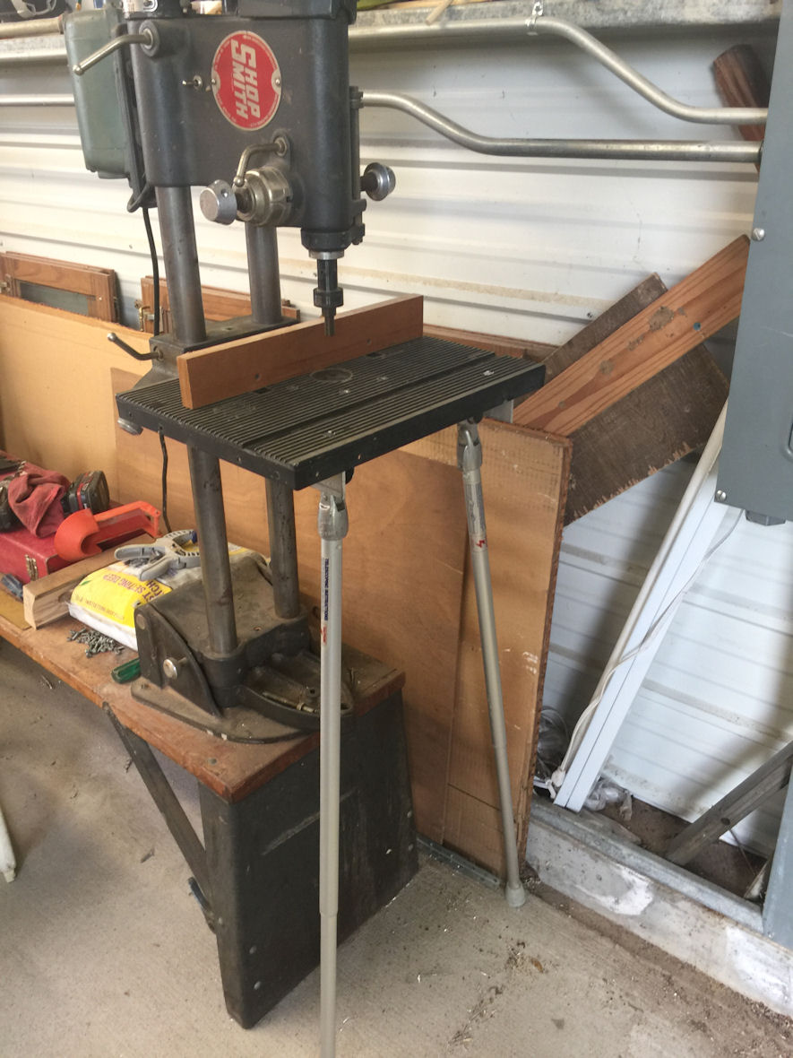

Thanks, I didn't remember seeing that one. I came up with a table using my old craftsman router table, parts from my 510 to 520 upgrade, aluminum angle from my brother and 1" tubes from old store fixtures.
Imagine this one rotated 180 for shaping
As a router table, maybe pin routing
With support legs which I would use in the shaper setup too
