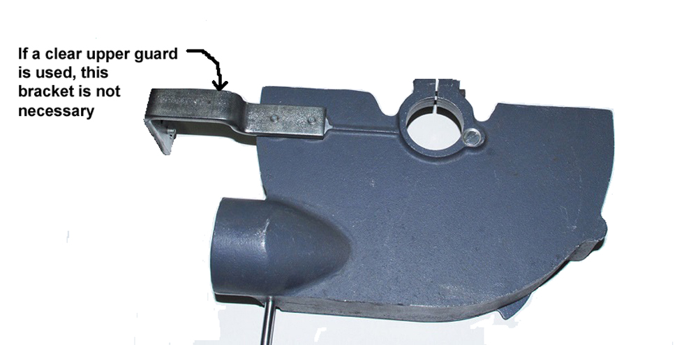

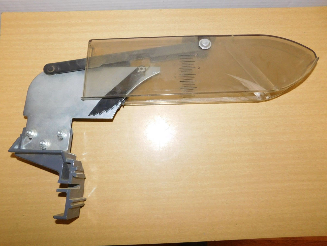

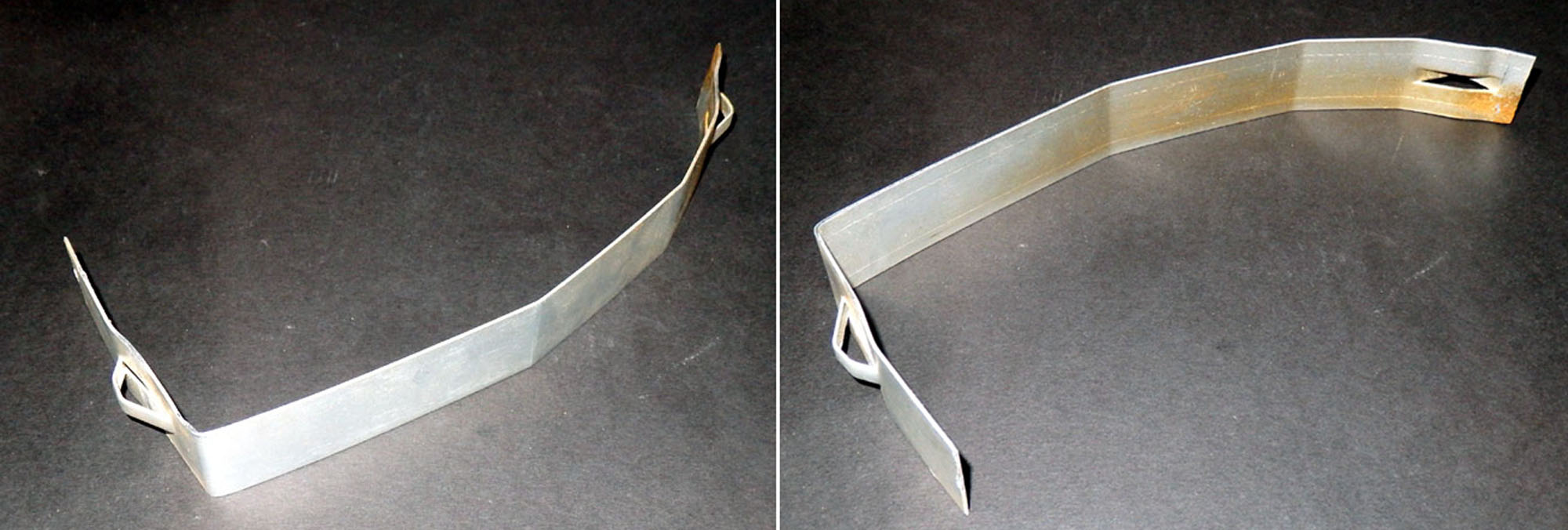

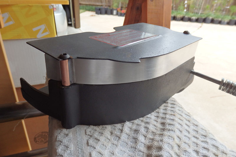

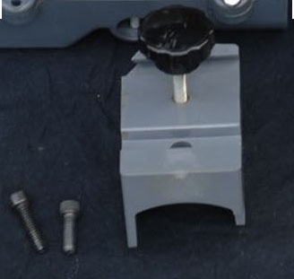

In addition to the good advice you have already gotten, one other option if you anticipate staying with a 500 system is a hybrid ... the lower metal guard for a 500, and the upgraded clear upper guard that attaches to the table post. The lower guard is fairly easy to find on ebay ... the clear upper guard is not seen as often, but they do appear there from time to time. Be sure to look for one with the mounting block. For the lower guard, there was also an accessory spacer made of thin aluminum that is handy for use with dado blades, and for me, makes blade changes easier. The original is rather flimsy, so I made one from an aluminum bar. Many will say dust collection is not as good as the 2 piece plastic lower guard, but I'm content with my hybrid system.
- 500 upper guard upgrade.jpg (139.63 KiB) Viewed 10027 times
- Mounting Block Front.jpg (24.33 KiB) Viewed 10027 times
- 505628 Lower Saw Blade Guard.jpg (194.66 KiB) Viewed 10027 times
- 555070 aluminum spacer.jpg (194.45 KiB) Viewed 10027 times
- spacer view2.JPG (91.09 KiB) Viewed 10027 times

Shopsmith still sells the Model 500 clear plastic upper guard but not the mounting block. If you wish to go with that guard system or the hybrid suggested by br459 above you will have to find a used mounting block for the upper guard.The complete upper and lower guard Ed is referring to is still shown as available in the service parts section but costs almost $376 new. $155.39 for the upper guard and $220.42 for the lower guard.
