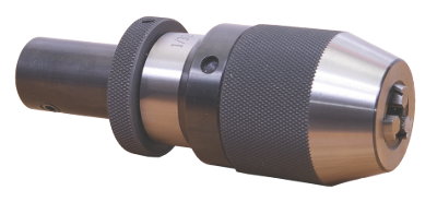

The Keyless Drill Chuck should be included as a Shopsmith Drill Chuck. I have not found a need to this point to have a Drill Chuck larger than 1/2" as is all other Drill Chucks from the makers of the Shopsmith in the past. Someday I may get one and can then update the Drill Chuck picture but for now it will be only the 1/2" Drill Chucks. Below is Shopsmith's picture of the 5/8" Keyless Chuck for reference.
556273 Keyless Drill Chuck.jpg (16.45 KiB) Viewed 27303 times
As for the question of who makes this chuck the answer comes from Shopsmith's online catalog for the Keyless Chuck.
Manufactured especially to Shopsmith's stringent specifications, this rugged, smooth-acting chuck cuts bit-changing times significantly -- feels like quality in your hand -- and delivers the kinds of performance you would expect from any Shopsmith product. It's a real “beauty”.
Sorry I do not have a picture of the 1st version of the 1/2" Router Chuck P/N 505597. I have only seen it in a catalog and for sale with a Mark VII.
