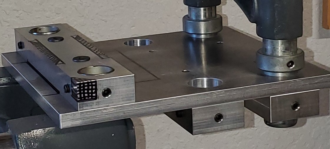

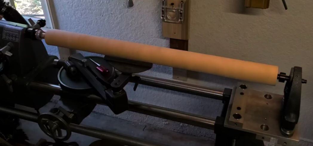

After years of wanting to extend my lathe capacity my son finally gave me a reason to take this on. He has been turning his own baseball bats but is limited to 33-1/4” “ABSOLUTE MAX” end to end no waste with dead center ONLY! Our first attempt was the wall method, but quickly identified the many issues that would need to be resolved…stopped after 1st attempt. I then knew I had to design and build an integrated solution that he could quickly just “Drop-In” with little to no alignment(s). I can now turn a full 37” blank bat billet using a “LIVE CENTER”! My new capacity is 39-3/4”, but with very little modifications I can easily take it to 46-3/4”. This was more than he needed, but it’s obvious that I could’ve designed this longer if required.
Extension plate with up-coming mods
20200703_182421 (2).jpg (149.5 KiB) Viewed 54151 times
Full bat billet with room to spare
Tailstock Extension Plate 2.JPG (56.09 KiB) Viewed 54151 times

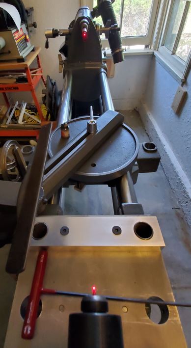

Using Laser to set Alignment
Tailstock Laser Alignment.JPG (51.5 KiB) Viewed 54151 times

You could have anchored it to the wall instead of building a complex tailstock extension. Here is an example of what I think in extraordinary length.
https://www.youtube.com/watch?v=rQbzEz0-7X0
gpuckett
Bronze Member
Posts: 5
Joined: Fri Jul 03, 2020 6:51 pm
Re: Tailstock extension
Post by gpuckett »
Like I said, that was my 1st brief attempt. In fact if you look at pic#2 you can see the wall mount that I made to accommodate the SS "Eccentric Mount" from the original tailstock. This gave me the ability to adjust my "Live Center" UP/DOWN & LEFT/RIGHT and initially it seemed like a very simple solution, but when you begin addressing all the different stabilization and safety problems it just didn't seem worth it. Bottom-line "small shop" need to move things around too much and we both like to move the SS outside on the driveway to enjoy the fresh air...which I get to do now!
It may appear complex, but not really. I used scrap cuts of aluminum, I'm a good CAD designer, I have access to a basic manual lathe machine to cut the metal. But... because I'm very anal with precision I wanted as tight tolerances with the "Tool Post" holes (1.2385" dia.) as I could get, so I took it to a small machine shop to get those holes CNC'ed for a couple hundred. I had it back in less than a day :)
