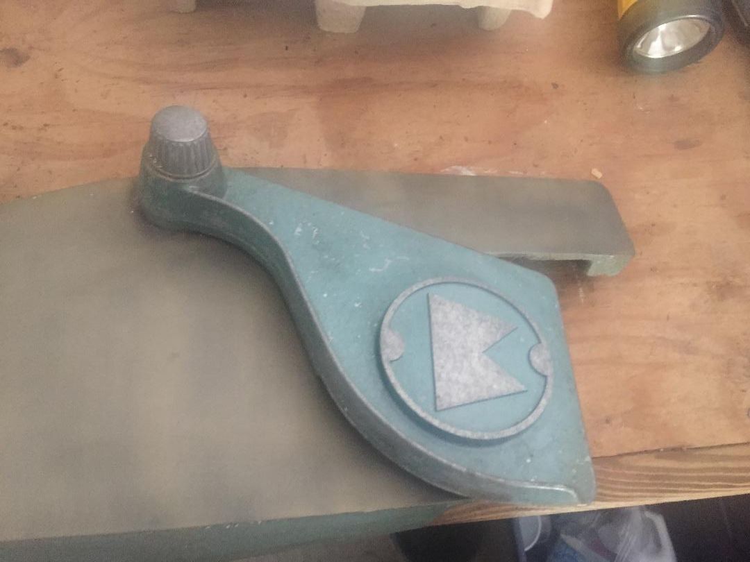

FWIW attaching a pix to a post is the same as to a PM.
So here is what you sent by PM.
greenie jointer guard.jpg (70.78 KiB) Viewed 37984 times
What you have is a Greenie version of the jointer.
The guard has a hex shaped stud that SLIPS into a hex shaped hole in the infeed table.
It is NOT a bolt....
It may be stuck due to corrosion.
Heavy use of penetrating oil and gentle tapping from below should release it.
Something else to check is does the fan shaped guard rotate freely and is the return spring functional?

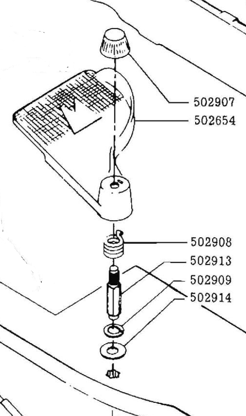

If you need to disassemble the Jointer Cutter Guard start by un-screwing the Knob (502907) from the Stud (520913). The Stud can come out the bottom at this point. The Retaining Washer "snaps" out of the bottom on the Guard Assembly. Use caution when removing it as it is the Retaining Washer that holds the internal parts in place. Once it is out the rest will come out. The Spring (502908) ends go into the hole in the top of the Guard (502654) and into the Torque Washer (502909) hole. This gives the Guard it's tension. After any needed cleaning, repairing, etc. reverse the order to re-assemble. Make sure the Retaining Washer is firmly re-seated in the Guard.
from a 1964 Manual
from a 1964 Manual
Jointer Guard exploded view.png (196.92 KiB) Viewed 37324 times
Part numbers may differ from earlier manuals but the parts are the same on all Jointer Cutter Guards of this style. Some of these parts are still available as replacements on the SS site. The Stud has a replacement kit with a Stud that is threaded on the bottom also to to lock it to the Jointer Table with a washer & nut.
