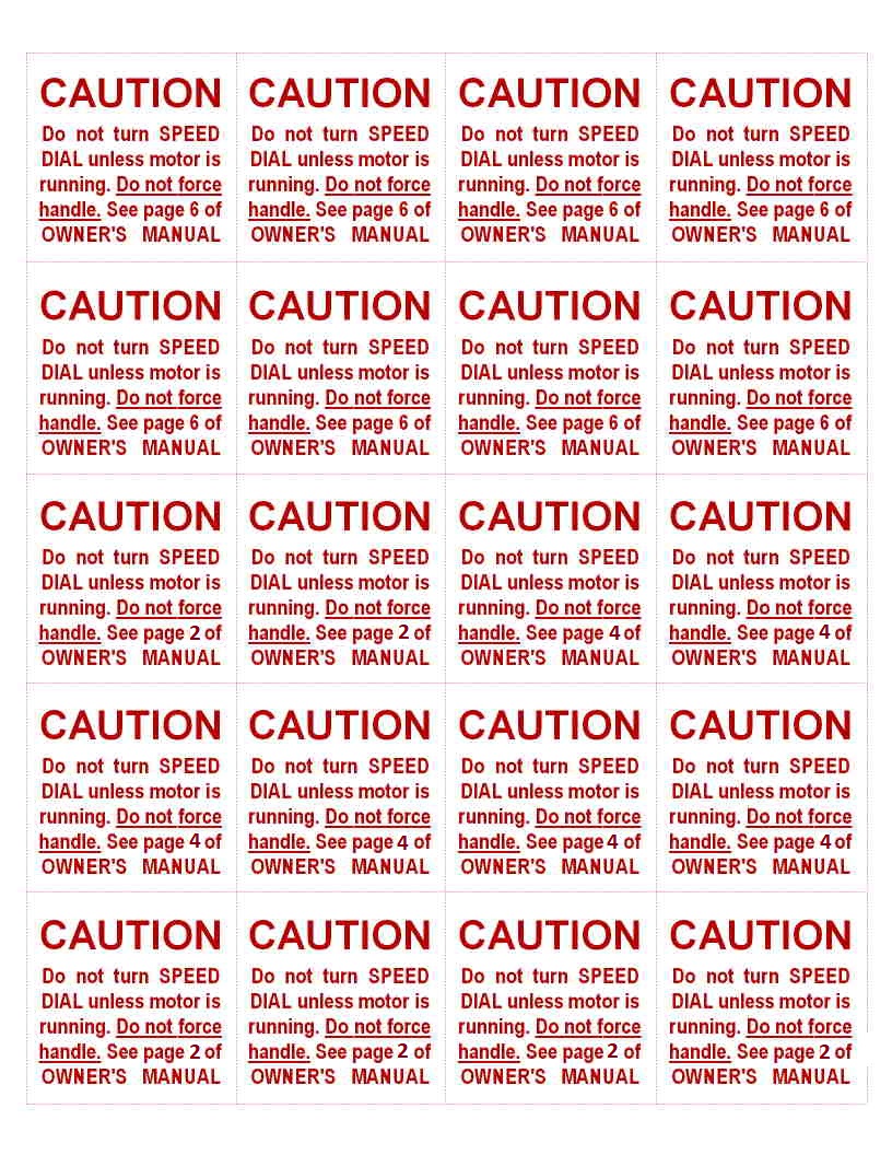

Dennis, JPG and Brenda are all talking about the paint I used on my "Greenie" restoration shown in my previous post. Both paints are hammered finish Rustoleum paint. The Verde Green is the closest I have found to the original color in a hammered finish. To get any closer to the original paint it would have to be custom mixed. The silver hammered finish paint is also very close to the original color although for both "Greenies" I have restored the silver was a little yellowed. That could be just from age. The green paints Shopsmith sells, although nice colors, are not very close to the original and are not a hammered finish. When I purchased the Verde Green paint I ordered it from Home Depot since they did not carry it in the store. You may have to search for it. You can check the Rustoleum website to see if they still list it.
After painting the headstock you will have lost the CAUTION label. The picture below makes a sheet of labels when printed on clear matte finish label material in standard 8-1/2" x 11" size. It should fill the whole sheet like any standard printed page. Note there is reference to page 2, 4 and 6 which depends on which manual version goes with your "Greenie". The CAUTION will be found on one of those three pages so use the correct label for your vintage. I originally made this several years ago to replace the CAUTION labels on the "Greenies" and "Goldie" I have restored. It is an extremely close replica of the original label.
Have fun on your project and keep us posted.
Re: Restoration Project
A PDF of that would be more useful.

James,
I thought you liked the .jpg format.
I know a PDF would be better but this was made in an old Drawing program I had on a previous computer that were in .drw format. I was able to convert it to a .jpg file some time ago. I just tried printing it after using "Save Image As..." and saving it to my computer then printing the picture. It came out correctly.

I loaded it in Inkscape and saved it out as a PDF. It prints out full page but there are artifacts on the background and the letters lost crispness. Maybe Everett can clean it up?JPG wrote:A PDF of that would be more useful.
Mark 5 Caution labels 2 4 6.pdf- (377.25 KiB) Downloaded 1535 times

OK, I printed the .jpg file and then scanned it back in and that cleaned up the background. Ron's and this file are very close. You guys can decide which is the cleanest.
SS Caution0001.pdf- (1.04 MiB) Downloaded 1533 times
