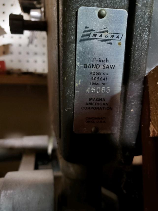

Bandsaw - Magna Brand - 45083

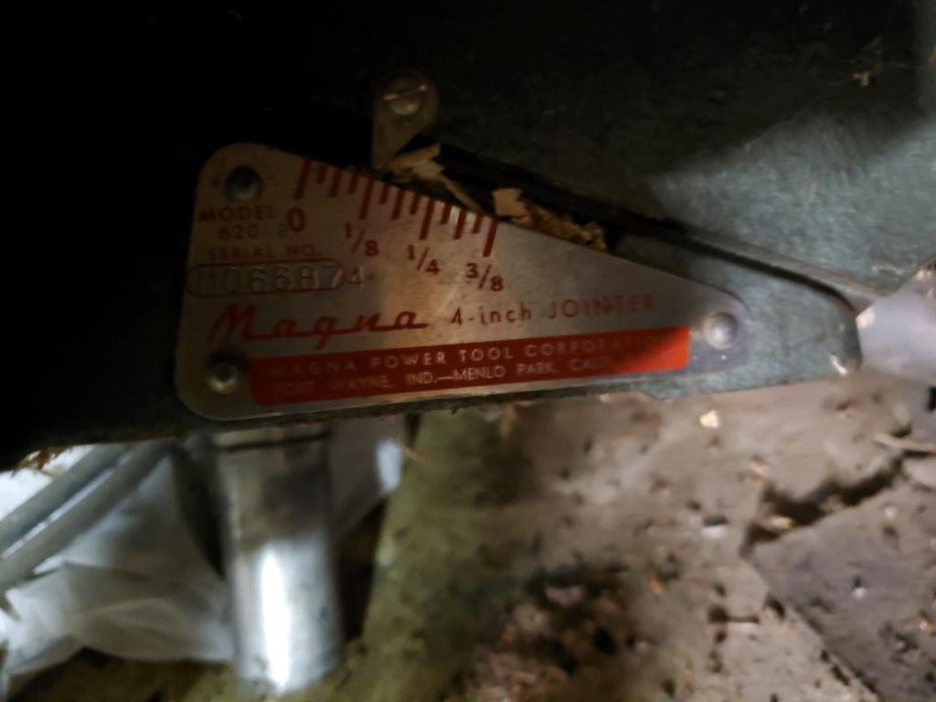

Jointer - Magna Brand - 1066874

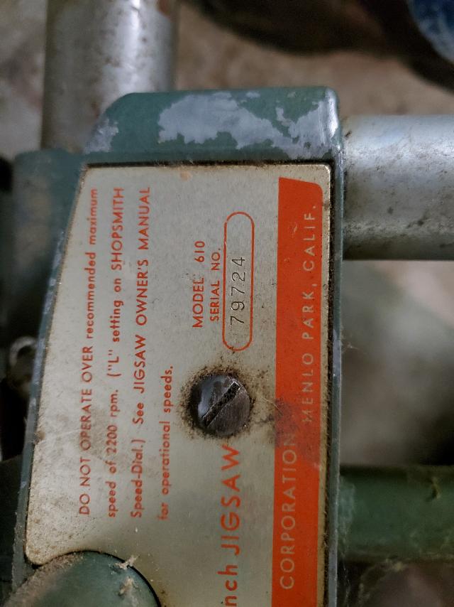

Jigsaw - Magna Brand - 79724
A few pix of the band saw but not many. Just pix of the serial number plates on the others.

The Band Saw was made after June of 1961, the last date before Band Saw numbers are missing (like the Mark 5 list), and guessing it is a Goldie made by Yuba.
None of the Magna/Shopsmith Jointer serial numbers have more than six digits.
The Jig Saw was made in early 1958 and should be a Greenie. Again missing numbers in the chart.
As for parts the Band Saw and Jointer can use current parts as very few changes have been made to these two tools. The biggest difference for the Band Saw is the new table and the Jointer the dust chute and safety features which can be added to these older tools. The Jig Saw is out of production and Shopsmith has very few parts left.

chapmanruss wrote:The Band Saw was made after June of 1961, the last date before Band Saw numbers are missing (like the Mark 5 list), and guessing it is a Goldie made by Yuba.
In the picture of the model plate he sent me it does say Magna American Corporation. Model # 505641
chapmanruss wrote: None of the Magna/Shopsmith Jointer serial numbers have more than six digits.
Looking at the picture of the model plate it says Manga Power Tool Corp. Model 620 and the serial number looks like there could be a 1 at the beginning but if not I can tell for sure the 6 numbers are 066874. Might be an "N" in front of that. Does that help?
chapmanruss wrote:The Jig Saw was made in early 1958 and should be a Greenie. Again missing numbers in the chart.
That's good to know... The jig saw was in the worst shape of any of them. We were talking about sinking money into it but if parts are rare then perhaps we get a newer one.

The Jointer Serial Number is MO66874 made in May 1958. When they changed to Yuba they started adding the MO prefix to the Jointer serial numbers. Yours is the lowest S/N I have seen with the MO prefix and the only one still a Model 620 not a 620-C. It is likely one of the first ones made after Yuba formed. It took some time (as late as 1960) before all the SPT's Label/Serial Number plates changed from Magna PTC to Yube Power Products.
If you buy another Jig Saw make sure it has the parts you are missing for the one you already have. There was only one change made to the Jig Saw over the years, besides paint colors, and that is the table tilt lock. It later changed to a Hex Head Cap Screw and Washer. A word of warning, Do Not run the Jig Saw without adding oil to the housing under the name/serial number plate through the screw plug found there. If you need a replacement gasket for the main housing cover you can make one and I can post a picture of it if you need it.
The Band Saw with the Model Number 505641 makes it made in 1964 or later. Magna American Corporation changed the part numbers to six digit numbers starting in the beginning of 1964. Before that the Band Saw was Model Number 630.

You can get the jigsaw manual from this link.
http://vintagemachinery.org/pubs/detail.aspx?id=10571
The most common part to fail is the yoke, which is made of plastic.
There is someone on ebay who is 3d printing them, or you can make one. :)
