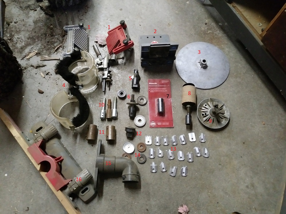

Picture is posted, thanks!
Re: Mark VII on loan
Posted: Tue Oct 15, 2019 10:17 am
by rpd
Top row - 2 feather boards; Tenon Master Jig; sanding disk
2nd row - dust shield; ? (not SS); Shaper arbor with cutter.
3rd row - dust shield; 4 universal arbors and 3 washers; Router Chuck, drum sander; control sheave.
4th row - 2 (drawing a blank at the moment); SS saw arbor
5th row - Shaper fence; dust collector fitting for planer; 5 washers for the universal arbors; blades for the Molder Head
Posted: Tue Oct 15, 2019 10:33 am
by ceyoung77
Good to know, thanks so much!
Posted: Tue Oct 15, 2019 11:58 am
by beeg
rpd wrote:2nd row - dust shield; ? (not SS)
I think those are a router shield. But they are missing the piece that makes it attach to the quill shaft.
https://www.shopsmith.com/ownersite/cat ... shield.htm
Posted: Tue Oct 15, 2019 12:02 pm
by rpd
The question mark was for the next item, Some type of non SS jig, possibly for sharpening drill bits, or drilling dowel holes.
Posted: Tue Oct 15, 2019 1:11 pm
by chapmanruss
Ron has given you a pretty good listing of what you have in the picture. In the picture below I have labeled the items to better describe them for you. Some of the items shown are not Shopsmith parts, ie. the item not numbered between the Shaper/Router Shield #4 and the Feather Board #1.
ceyoung77 Mark VII parts.jpg (244.7 KiB) Viewed 29226 times
#1 Feather Boards, grey regular and red has the Quill attachment.
#2 Tenon Master Jig.
#3 10" Sanding Disk - one side is flat the other side is Conical (mounting side).
#4 Shaper/Router Shields - top one appears to have the Quill attachment, the bottom one has no attachment parts.
#5 1/2" Shaper Arbor P/N 555117 or the previous 1/2" Universal Arbor 505505 version 2 with a shaper cutter and rub collar installed.
#6 1/2" Universal Arbor P/N 505505 version 1 which would also have a machined spacer and 2 machined washers (possibly #14).
#7 1/2" Router Chuck still in package.
#8 A sanding drum but not a Shopsmith one.
#9 The Control Sheave with the Control Follower from the Idler Shaft Assembly.
#10 Looks like 3 misc arbors not Shopsmith for those having 2 set screws.
#11 Unknown Parts
#12 Saw Blade Arbor P/N 505511 version 1.
#13 Moulding Knives - if Shopsmith brand made before September 2011 they are used in sets of 3 knives on Molder Head P/N 505553 or earlier. If made after they use the current Molder Head P/N 556213.
#14 Machined Washers - if 1/2" hole they go to Arbor P/N 505505, if 5/8" hole they go to Arbor P/N 505506.
#15 Is the Drum Sander/Shaper Vacuum Attachment which attaches to the bottom of the Table Inserts.
#16 Is the Drum Sander/Shaper Fence for the Mark V Models 510, 505, 520 & new Mark 7 with the larger Table System. This is not the Sander/Shaper Fence for the Mark VII made in the 1960's or the Mark 5 and Mark V 500 with the original Table System. On the Mark VII Sander/Shaper Fence the mounting holes are between the adjustment controls and it is specific to the Mark VII.
For your reference a PDF of the Manual for the Mark VII Shaper Fence is below.
505508 502673 03-64 Magna Mark VII Shaper Fence.pdf
(967.03 KiB) Downloaded 2240 times
Some of the items are newer than the 1960's when the Mark VII was made. It is common for non-Shopsmith parts to get mixed in with Shopsmith tools over the years.
Bob and Ron were posting while I was putting this information together today.
