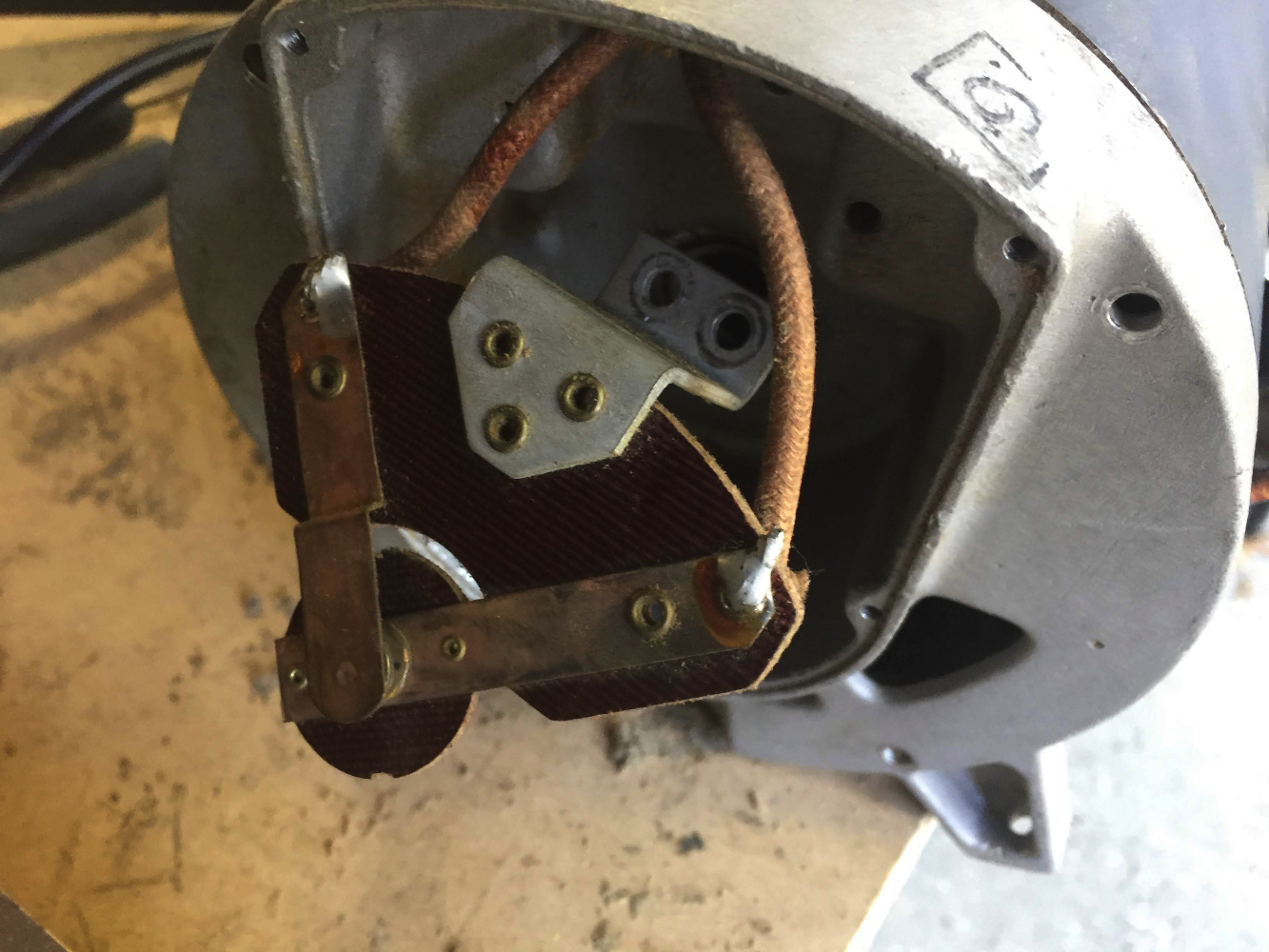

As you can see from this picture, my centrifugal switch, as well as the spinning brass part beneath it are quite different from the pictures in the AO Smith 1 1/8 HP thread. On my motor, the connecting wires are soldered on, so I'm going to have to remove that to get to the back bearing. Since I hope to switch out all the old brittle wires anyway, is there a replacement part that I should consider here with detachable wires to make any future work easier???
The spinning piece has a single spring, vs. the two springs in the later motor, but it came off the same way revealing the flat head screw. So that part came off without any issue at all.

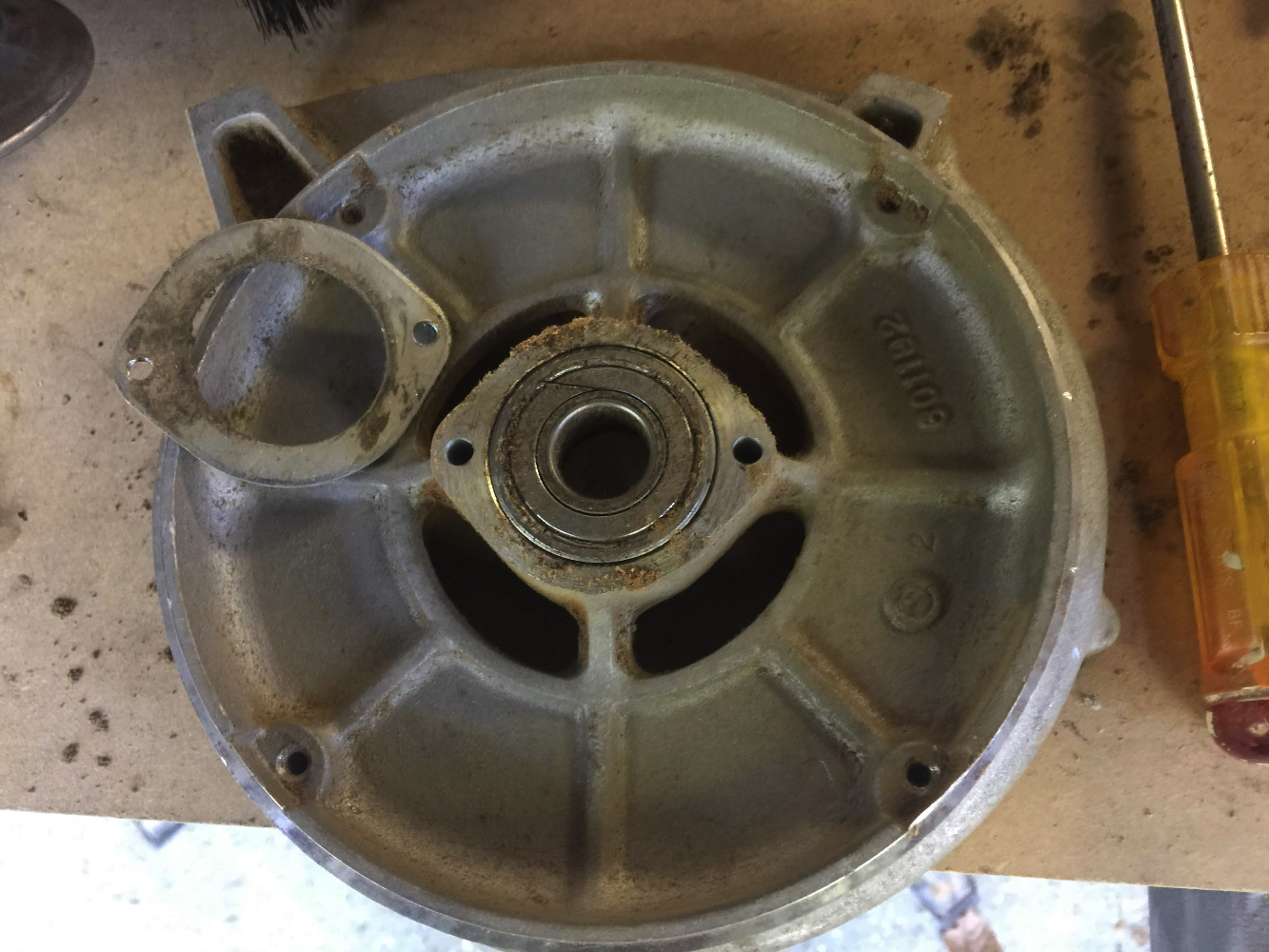

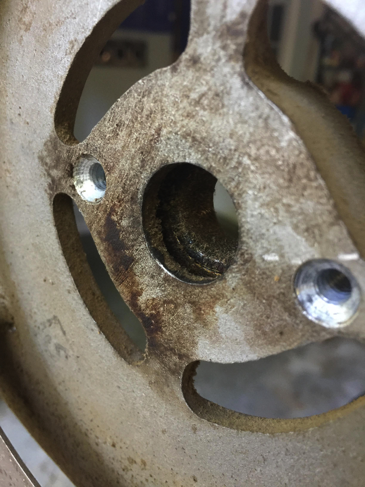

Now back to the front, the cover now comes off and the bearing is held in the cover by a small plate. The plate came off by removing the two small screws to reveal the bearing.
But there is no obvious way to use a traditional tool to remove this bearing. All I could find was a small space where I could push the bearing out with a flat head screwdriver. Not ideal perhaps, but it worked.
Unfortunately, it damaged the bearing, but not to the point that I couldn't read what it said.
@everettdavis, here are the particulars that I've collected so far using my calipers. Am I missing anything?
  • Text on both sides of the bearing: HOOVER 77203 MADE IN U.S.A.
  • Diameter D = 40.01mm
  • Bore d = 16.87mm (0.663") (Not sure what to make of the non-standard size.
  • Width W = 11.98mm
  • Shaft = 5/8" (0.626"/15.91mm)
So then. I need a bearing where D is 40 mm and W is 12 mm. But what should "d" be? Would I select 16 mm, as it is slightly above the shaft size, but less than the current (very worn) bushing, or should I ask for a "d" of 5/8"?
Thanks, guys! I'm making progress one baby step at a time. I couldn't have made it this far without your help.

Look at the armature shaft. I think yours is .625 without any variation in the area the bearing goes.
So I think 5/8 "d" is appropriate. So 40 x 12 x5/8" .
Check the rear bearing shaft size the same way.
I would just replace the wires the way they are instead of trying to put something in there that may or may not fit well to make the wires detachable. Look at it this way, it has lasted almost 65 years so far and with the work you are doing the next time something needs to be done to the motor may be another 65 years or a motor rebuild/replacement.

The tool you can use (opposed to knocking it out with a Screwdriver) is a Blind Hole Pilot Bearing Puller. In a bind hole, you could not get to the back side of the bearing. Some models of some motors have blind bearings.
I just borrowed one from an auto parts store last time I needed one.
The adapter goes inside the bearing then expands on the back side. The slide hammer then evenly pulls the bearing out of the housing.
Everett
