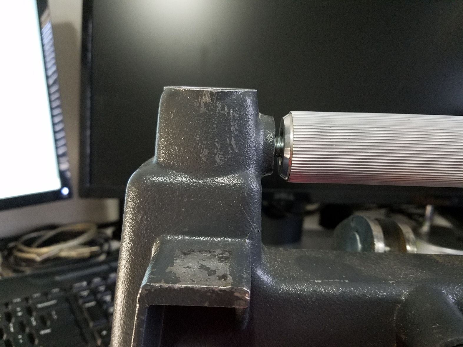

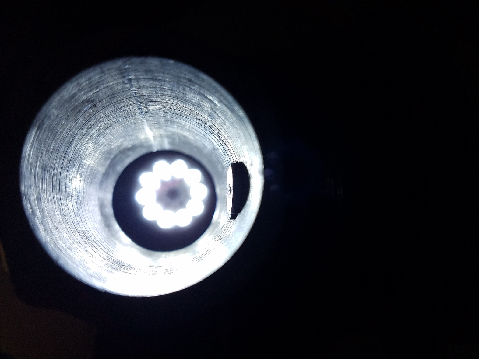

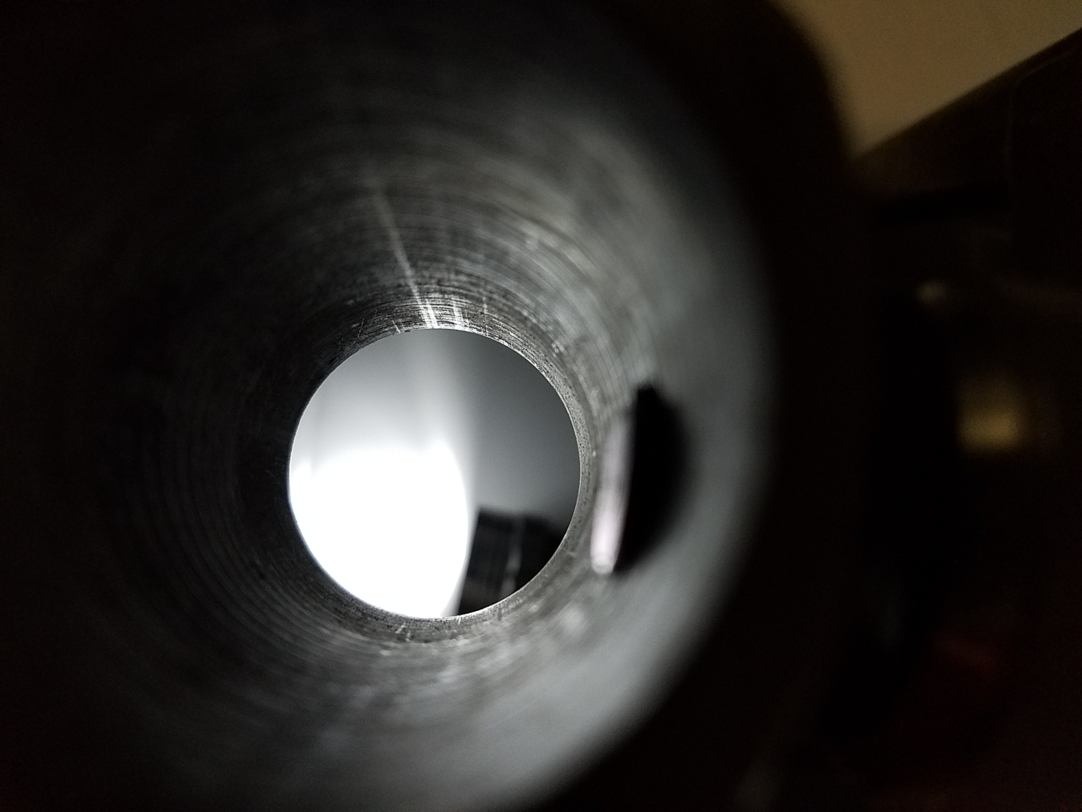

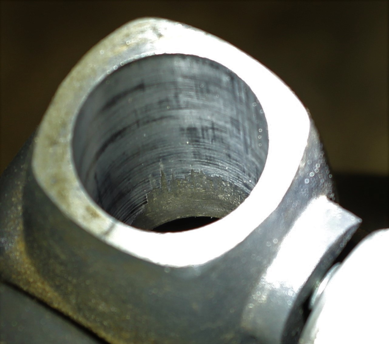

Here is the closeup of the inside the mounting tube that I referred to earlier. While this seems severe, it is relatively deep inside the hole. Too far down, I think, to have been caused by poor clamping of SPTs unless the original owner had older SPT mounts that extend farther down. Also doesn't look like you'd expect. Top of the damaged area is down ~1.7 inches from the top of the mounting hole.
Headrest Front Mounting Hole
IMG_7930 (2).JPG (194.52 KiB) Viewed 13749 times

From that photo, it looks to me as if the bottom of the hole is still rough casting, never touched by the boring tool. That could certainly explain some wobble. It may be that the rough casting was misaligned for machining, causing both the incomplete boring and the mismatched clamp-hole bosses that you reported in this thread.
If so, it may qualify for free replacement under Shopsmith’s lifetime manufacturing-defect warranty.

I'm sorry but I am still a doubter. I doubt that the condition of that bore is the cause of your wobble.
When the legs are locked the studs that secure them in the bores should be equally extended (into the bore). This caused equal locking pressure on the two legs. Have you checked that?
The images prove nothing. They serve only to guide the discussion. Note though that these bores are not pristine.
