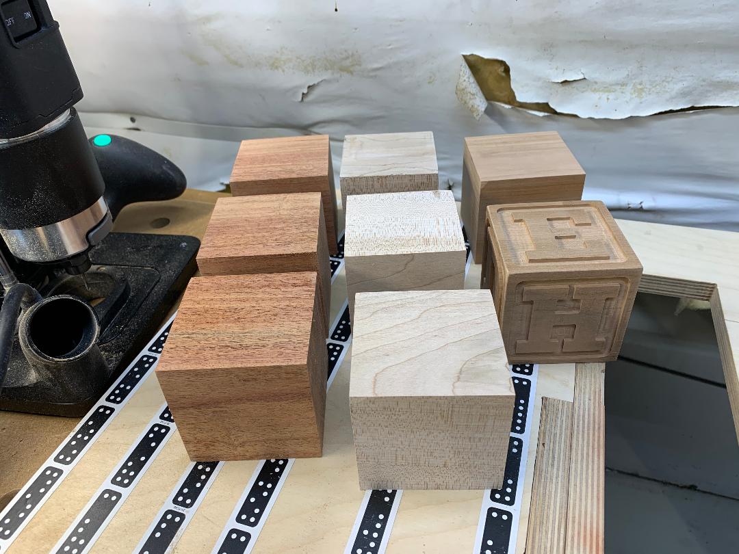

I just used my conical disk to finish these blocks:
The one with the letters was done by hand and was a prototype but with that many to do it was easier to do some power sanding.
I cut them just a little over sized then sanded all 6 sides so they are all uniform and sanded. I think the fine paper for these is 150 grit, anyway I forgot to write the grit on the disk but it is the fine paper.
