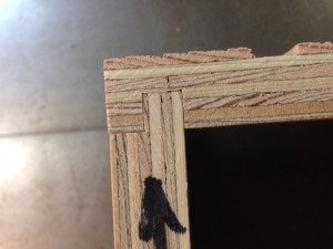

For joining sheet goods, I'm a big fan of "rabbet and dado" joints (aka “tongue & dado” and “locking rabbet”). For me, making them is generally faster than drilling a bunch of pocket holes and then driving screws. But what I really like about rabbet and dado joints is that they make the components self-jigging for assembly. No futzing around trying to keep the edges aligned while driving screws. I just apply the glue, mate the parts, pop in a few pin nails to hold them while the glue dries, and move on.
Rabbet & dado.jpg (13.54 KiB) Viewed 12672 times
In plywood, about half of the glue surface is long-grain to long-grain, giving a good strong bond. More info and instructions for making the joint can be found at https://www.aconcordcarpenter.com/tongu ... joint.html.

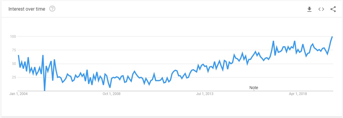

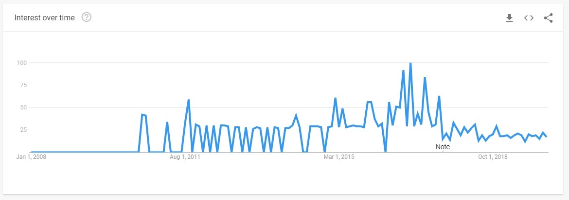

It seems like certain things in woodworking follow fads/trends like everything else in society. I wonder if this rediscovery of pocket screws in the general woodworking community is part of that (fueled by manufacturers wanting to sell tools and pushing said tools on social media). Will pocket screws go out of style again in a few years? I mean, I know biscuit joinery definitely peaked in the '90s I think due to Norm evangelizing it on the New Yankee Workshop. Epoxy filled tables, aka river tables, peaked on Youtube about a year ago and hopefully are going out of style now. Hand tool joinery, e.g. handcut dovetails, making everything with saws, planes and chisels seems to be going through some kind of resurgence. In fact, I stopped going to my local woodworking group meetings because they tended to shun those of us that still use power tools to make woodworking. I am neither pro nor con on pocket screws, but I do find them interesting and will likely try them out someday...just wondering where in the trend I am at. It seems like this new trend on pocket screws started around about 2011 (if Google Analytics can be trusted - 😂). By the time I get around to it, they may be out of style again!!!
[youtube]https://www.youtube.com/watch?v=6cAUz_eCmbw[/youtube]
[youtube]https://www.youtube.com/watch?v=Ahb9RUf6wtg[/youtube]
Pocket Screws Trend on Google:
Pocket Screws Trend on YouTube:
