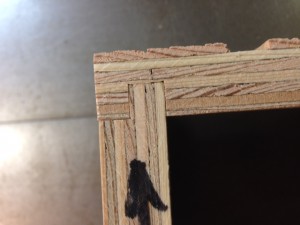

For joining sheet goods, I'm a big fan of "rabbet and dado" joints (aka “tongue & dado” and “locking rabbet”). For me, making them is generally faster than drilling a bunch of pocket holes and then driving screws. But what I really like about rabbet and dado joints is that they make the components self-jigging for assembly. No futzing around trying to keep the edges aligned while driving screws. I just apply the glue, mate the parts, pop in a few pin nails to hold them while the glue dries, and move on.
- Rabbet & dado.jpg (13.54 KiB) Viewed 12688 times
In plywood, about half of the glue surface is long-grain to long-grain, giving a good strong bond. More info and instructions for making the joint can be found at

Hey brother! That is my goto and favorite joint for a lot of things. I agree, lots of holding power with glue, Ron just amazed me with the speed and strength of a carcass we built in my shop. Still kind of reeling from the experience LOL.

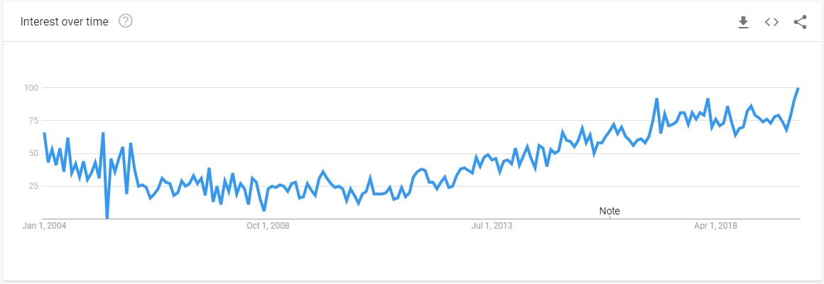

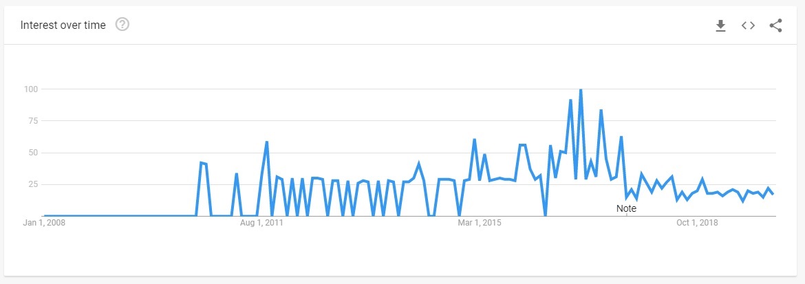

Thanks Ed. Matthias' testing is definitely interesting. Just scanning YouTube, there really isn't a lot of joint testing that I can find for pocket screws (lots of videos though on wood glue strength testing). I found these couple of videos helpful. Both seem to use more pocket screws than Mathias for his small joint tests. Without professional equipment to do this testing, I think all of them did a decent job of capturing the performance of the various joint strengths. In summary, pocket screws seem to be about half as strong as M&T joints. So, if absolute strength is needed M&T is a clear winner, but the real question is how much strength is needed for a given application? Also, for cabinet carcasses, noone is going to do M&T joinery (unless they own a Festool Domino), but I wonder how pocket screws compare in joint strength to the rabbet and dado approach like BuckeyeDennis uses? I would have to think the rabbet and dado approach would win out for sure. Pocket screws do appear to be a good bit stronger than biscuits based on the testing in this one video and in the other video they were strong enough to hold a car on a ramp. Granted that was one beefy ramp they built AND a lot of pocket screw joints, but it still held. Bottomline, I think for pocket screws it comes down to speed of making the joint versus joint strength. You are giving up a bit of strength for a much faster execution, but that may be acceptable for a given application.
It seems like certain things in woodworking follow fads/trends like everything else in society. I wonder if this rediscovery of pocket screws in the general woodworking community is part of that (fueled by manufacturers wanting to sell tools and pushing said tools on social media). Will pocket screws go out of style again in a few years? I mean, I know biscuit joinery definitely peaked in the '90s I think due to Norm evangelizing it on the New Yankee Workshop. Epoxy filled tables, aka river tables, peaked on Youtube about a year ago and hopefully are going out of style now. Hand tool joinery, e.g. handcut dovetails, making everything with saws, planes and chisels seems to be going through some kind of resurgence. In fact, I stopped going to my local woodworking group meetings because they tended to shun those of us that still use power tools to make woodworking. I am neither pro nor con on pocket screws, but I do find them interesting and will likely try them out someday...just wondering where in the trend I am at. It seems like this new trend on pocket screws started around about 2011 (if Google Analytics can be trusted -
). By the time I get around to it, they may be out of style again!!!
[youtube]
https://www.youtube.com/watch?v=6cAUz_eCmbw[/youtube]
[youtube]
https://www.youtube.com/watch?v=Ahb9RUf6wtg[/youtube]
Pocket Screws Trend on Google:

Pocket Screws Trend on YouTube:
- YouTubePocketScrews.jpg (56.64 KiB) Viewed 12589 times
