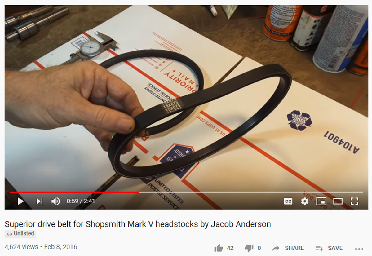

I looked at one of the free videos Jacob Anderson offers about belts. In it, he shows the belt he uses and sells, and the markings read 15 x 675. He says it is .6" wide. 15mm converts to .59" and 675mm converts to 26.57"
- drive belt sold by Jacob Anderson.jpg (161.15 KiB) Viewed 5824 times

That is close to SS OEM dimensions. A bit wider and a smidge longer.
That 'should" result in a small shift in range.
I would perform the high speed adjustment with the motor belt at or very slightly inside the motor pulley periphery.
Belt wear will move the belt into the pulley(both). That wear will move towards the oem dimensions(new).
