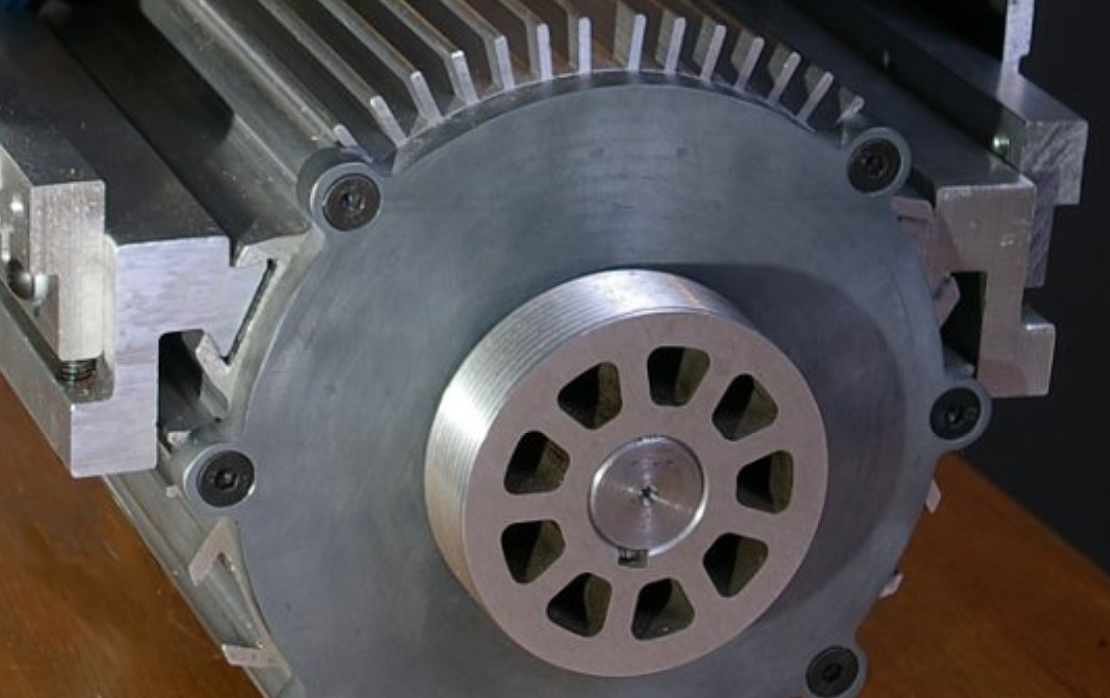

Due Diligence: Be careful with this. The motor may be the same while the mounting mechanism may no be.
Power Pro Motor Mounts and Drive Pulley
Power Pro Motor Mounts.PNG (1.29 MiB) Viewed 8044 times
If you're replacing a broken motor then the original mounting blocks might fit the new motor. If you're lucky.
