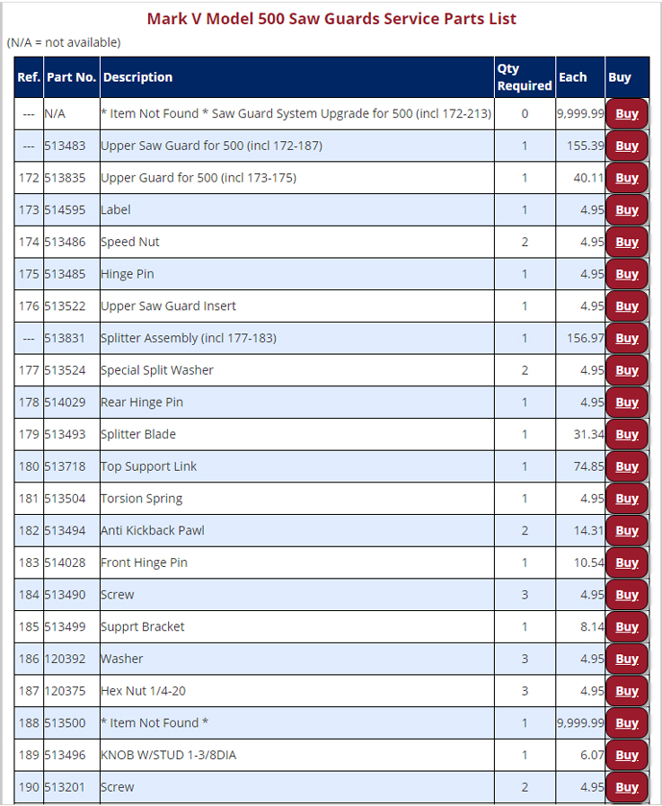

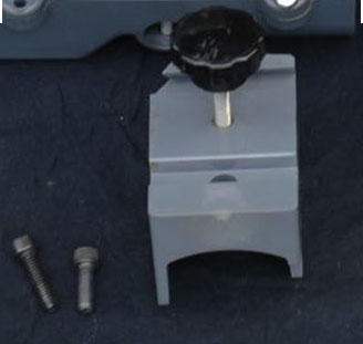

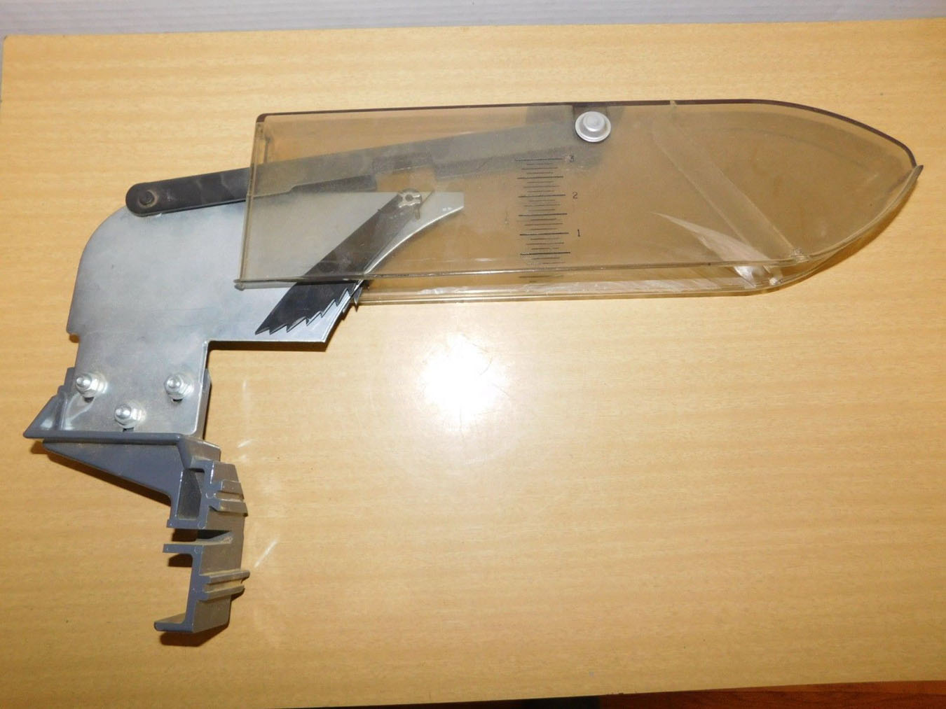

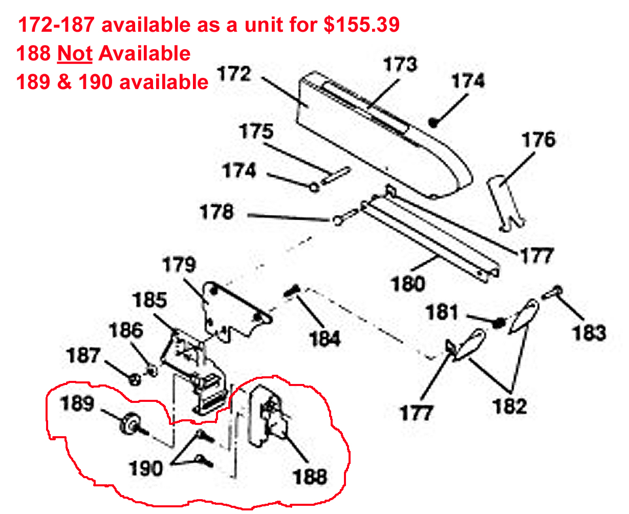

A clear upper guard used to be available from Shopsmith (513483), but I don't see it listed. However, if you type in the part number, it will show a price ($155.39) and let you add it to your cart. It apparently does not include a mounting bracket (not shown in first picture below) that has to be mounted to the table support structure (2 holes need to be drilled and tapped). The clear upper guard can be used with the older cast aluminum lower guard, or with a newer plastic/metal lower guard. There is more than one version of the newer lower guard. And only guards for a 500 or 5 or V will work (not one for a 505/510/520/7)
Clear upper guards do occasionally come up on ebay, which is how I got mine (for $35 plus shipping). When looking, be sure it includes the mounting bracket.
EDIT 4/26/2020: Upon further review, the mounting block is apparently not available from Shopsmith as a service part, as it shows it as "Item Not Found" and shows price as $9,999.99, typical for items not available.

- 500 upper guard upgrade.jpg (139.63 KiB) Viewed 12472 times
- Mounting Block Front.jpg (24.33 KiB) Viewed 12470 times
- Mounting Block Back.jpg (24.31 KiB) Viewed 12470 times
- 500 Upper Saw Guard Parts Diagram Anotated.jpg (471.57 KiB) Viewed 12317 times
- 500 Upper Saw Guard Parts List.jpg (450.39 KiB) Viewed 12317 times

That Upper Saw Guard is part of Saw Guard system part number 505875. The upper guard, along with all the parts to this saw guard system, are still listed in the service parts section. The upper guard can be purchased as a complete unit with a couple additional parts needed. It is P/N 513483 and sells for $155.39. You will also need P/N 513496 Knob w/stud for $6.07 and 2 screws P/N 513201 for $4.95 each. The screws could be purchased locally if someone has the information on the proper size for you. I do not know what size they are as I do not currently have a Mark V with that guard system. Because this upper guard mounts to the table post and not the lower guard it can be used with your current lower guard. Adding this upper guard to your Mark 5 will require drilling holes for the mounting block on the rear table post. If your extra main table, the one without the second slot, has the trunnion, tie bar, posts, etc., it may already have those mounting holes. I could not tell for sure from the pictures if it does.
If you look for it used do make sure it comes with all the parts as shown in the parts diagram/list in the service parts section. The picture below shows the complete 505875 guard assembly.

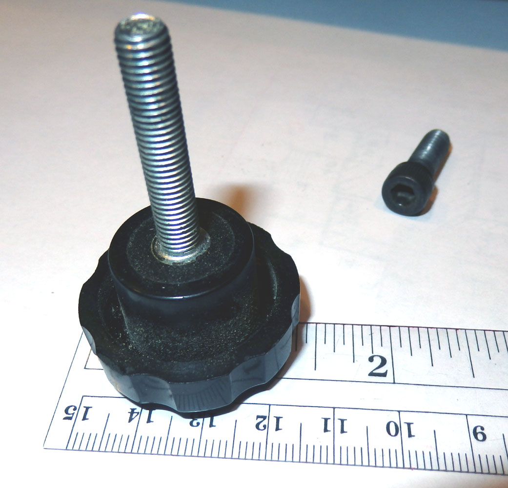

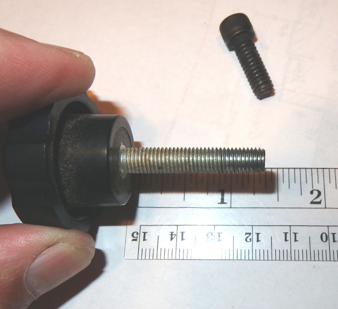

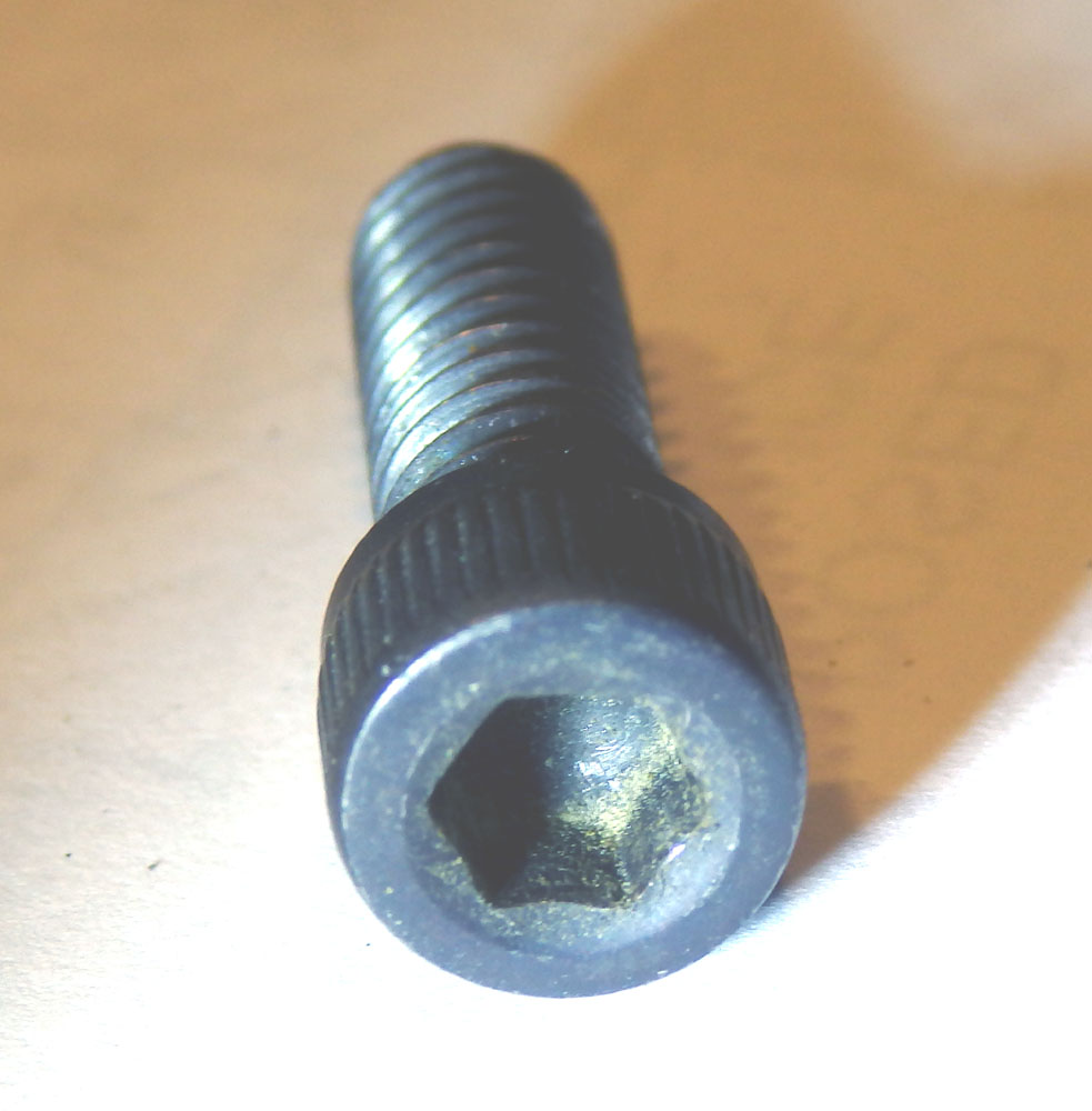

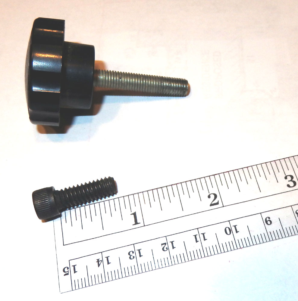

Here are some instructions I found in a previous thread about same topic. Note that the instructions are for both the upgraded LOWER and the UPPER guard ... the original lower guard does not need to be replaced to use the upgraded upper guard.
Drilling and tapping holes is not something I have done often, but with patience and the right tools it is not difficult.
Two (2) 3/4" x 1/4-20 screws required. Not sure of correct designation for this type of head ... socket screw perhaps? Uses 3/16" allen wrench to install.
The knob has about 1-3/8" x 1/4-28 (fine thread) stud. Black knob is about 1-3/8" diameter.

- P8140090.JPG (133.91 KiB) Viewed 5156 times
- P8140091.JPG (148.9 KiB) Viewed 5156 times
- P8140094.JPG (158.78 KiB) Viewed 5156 times
- P8140097.JPG (108.97 KiB) Viewed 5156 times
