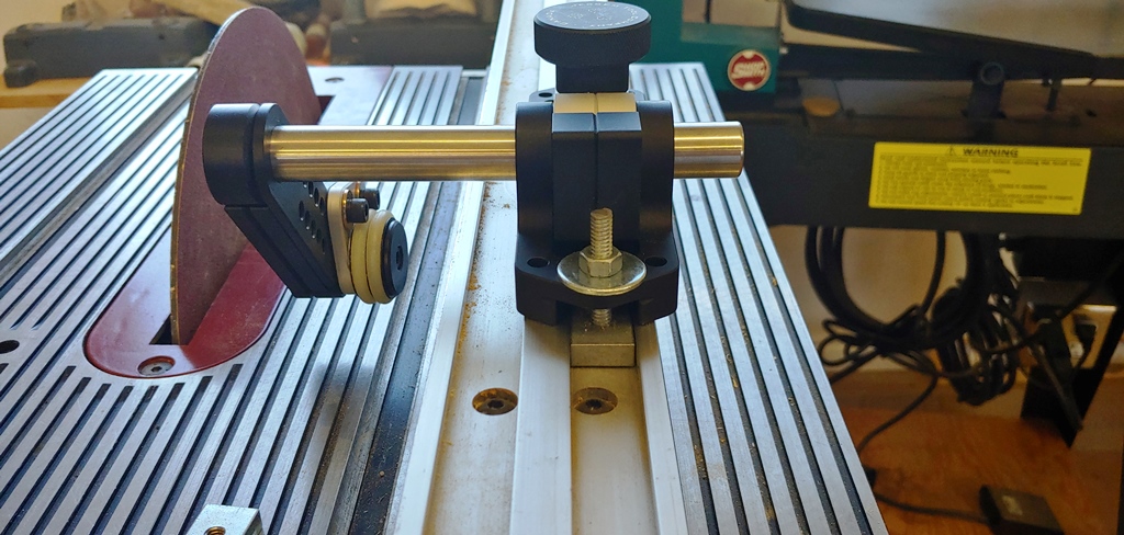

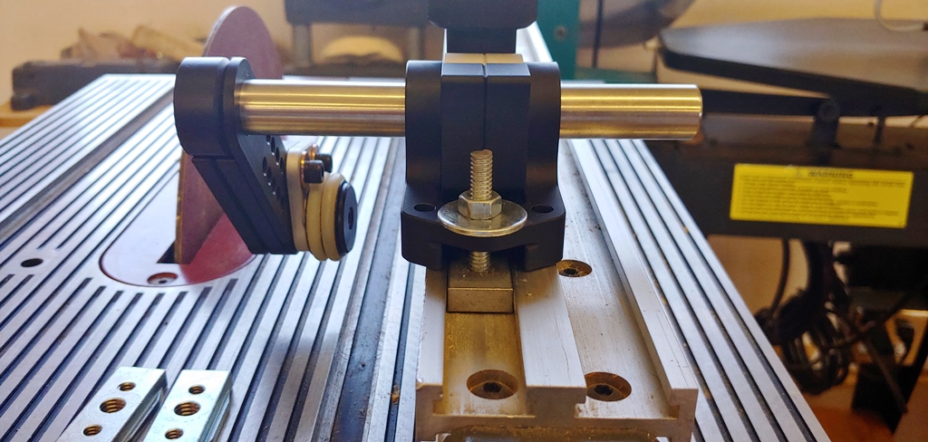

I had to go back and look at my "solution" on the other thread to see what I had to say.
I personally like the flat rather then tilted mounting. When I first put this together I didn't have the washers and I looked for very simple solution to get it operational ie flat. The washer idea is a common solution in that most people have some laying around the shop.
The reason I have only two t-nuts is due to the nuts I had to use. They don't fit the countersinks so a mid location then takes some of the flexibility out of mounting locations of the arms. I've thought about looking for better fasteners but I still haven't done that. With the correct fasteners there is no reason not to add a third t-nut.
I wouldn't be surprised if the whole shopsmith could be lifted off this mounting. I have no fear about any kickback being a problem with this. It is very rare I have even seen kickback and with this and other systems I employ now at this stage of my woodworking experience I don't think I will ever see any again.

I finally got my Jessem TS Guides and they mount fine on the 520 fence just as Mike showed. To The Jessem T track can stay on the Powermatic TS and the guides can easily be mounted on the 520 fence by themselves if needed.jsburger wrote:Thanks for the link. I was wondering if the guides them selves could be mounted to the 520 fence without the JessEm track that will be mounted permanently to my PM2000 table saw fence.RFGuy wrote:John,jsburger wrote:I have a set of these on my router table and they are absolutely great.
https://jessemtoolcompanycanada.myshopi ... cohy9d2rci
JessEm has the table saw product on sale for Fathers Day.
Have any of you adapted them to the SS 520 fence? They will live on my Powermatic 2000 cabinet saw most of the time. I am wondering if the guides them selves are easily adaptable to the 520 fence with the SS T nuts. It looks like they would without the JessEm T track. Just SS T nuts and probably replacement knobs. The only issue would be the hole size in the guide body for the T nuts.
If you mean the table saw version, it was discussed already here:
https://www.shopsmith.com/ss_forum/wood ... 22171.html
It seems like that is possible based on the response by Mike in this post. #255878 by Mike907 in your quoted thread above.
I guess I could also buy an additional T track from JessEm for the SS.
