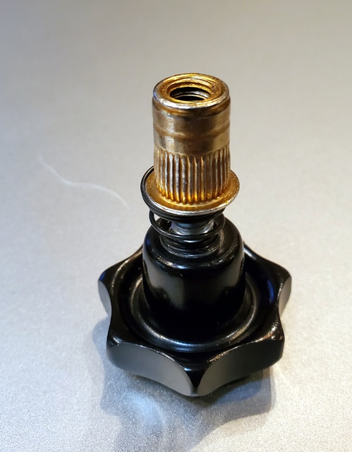

Today I began setting up the fence on the new 520 upgrade. Sadly, one of the screws that hold the alignment tube in the front rail pulled the threaded insert from the rail. i contacted customer service and they suggested I contact engineering. I don't think this should be a problem since this was a first use failure. Attached is a photo of the screw after it pulled out of the rail. Anyone else have this problem and is there an easy fix?

Are all the others straight like that one? Looks like a pop rivit to me that has not yet been popped.friscomike wrote:Howdy,
Fingers crossed,
Mike C
If not the hole is likely oversized.
Regardless, CS should take the lead here.

It is a threaded sleeve that was pressed into a hole in the rail. It simply pulled out. I suspect it was installed with some rivet tool.

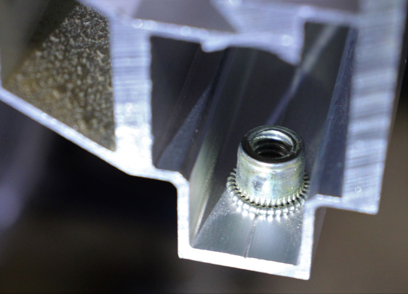

I agree with JPG, it looks like a rivet nut. Probably was stuck in the hole and then never clinched. Here’s an example of a system like that at Northern Tool.
Re: Installed 520 upgrade...tips?
I would check them all before calling engineering. I don't see a resolution other than replacing the bad rail(s). This is what it should look like, in case the others are the same:
Not my tip!
-David
Just a pic in case you didn't know what they should look like. (I didn't)JPG wrote: Are all the others straight like that one? Looks like a pop rivit to me that has not yet been popped.
