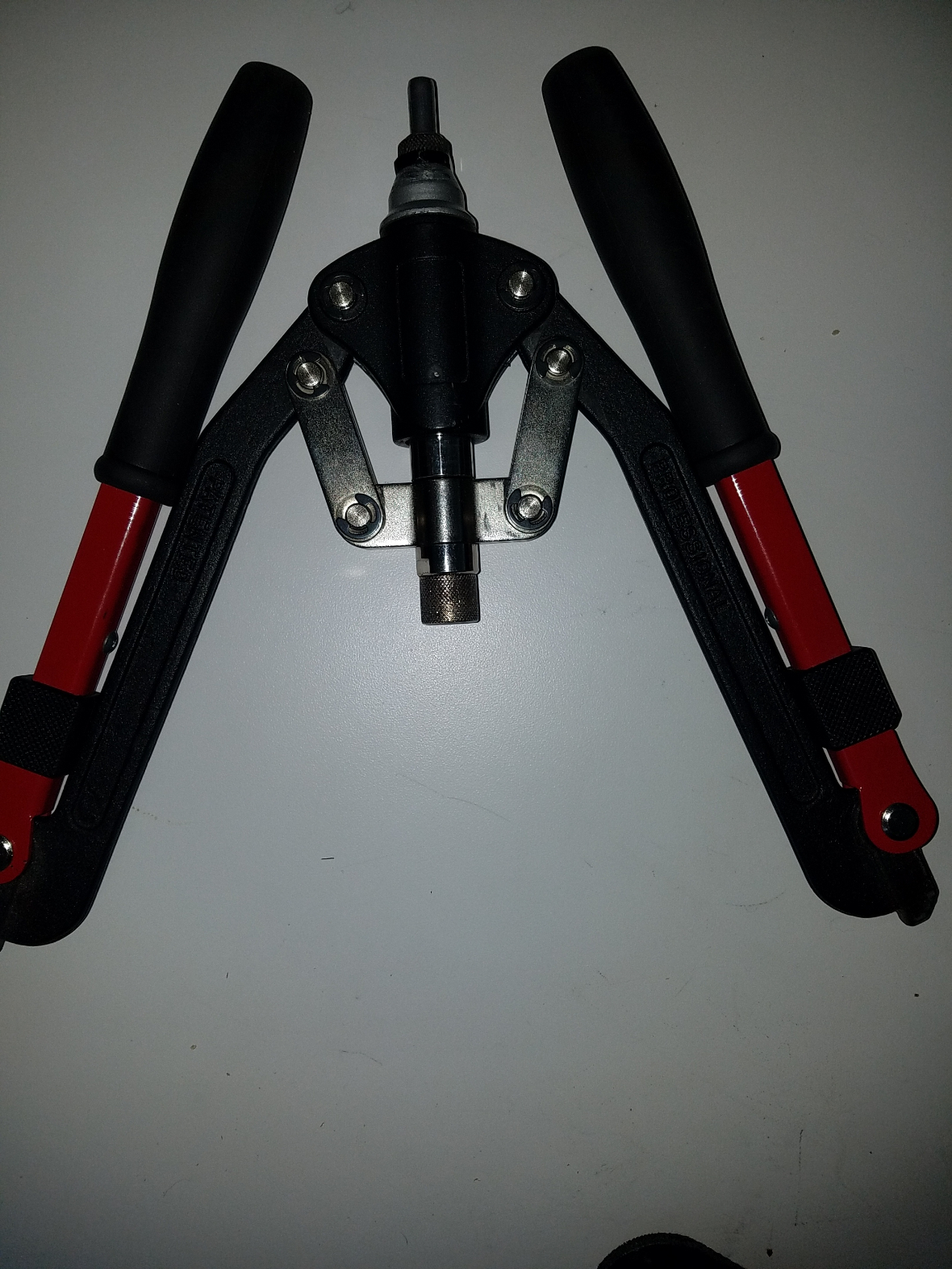

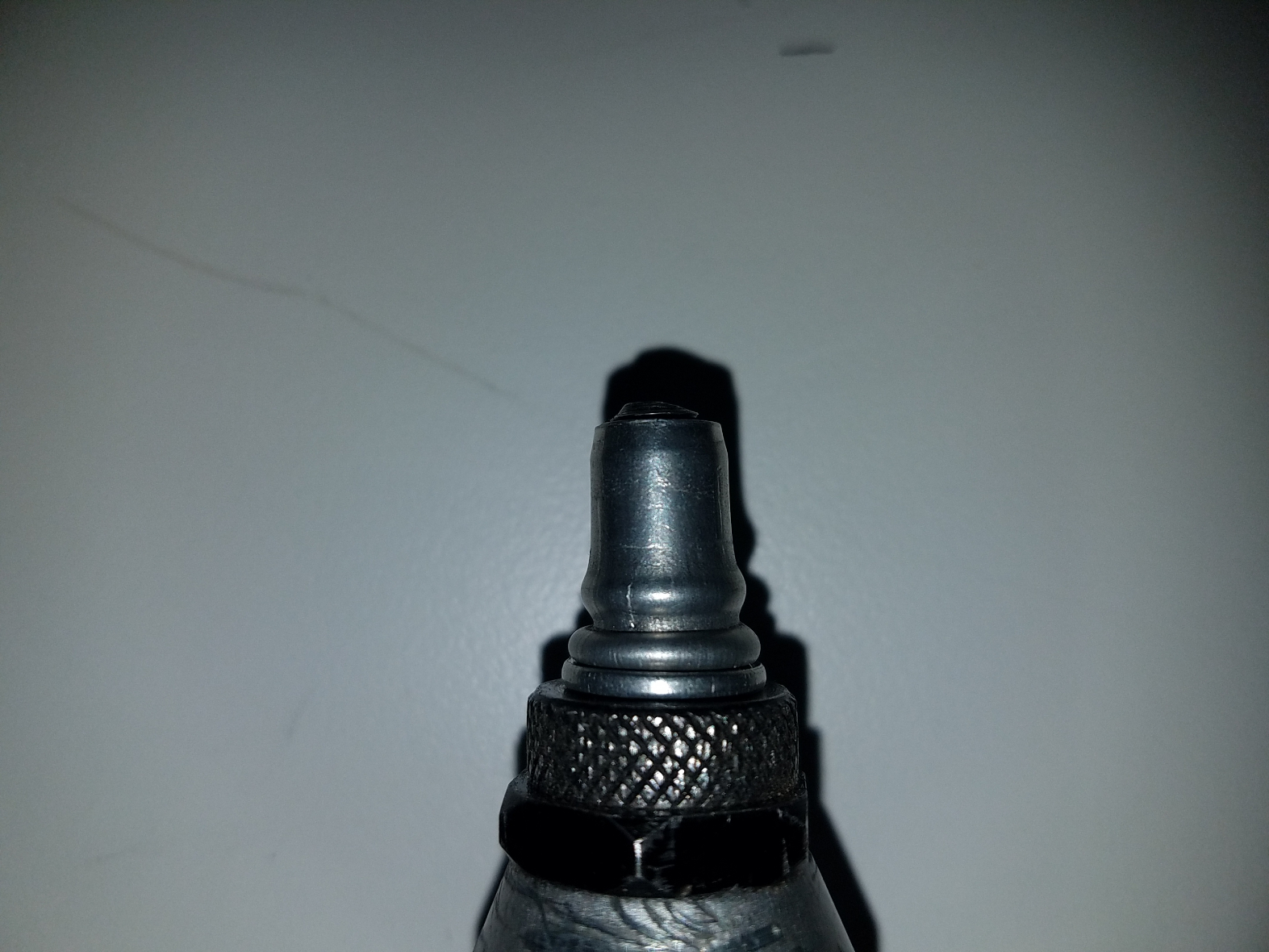

Insert Attached to the Tool
Insert and Tool Ready to Expand
Fully Expanded Insert
The Tool
The Tool
You are correct in that the insert is threaded (inside thread) on only the tip end. How deep depemds on the size of the insert (threaded nut). It works as you described. When the appropriate pressure is applied the body of the insert expands created a pressure fit of the insert into a properly sized hole. My question is "by what means are you going to apply that drawing pressure with out having a tool designed to do that"?

dusty wrote:You are correct in that the insert is threaded (inside thread) on only the tip end. How deep depemds on the size of the insert (threaded nut). It works as you described. When the appropriate pressure is applied the body of the insert expands created a pressure fit of the insert into a properly sized hole. My question is "by what means are you going to apply that drawing pressure with out having a tool designed to do that"?
If only the inner half is threaded, a simple bolt will pull that half toward the outer half using the head of the bolt against the outside. That way any bolt that fits the threads can do the job with no tool needed. This would be all the tool you need to tighten it and crush it.
Think of it like the Greenlee chassis punches. Only the piece on the far side has threads. The part on the front side has a simple hole that the bolt slides through. The bolt head pulls against the inner piece as it is tightened.
Once again, I need to have the part in my hand to see how it is made, but if it is like I described, the task is a very simple one.
