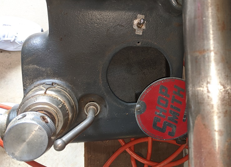

As for the hole behind the Logo/Serial Number Plate the later manuals refer to it for access to the switch. This is something I talked about in my Shopsmith Model 10's What When and Where thread. Later Model 10ER's had the version 7 Headstock with that hole and the Plate was held in place, most commonly, by pin at the top and a screw at the bottom. edma194 if you remove one or both of the screws you can rotate or remove the plate to expose the hole. If your Headstock doesn't have a hole behind the plate it is a version 6 Headstock and someone likely replaced the pins that held the plate on with screws. Without actually seeing that the hole is there it is hard to tell if one is a version 6 or 7 Headstock.

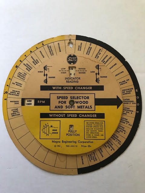

Here's something else that came with the 10ER, a Speed Selector 'Computer'.

I have some of those. It is basically the Speed Chart in the PDF attached below in a different format.

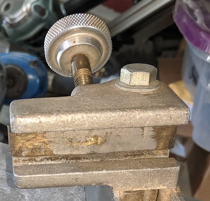

Grabbed a picture of the headstock and fence for you. I assume that is the access hole behind the nameplate. It was attached with two screws. Not sure what you mean with the fence though, is it something showing in that picture? Also included a picture of the tailstock, all intact.chapmanruss wrote: A couple of questions, does the fence have the block on the end of the lock knob or just the threaded end? Is there a hole in the headstock behind the Logo/Serial Number Plate?

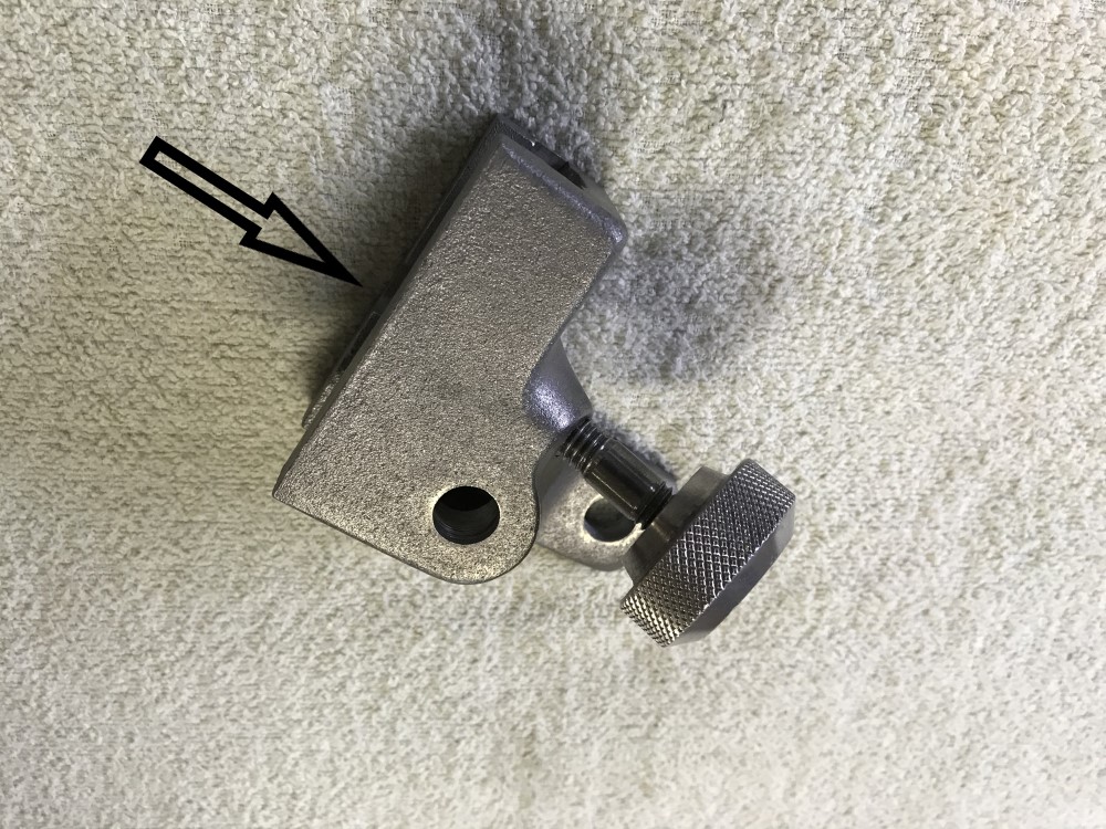

The Headstock is version 7 of 7 and the Tailstock is version 3 of 4. As for the fence, if you look in your fence's base as shown by the arrow in the picture below it will either have the end of the threads from the knob (version 3) or a wedge attached to the end of the threads (version 4.) I believe that is what Skip was referring to in his survey. Sorry, I don't have a picture that actually shows that but you can see it in the pictures added to Skip's survey.
Plain would be version 3 and wedged would be version 4.

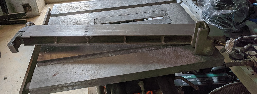

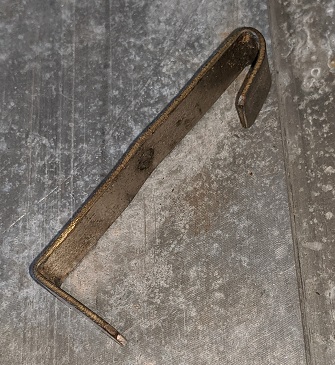

Re: Recent adoptions - Joint-Matic and 10ER

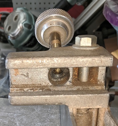

This one doesn't look like the 'wedged' version in the survey. I think it's an adaptation of 'plain' with a makeshift wedge made of a folded piece of sheet metal. The photos below show it without the makeshift wedge, with it, and the wedge separately.
- Without wedge
- fence wedge 1.jpg (94.94 KiB) Viewed 2871 times
- With wedge
- fence wedge 2.jpg (98.55 KiB) Viewed 2871 times
- Wedge
- fence wedge 3.jpg (92.78 KiB) Viewed 2871 times
Works too good to be OEM.
As you noted it is the third version of the fence with the angled lock screw without the factory wedge. Some enterprising person has added the extra strip of metal to avoid the movement sometimes occurring when it is locked.
