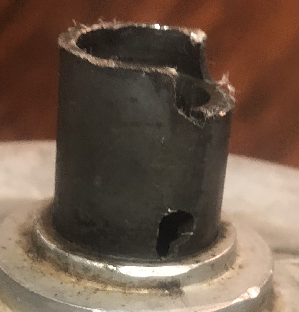

Well I broke it trying to get the outer shell of the bearing out anyway to repair?
- B0784EFB-74C5-4D0C-B459-C79DE376469E.jpeg (250.35 KiB) Viewed 2614 times
Re: Maintenance Mark VII
I tried with epoxy repairing one less damaged than yours and the success was short lived. I was fortunate to get one on e-bay. Keep watching! Epoxy AND a sleeve may work. How worn is the bore and keyway?
