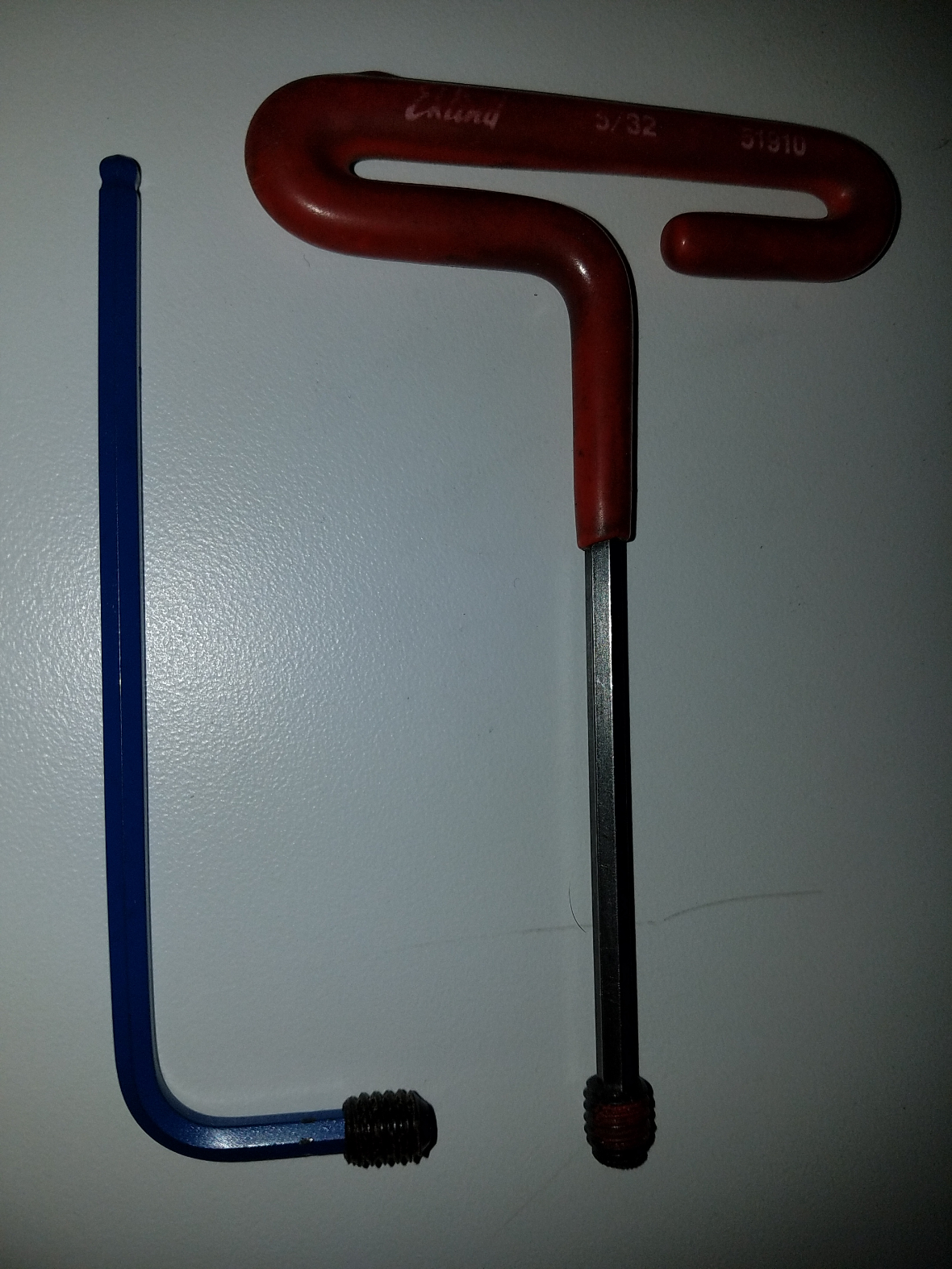

I don't know whether I agree with you guys or NO. If you are saying use a 4mm hex in an abused 5/32" hex to get it out...OKAY.
If you are advocating the routine use of a 4mm hex wrench on 5/32" hex socket just because it fits more snugly...I whole heartedly disaggree. Of course it fits more snugly. It is oversized.
I would also question this routine use because I seriously doubt that you can fully insert the 4mm hex into a 5/32" socket. Yes, it fits (somewhat) but can you bottom out the 4mm wrench into a 5/32" socket...NO.
I just now pulled two new 5/32" set screws from the shop along with a routinely used 5/32" t-handled wrench and a new (hardly ever used) 4mm hex wrench.
My 5/32" hex wrench inserts nearly 1/4" into the sockets of those two set screws and the 4mm hex wrench inserts less than half of that. If anything is going to produce wear-and-tear that incomplete insertion will do it.
The set screws that I replace most often are the two used for the table inserts. They clog with saw dust (which I ignore because of my hast).
I also grind down my hex wrench periodically to rid my self of the wear-and-tear factor.
4mm hex vs 5/32" hex

I was fortunate to receive a brand new set of both Imperial and Metric hex wrenches (Klein Tools) earlier this year as a gift. So there is no wear on these yet, i.e. I still use my 5/32" hex wrench (Eklind) that came with my Mark V. I tried this in my shop this morning and I don't have the same results. The screws that hold down the ZCI in the table wouldn't even let a 4.0mm hex wrench be inserted at all, but a new 5/32" wrench (and my old one) worked just fine. I also tried hub setscrews, etc. On those, the 5/32" wrench inserted fully and firmly, but the 4.0mm only went in maybe 1.0mm before meeting significant resistance. Maybe with enough force I could get the 4.0mm to insert more to where it would be able to turn without stripping the head of the screw, but I don't want to damage it. I would have to theorize that if you can get a 4.0mm hex wrench to work in a 5/32" screw then either the screw is very worn (and should be replaced), or your 4.0mm hex wrench is on the smaller side owing to manufacturing variance. As an fyi, I am using straight end hex wrenches. Could it be possible you are using a ball end hex wrench and that is why a 4.0mm wrench fits more easily into a 5/32" screw head?

Before I ordered the Bondhus I tried three other types/brands. I own one or two ball allen types, but I didn't use any of those. I tried both sizes with: Craftsman with 3/8 square drive, Husky folding style, and 1/4" hex drive type. I'm uncertain of the brand for the hex drive type, or even if they were the same brand. I have several and they sometimes get co-mingled. All were in good to near-new condition. All seated fully and in every case the 5/32" had more rotational slop than the 4MM. In some cases the 4MM was a snug fit and there is some variation among brands or individual tools.
I wasn't advocating the Bondhus or other 4MM as a replacement, though that is certainly how I'm going to use it. I was advocating that individuals try it for themselves with tools they already have and make their own decision. I'm not surprised that some don't fit, I was still concerned about that possibility when my Bondhus showed up. But I like the fit much better. Since adding a PowerPro, and knowing that there seems to be a systemic issue with setscrews coming loose, I tighten these fasteners much tighter than I used to or ever felt necessary, and the better fit between tool and fastener is important to me so I feel that I can tighten it without feeling like I'm going to strip the head or tool.
I tried the Bondhus 4MM in a brand new Shopsmith arbor-type setscrew. It seats fully, and has less rotational slop than any 5/32" tool I have. So where others have tried the same thing and it won't fully seat, I would conclude that either their tools are slightly larger or the socket in the screw/setscrew is slightly smaller. This could be either due to differing nominal values or differing tolerances.
