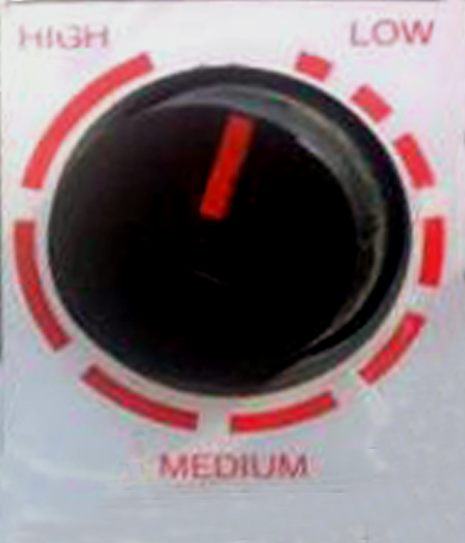

Planers without the large label on the cover apparently have only "High", Low", and "Medium" on speed control knob. The manual (page 40) has a "Speed and Feed Chart" that uses the same High, Low and Medium designations as well as giving more specific feed rates in SFPM (Surface Feet Per Minute), ranging from 5 SFPM (Low) to 12 SFPM (High).

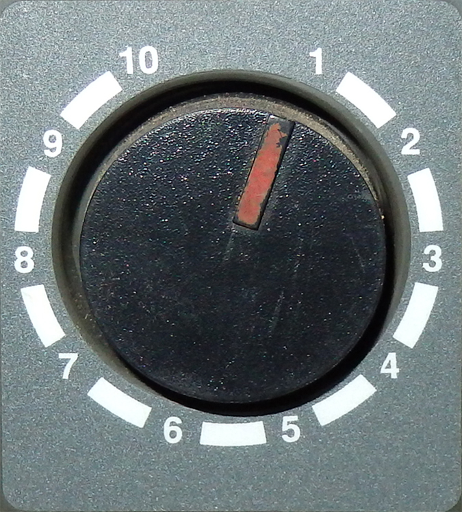

Planers with the large label on the cover apparently have numbers 1 thru 10 on the speed control knob, and these correspond to the feed rates shown on the large label.

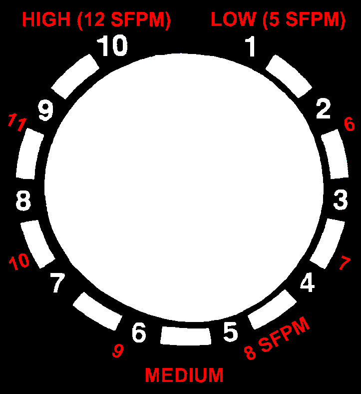

I have taken both types of speed control knobs and made one more "Universal" label.

- Feed Rate Knob Label with High, Low, and Medium Only
- H-L-M speed control for planer.jpg (207.52 KiB) Viewed 2348 times
- Feed Rate Knob Label with 1-10 Designations
- 1-10 speed control for planer.jpg (427.21 KiB) Viewed 2348 times
- Feed Rate Knob Label with 1-10 Designations and SFPM
- Planer Speed Control Label with Both Scales.jpg (173.17 KiB) Viewed 2348 times

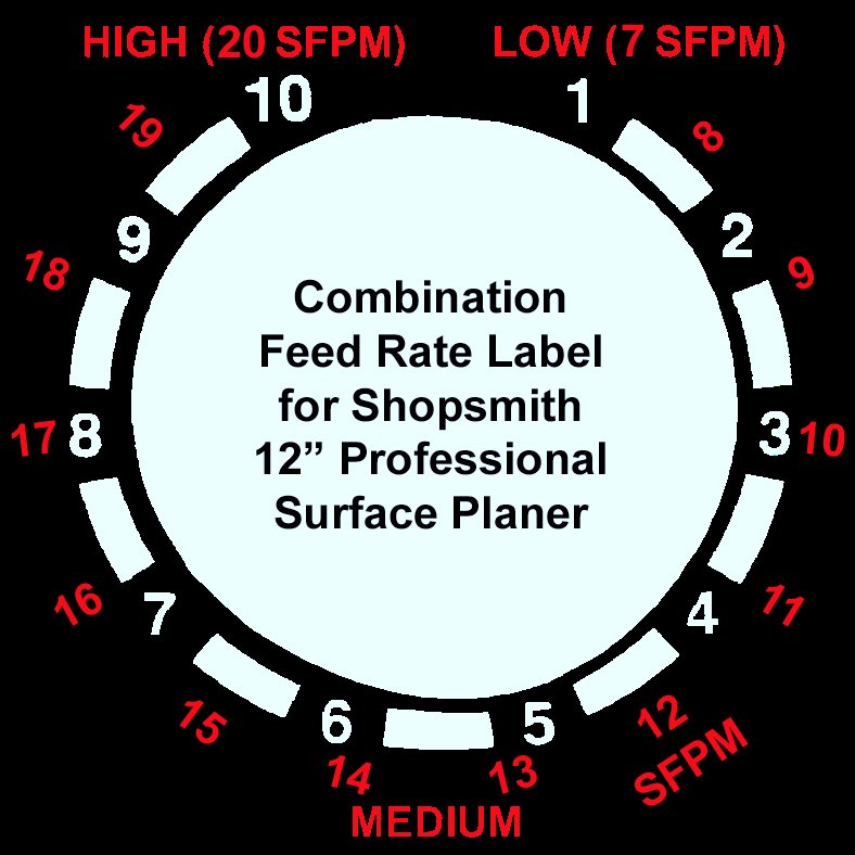

IIRC the feed rate varies between the power planer and the mark mount planer.(different motor)
- Posts: 645
Re: Request for Information

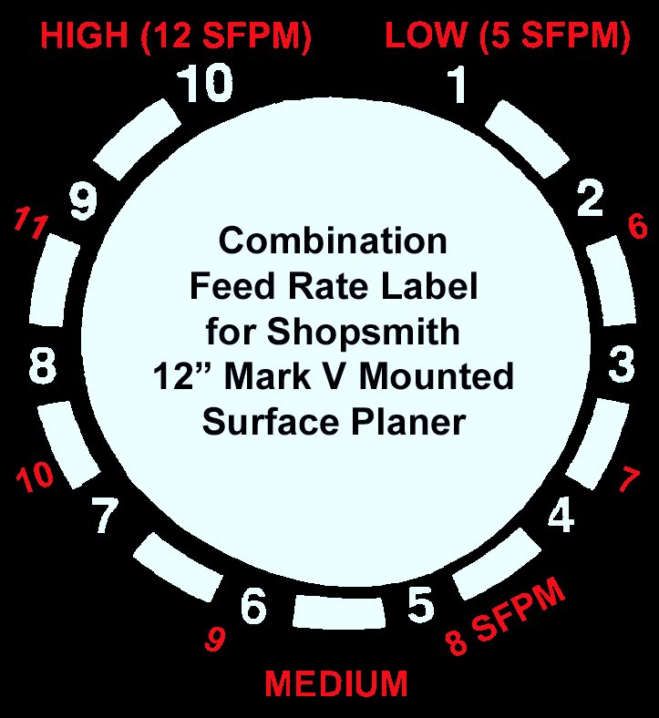

You are correct (as usual). I have made a second combination label for the Professional Planer. Thanks to Everett's restored manuals for all versions of the planers, I found that the feed rate for the Professional Planer varies from 7 Surface Feet Per Minute (SFPM) to 20 SFPM.
Thanks for pointing out that the feed rate range for different versions of the planer are not the same.
- Mark V Mounted Planer Speed Control Label with Both Scales.jpg (98.75 KiB) Viewed 2124 times
- Professional Planer Speed Control Label with Both Scales.jpg (104.39 KiB) Viewed 2124 times
