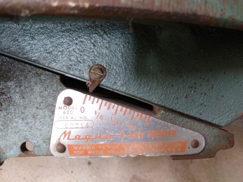

by DLB
My Jointer SN is 52814. I'm not up on SPT dates. My Greenie is estimated early 1957.
Jointer Plate.jpg (81.4 KiB) Viewed 912 times
- David

by chapmanruss
David,
Like the Mark 5/V production date by month chart, the Jointer chart is missing most of 1956 and 1957. Serial number 39063 was the starting number for February 1956 and the next listing is S/N 64426 for December 1957. Your Jointer was made in 1957. Thanks for the information on your Jointer.
