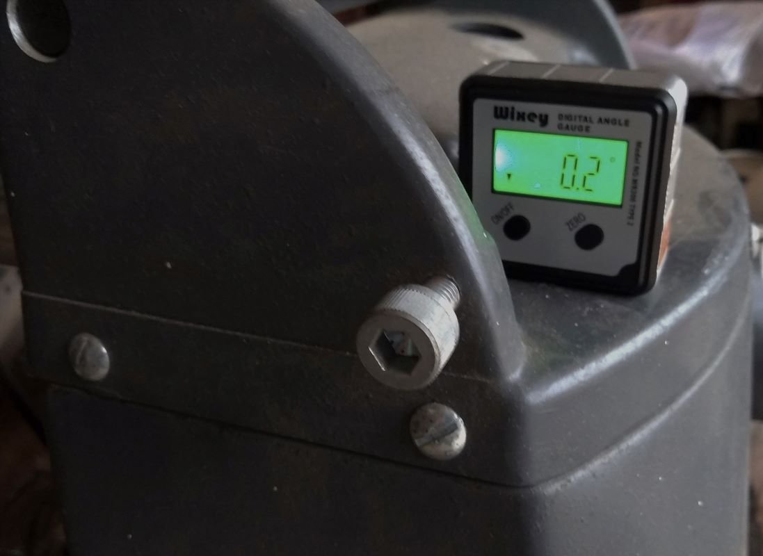

Also check for any deformation of the Bench tubes around the clamps. Some POs have been known to grossly overtighten the mounting bolts and partially crush the tubes. Going back to my first post in this thread if you are using some kind of angle gauge you can measure the flats on the lower Base casting, they should be essentially the same angle as the base tubes. Anything different would point to a problem with how the Base is mounted to the tubes. I'm referring to the flats where the upper casting land as a stop in DP position:

The part of the bench tube that is exposed is 48 inches. If I put it in DP mode and set the angle at 90 degrees there is a 7/16 gap between the right hand base and the end of the base for the way tubes. I don't have a digital level but the lower base casting looks to be the same as the one pictured above. I haven't been able to add pictures.

lalkie01 wrote: Tue Nov 24, 2020 9:39 am ...I don't have a digital level...
A smart phone app will work for this. I used to use a free one (Android), but I found it had a great deal of error as the angle moved away from zero, close to 10%, so I went to the Wixey. The phone app was very useful for measuring near 0, but you wouldn't want to use it to set a table angle. A small level would be close enough for this.
JPG wrote: Tue Nov 24, 2020 9:52 am 7/16"
If I did the math right 7 degrees would equate to more like 3/4" here and over 6" at the end of the tubes. If I'm understanding what the OP measured. I shimmed one with washers, almost 1/2" worth, and it measured just under 5 degrees.
