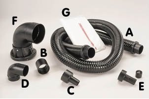

Re: New Shopsmith DC-6000 Dust Collector
Shopsmith used to sell a 90° elbow (item "F" in pic below) for conversion to 4" ducting, but it isn't available any more unfortunately. It replaces the 3 2.5" port plenum and was Shopsmith part #300003. You can still hook up 4" PVC without it, but it is a bit more clunky.
https://www.shopsmith.com/ownersite/cat ... ttings.htm
Another option is to build the octopus like they had at the Shopsmith Academy. It was just a plenum to hook whatever size PVC you wanted up to the DC-3300. Just keep the 3 2.5" hose sections short in length to minimize losses (see link below for picture).
viewtopic.php?f=5&t=859
Pages 8-9 of the document below discusses using the 4" Inlet Assembly from Shopsmith on the DC-3300:
https://www.shopsmith.com/academy/dustc ... 042202.pdf
There is a reason the 4" elbow is no longer offered. AIUI it does not work well(too low air velocity).
As Red says, the 4" adapter was discontinued as the older dust collector did not have the air flow for larger than a 3" line.
Agreed, but every time I try to point out the shortcomings of the DC-3300, someone comes to defend it here so I figured I would mention the 4" Inlet Assembly. I looked for it before, but could never find a used one anywhere. I have a small shop and was only going to run maybe a 6' or 8' horizontal trunk line to hookup to my DC-3300 with a few tools. I ran the airflow calcs and in theory it would have been fine for such a short duct with only one tool on at a time, but I abandoned this project. The problem for Shopsmith is they are stuck on 2.5" ports when the rest of the industry has migrated to 4" or larger ports. I would happily pay Shopsmith for a new lower saw guard that has a 4" dust port...same for the SPT accessories. Unfortunately, Shopsmith chooses to not offer upgrade options for this for customers (because it doesn't mate well with the DC-3300 in the catalog). I was surprised that the DC-6000 has the same setup with 3 2.5" ports. If it really can flow 600CFM and if 2 of the 3 ports are closed off, it is going to whistle like crazy through that one 2.5" port that is open.JPG wrote: Sun Nov 29, 2020 5:48 pm There is a reason the 4" elbow is no longer offered. AIUI it does not work well(too low air velocity).
