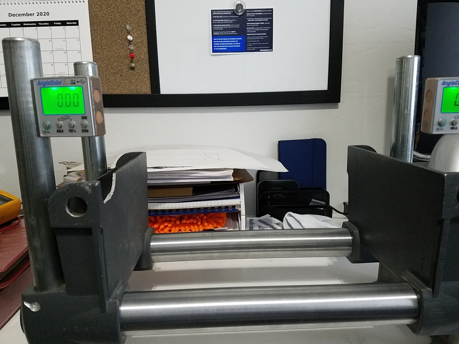

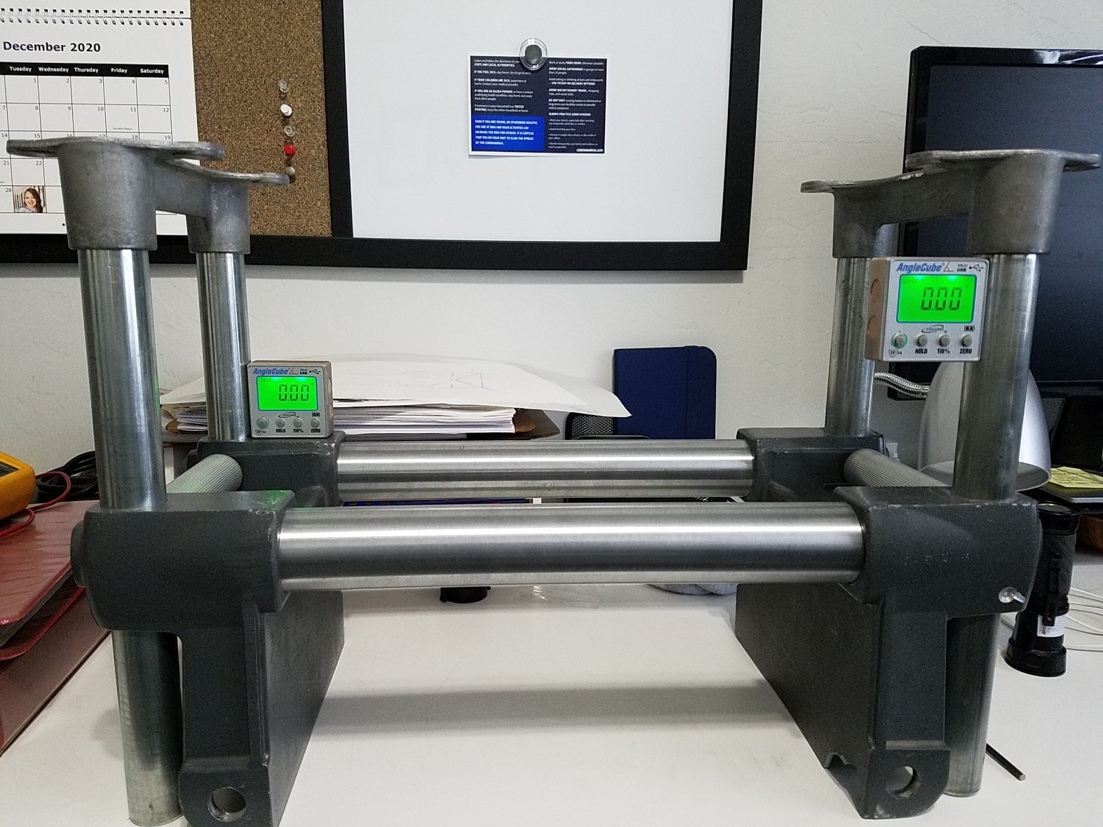

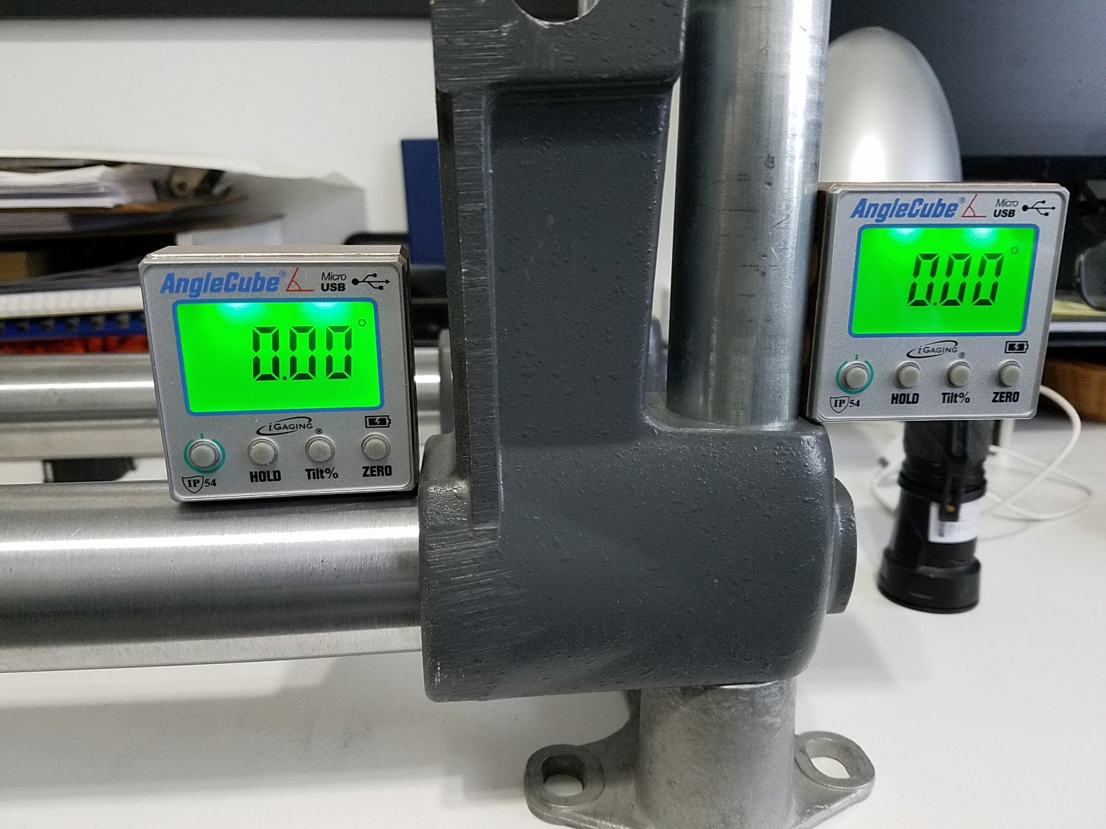

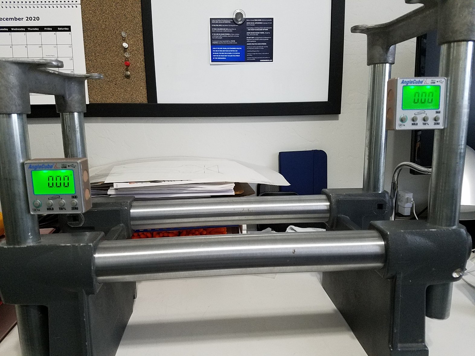

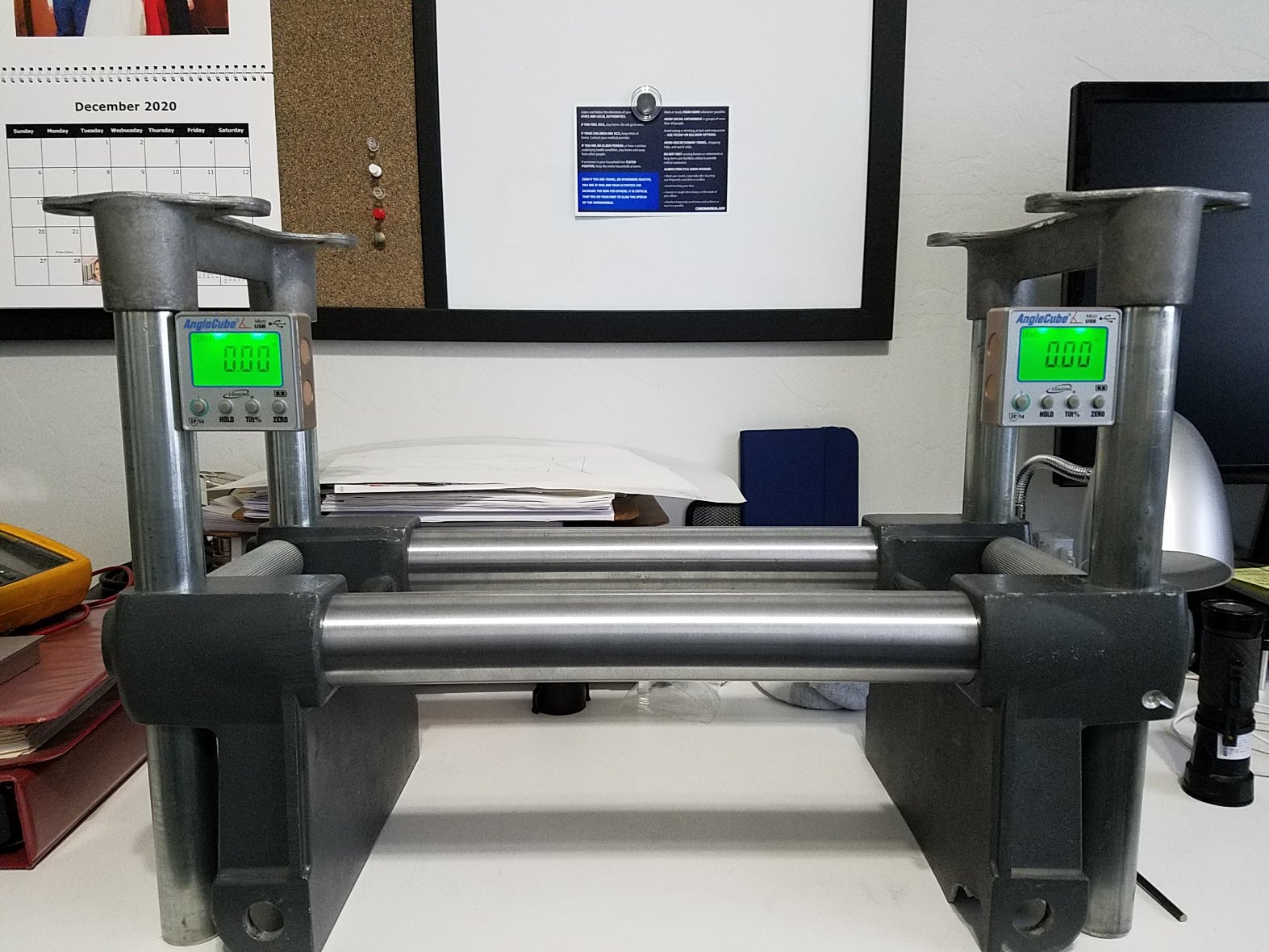

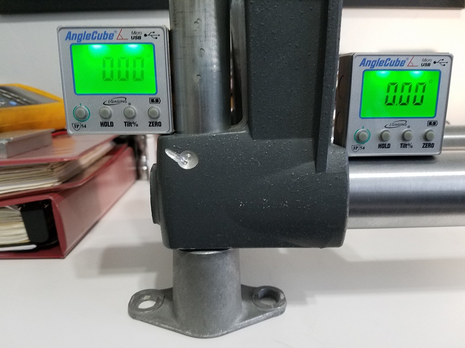

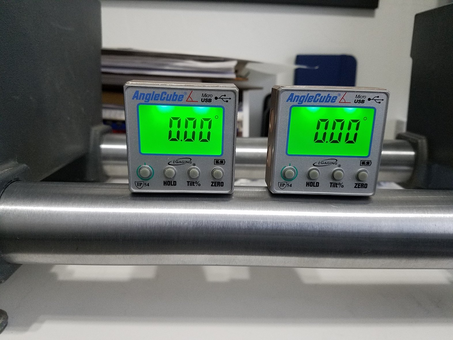

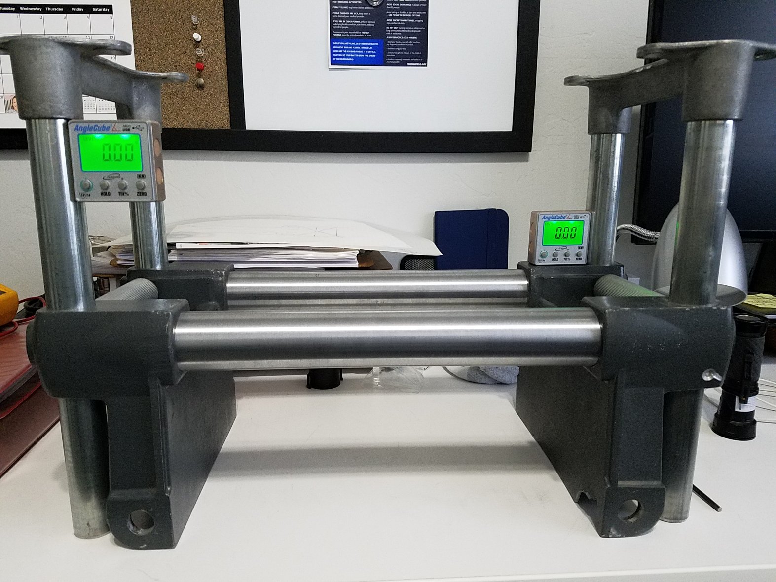

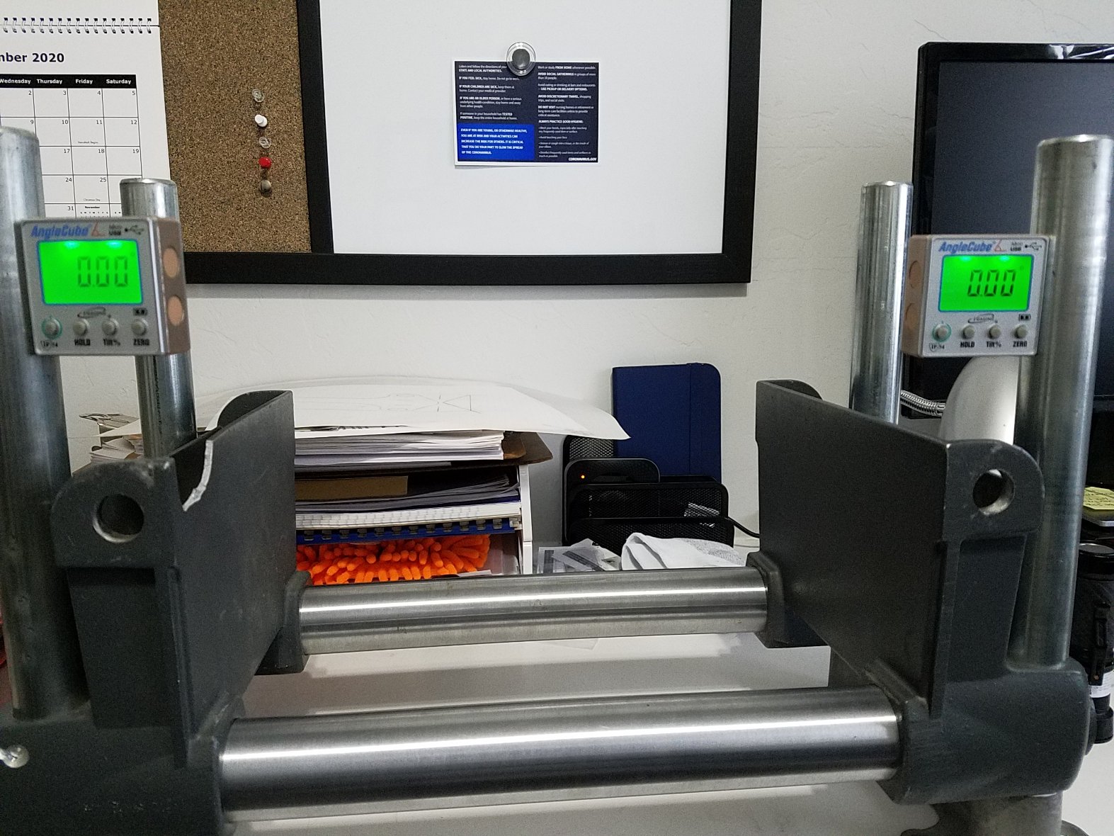

I am still convinced even after Algale created some doubt in my mind about Way Tube and Extension Table Leg bores. They are not sloppy enough to introduce significant variability. Do secure the locks; even the Extension Table Height locks.
The anglecubes were both zeroed while sitting along side one another on the Way Tubes.

A couple more points.
1. What you've shown above Dusty is the leg bore holes and bench tube bore holes are perpendicular within the resolution/error specs on those angle cubes. Even a small error that is within the resolution/margin of error of those cubes is likely going to be enough to make your tables not swappable within the level of accuracy you aspire to.
2. The above doesn't address the issue of whether the horizontal line through the center of bore holes for the table legs are parallel. I for one highly doubt even the double tilt castings with their built in stops for bench/way tubes are machined to tolerances sufficient to achieve perfect parallelsim from end to end. And if the bench/way tubes vary even a tiny fraction of an inch in length or the ends are not cut perfectly square, that could impact that too.
3. I just think there are too many variables and tolerances involved. Even the extension table castings themselves including the machining and drilling of the holes for the threaded studs could impact things a tiny fraction as could the casting at the top of the legs that the legs fit into. As I was trying to say and JPG correctly summed up, when you align any of the tables you are compensating for all those tiny variable and it is a lot to expect them to swap out side to side and not get some kind of variance.
4. If this were achievable and maintainable with the double tilt, I have every confidence that either you or Reible already would have achieved it and maintained it already.
