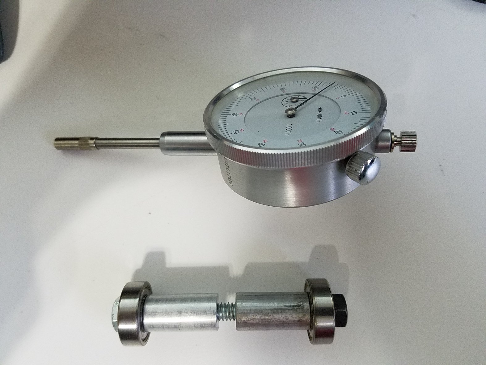

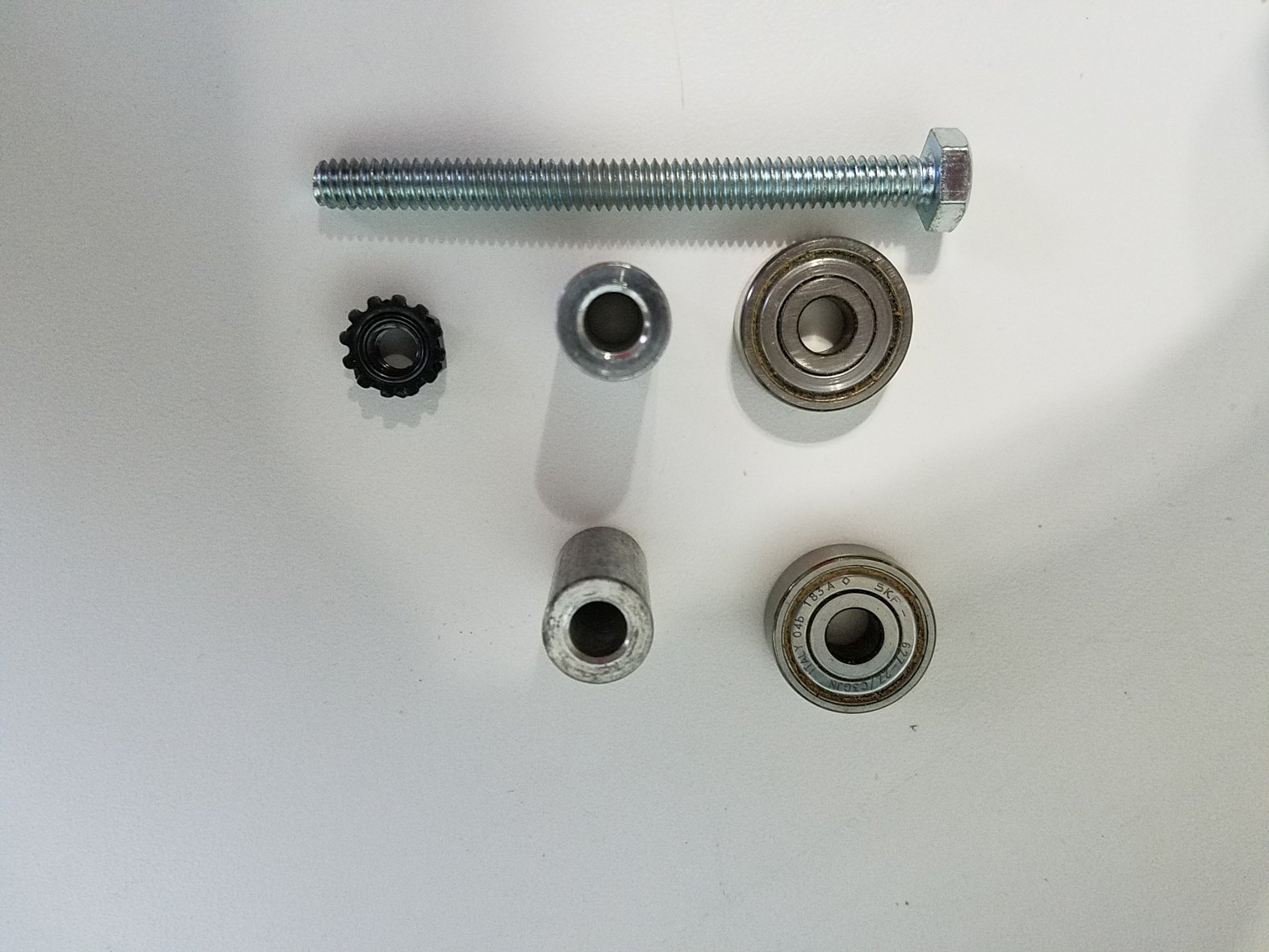

Use flat head screws(tapered head) to self center the bearings??? I assume the tapped holes in the ends of the rod are 'true'.
Re: A view on alignment of the shopsmith.
Bad assumption.JPG wrote: Mon Jan 18, 2021 12:26 pm Use flat head screws(tapered head) to self center the bearings??? I assume the tapped holes in the ends of the rod are 'true'.
That is simply a bolt, two bearings, two aluminum spacers and a nut. Nothing is tapered and the bolt may not be centered but it is tight and nothing in the assembly moves.
Correction: The bolt is not shouldered.

Thanks. Your dial indicator mounted to some bearings looks like a neat solution for alignment.

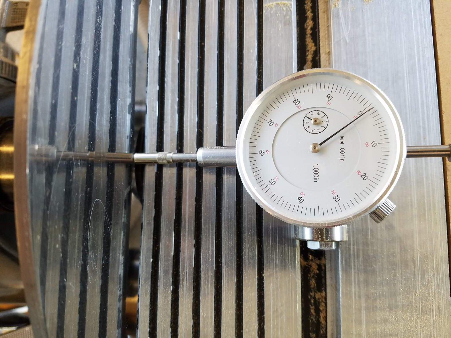

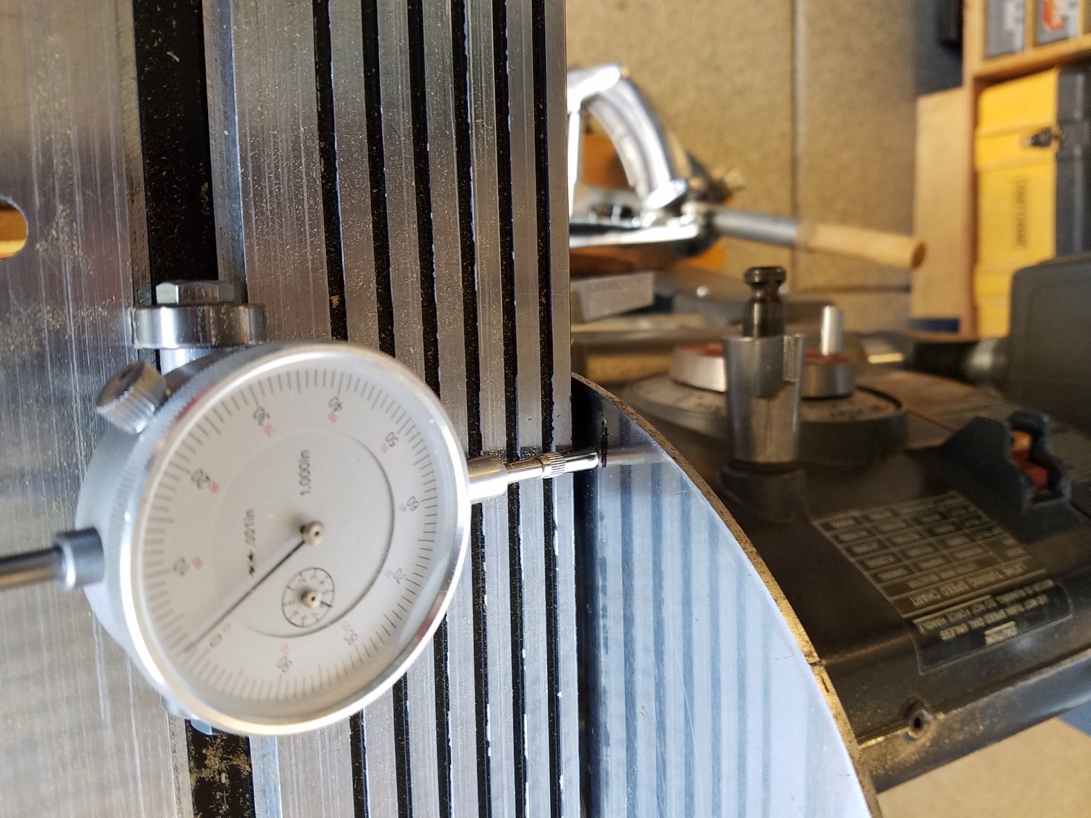

I don't know to what level of flatness my alignment disk is advertised to be but I do know that I am satisfied with the results when using it to align table to blade.
When I setup to make verification measurements, I do the following:
Zero the dial indication at the center (just above the spindle)
Mark the infeed edge of the disk at the tables edge
Take a reading (dial indicator) at the tables edge (at the mark)
Rotate the spindle to place that mark at the other edge of the table
Move the dial indicator to take a measurement at the mark
I expect for the difference between the two readings to be =< .005"
If the numbers are not satisfactory, it is time to do a complete table to blade alignment
I do that alignment differently than anyone that posts here and do not intend to "go there". I use the method that I use because it works and it is quick.
If I set the dial indicator at the edge and take readings as I rotate the disk, the readings on this disk deviate by .007" around the entire perimeter.
- Zero at the spindle
- 20210118_141259.jpg (330.42 KiB) Viewed 4273 times
- Measure at infeed edge
- 20210118_141221.jpg (304.98 KiB) Viewed 4273 times
- Measure at outfeed edge
- 20210118_141247.jpg (344 KiB) Viewed 4273 times
