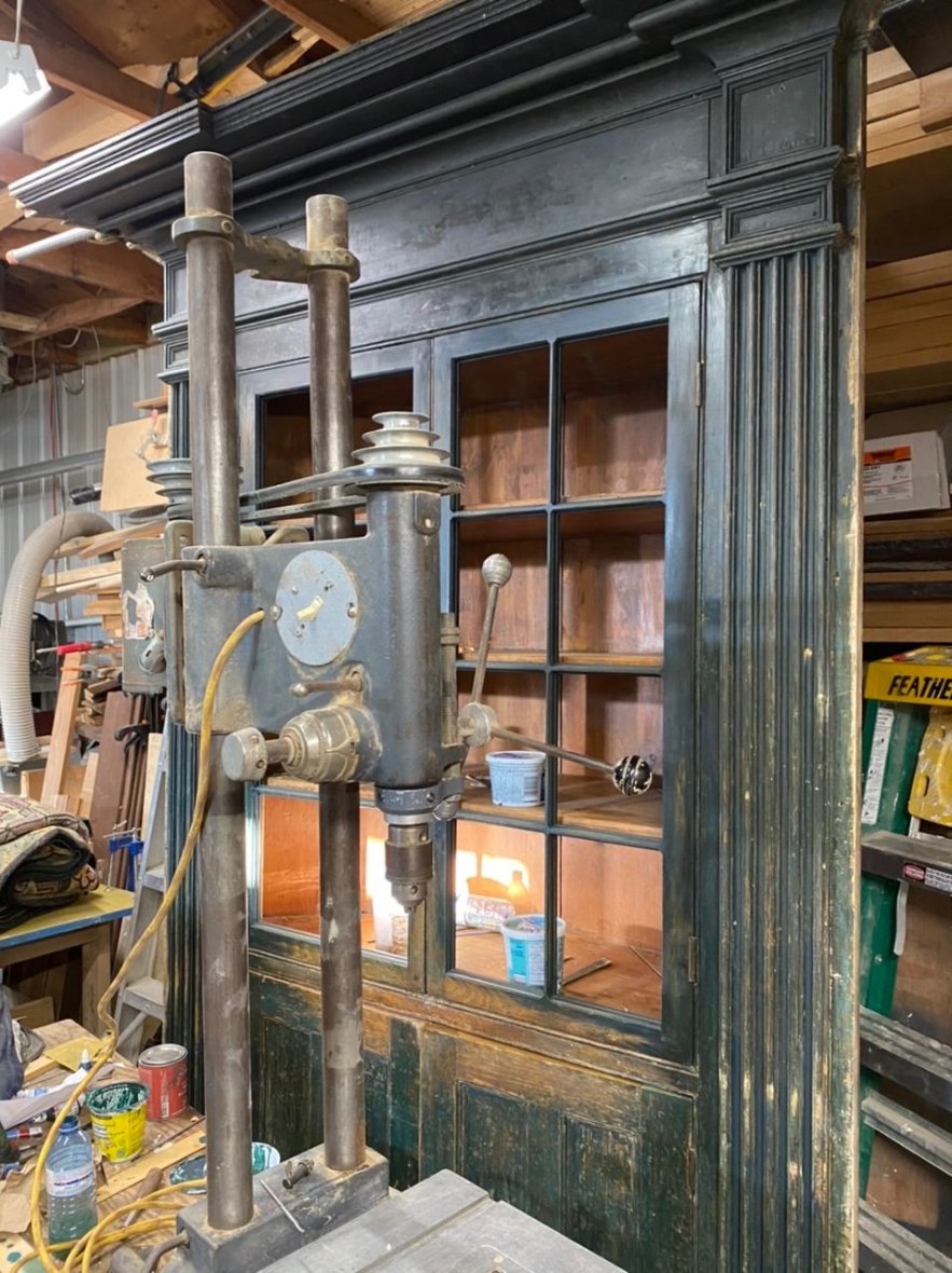

- 9FE0EF4E-A300-48A7-AE04-554E006E780B.jpeg (402.65 KiB) Viewed 29091 times
Re: Free 10E or 10ER Parts
2.3.4.5 pulleys?
Jwillbrick
- Bronze Member
- Posts: 5
- Joined: Fri Aug 12, 2022 10:25 am
Was like that when I got it from my father .
Different size pulley for different speeds
IIRC OEM pulleys are 2.3.4. You have a greater speed range. Take care of the headstock pulley - it has a non-standard bore(assuming the quill shaft is still OEM).
- Posts: 4538
Jwillbrick.
Great to hear you got it back together. JPG is correct about the pulleys not being the OEM 2", 3" and 4" step pulleys that originally came on the Model 10E and 10ER. The Headstock pulley may be a custom made one to have the 13/16" bore required for the Drive Sleeve. It looks like the largest pulley slot is 4" and the smallest is 2" with the other two slots somewhere in between. This still has your highest speed at 3450 RPM's and the slowest at 860 RPM's with the others speeds somewhere in in the middle. The Model 10's were listed as a three-speed tool with an RPM of 1725 or direct motor speed having the belt on both 3" pulley slots. It is interesting, at least to me, is that there was never anything about using different pulley matchups to get additional speeds. The OEM three step pulleys are capable of 7 different speeds not just the three listed in all the Owner's Guides and other printed materials of 860, 1725 and 3450 RPM's. This only requires realigning the pulleys to matchup the 3"-4" or 2"-3" slots for additional speeds. On your Model 10ER having 4 step pulleys you have even more possible speeds. One thing I have found matching up the 3" and 4" slots on the OEM pulleys is that a 1 inch longer belt is needed. The attached PDF chart may be helpful in determining speeds for the different pulley combinations you may have. I am interested to know what the actual pulley step sizes are that you have.

The pulley size are 4”,3.5”,2.75” ,and 2”
