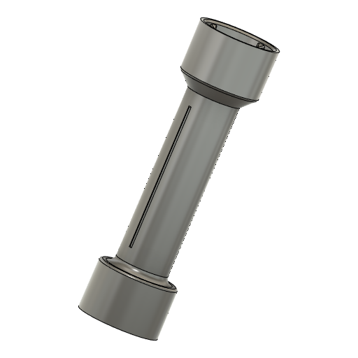

Yet another 3D printed coupler design

I had intended this to be a one-and-done project, but it appears there is considerable interest. To that end I've been doing my homework regarding making the best possible part.
i suspect a high-grade nylon would be better than the carbon fiber nylon. The carbon fiber makes the part stiffer, which probably doesn't gain much for this application. At the moment, Zytel is almost impossible to source, and is very expensive
So I am looking at Taulman 645 nylon. It is not cheap, but is much less than Zytel.
In addition, printing with a larger nozzle should increase strength by about 25%.
If there is enough interest I'll go ahead and purchase both.
As far as making ends only -- right now I'm going forward with a one-piece design and will consider that if all goes well. Gluing dissimilar non-solvent reactive plastics is tough. Probably the only way to go is a good epoxy. Nylon is especially slippery. The carbon-fiber nylon probably has more grip.
Updated design mockup with bevel at headstock end and an indicator aligning with a keyways.

- Shopsmith Connector v5b.png (74.51 KiB) Viewed 2989 times

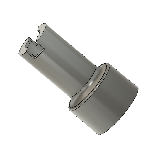

This is a mockup to fit in a 3/4" pvc pipe. I would rough up both interior of pipe and shaft of this part and use a good epoxy. Notch at the end for a bit of extra rotational grip and/or mechanical link.edma194 wrote: ↑Sat Dec 26, 2020 1:43 pm For same type of plastic there is often a very good glue available. Different plastics not always so much.
I think this application of one tube concentrically glued to another shouldn't be a problem for the proper glue. I don't think ordinary CA is well suited for this though. It would not take much of a small shear piece to prevent the joint from rotating loose.
I don't know much about the plastics used in printing, sounds like Paul knows what he's doing though.
Just brainstorming at the moment as I have a few mins of downtime.

Addressing the previous post.
Full disclaimer: I'm not a plastics guy and much appreciate your feedback.
Right now Zytel, of any type, is a no-go for me due to cost and availability.
Regarding injection molding vs 3d printing. Indeed 3d printed parts are weaker -- most notably along layer lines -- than their injection-molded equivalents. I have increased wall thicknesses to (hopefully) address this. I may need to increase further if prototypes don't meet expectations.
I have printed couplers in PET and in CF-nylon. The PET was substantially less resistant to breakage from lateral forces, such as when wiggling a snug coupler to free it.
(As a side note I suspect the current white couplers are PET -- injection molded of course, with its inherent adventages.)
Regarding rounding the sharp edges (stress points) in a glue-in version... that makes great sense. Thank you for pointing it out.
