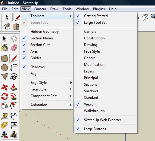

I have the free Google download and have pulled in no plugins. How many tools should I then have on my desktop? In the tutorials, there appears to be many more tools than I have; three rows/columns of tools. I have 1 row with 22 different tools.

Dusty, I keep the large toolset and views toolbars displayed. Most all of the video tutorials have the large toolset toolbar displayed. Click on the Views menu and select Toolbars option and you can turn on or turn off toolbars. Check the attached picture for reference. If you're having troubles getting up to speed with SketchUp or need help, shoot me a PM with a number, and I'll call you and help you out.

Thanks Tom. That answered the question I had. By clicking on the "Large Tool Set" I now have what I was asking about.
Now all I have to do is learn how to use it all.

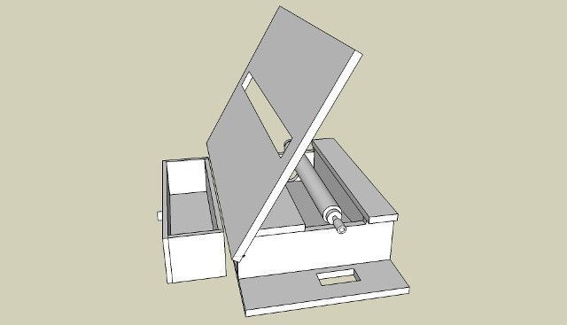

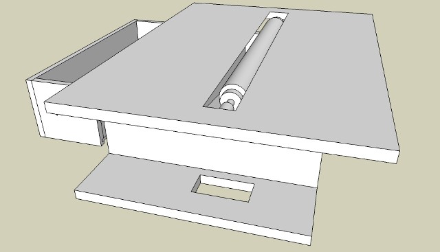

I have made a decision to power the Drum Sander with the MKV. I ordered a 5/8 motor arbor from Woodcraft for $5.99 so now I have some way to mount the pulley to the SS. Going this route I had to re-design the table. I plan on using T-Nuts mounted on the bottom to fasten it to the table while in use. On this one I incorporated a drawer to store sandpaper rolls, linkbelt and arbor when the sander is not in use.

This may be totally irrelevent at this point, but Shop Notes did a drum sander a while back. It was powered by a pulley mounted in place of the saw blade on a table saw. Might be worth a look for design ideas. I don't know which issue as I'm in Tampa right now and everything is up north.
