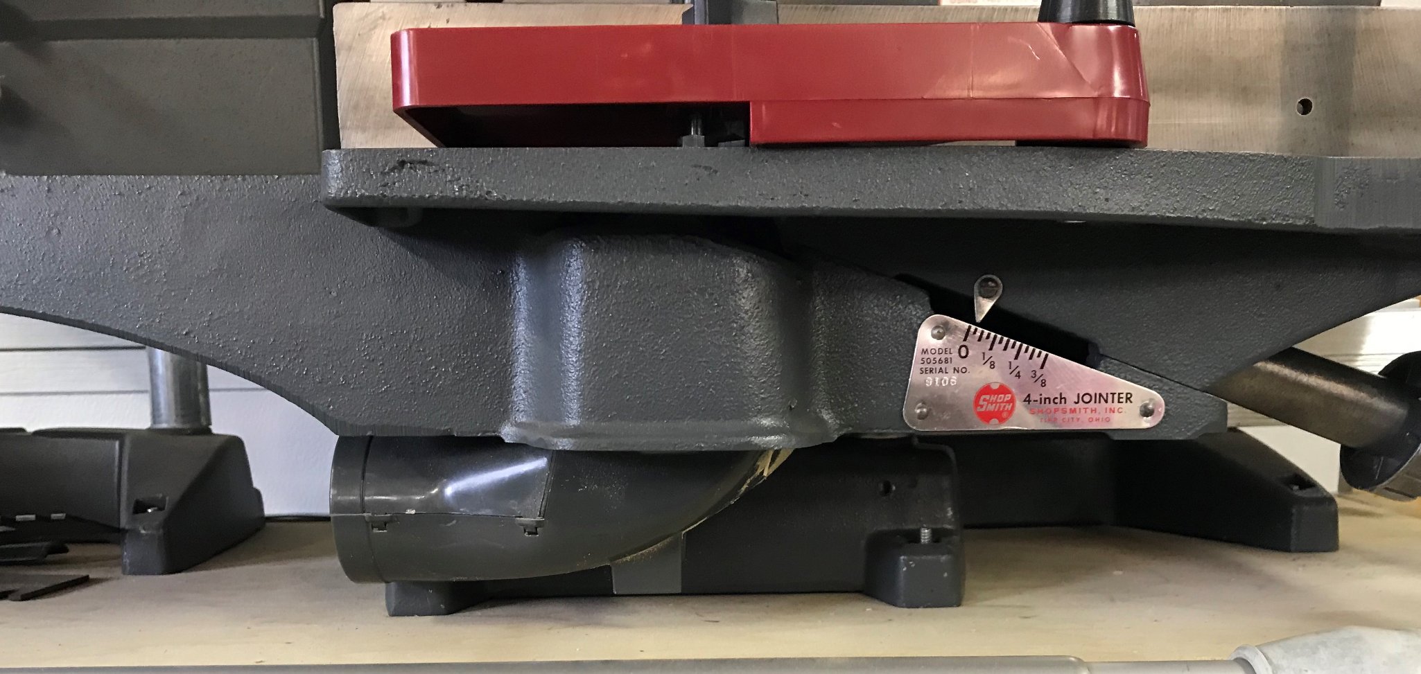

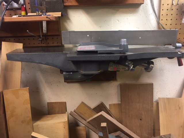

Here is how my Jointer sits on the Mounting Base. Although it is hard to see in the picture the Dust Chute does barely touch the base's mounting tab. A wood mounting base can be made using holes for the Mounting Tubes as long as clearance for the dust chute is made.

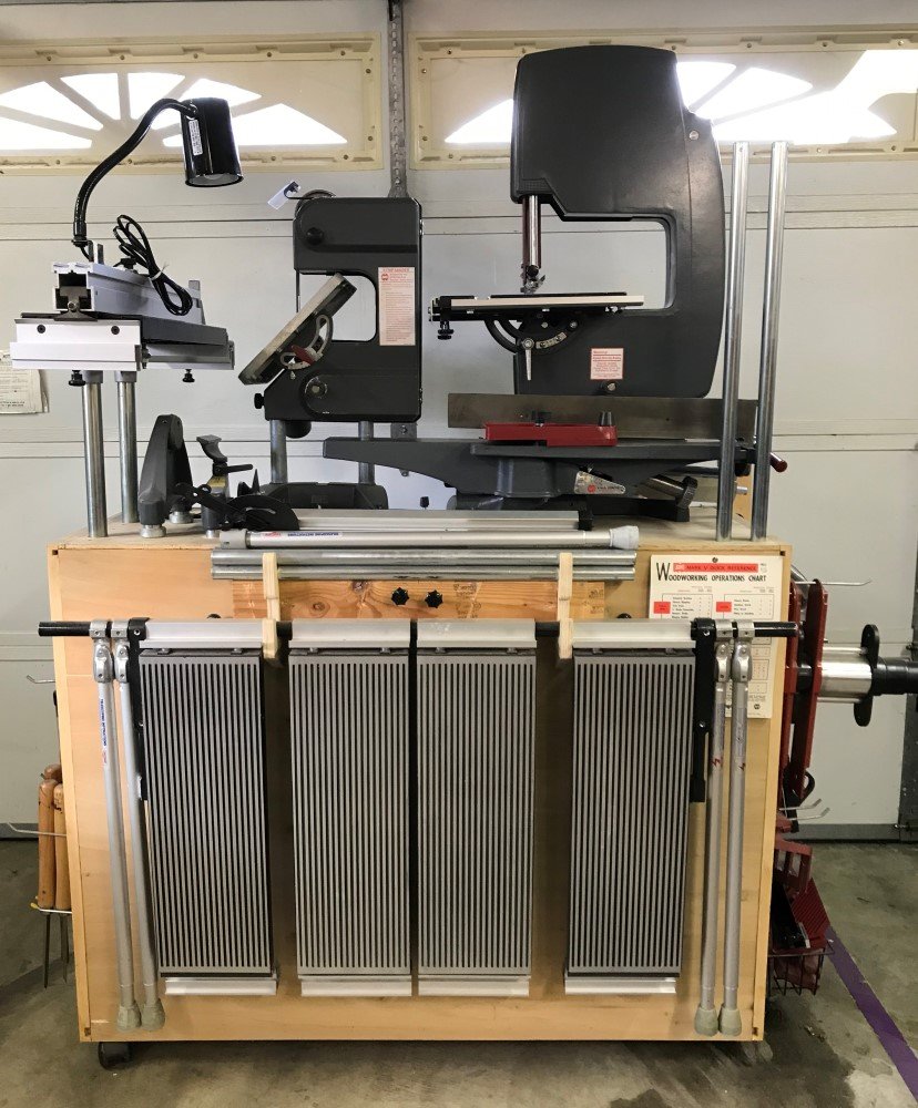

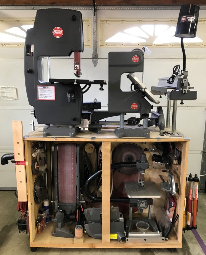

Since you asked for it I finally took pictures of my storage cabinet. It is on wheels so it can move around with the Mark V 520 or Mark 7. It keeps a majority of the SPT's and attachments close at hand.
Below is the front.

Below is the right side.
__

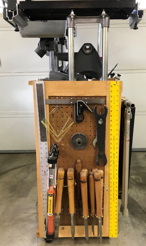

Below is the left side
__
Storage - left.jpg (98.45 KiB) Viewed 4397 times

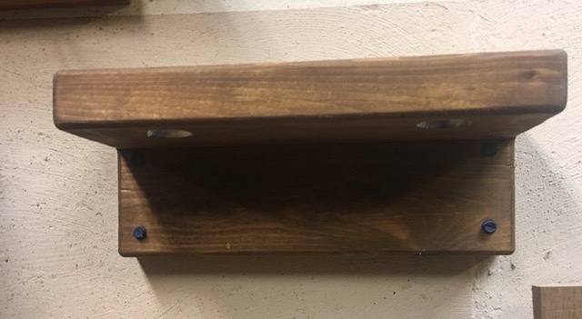

The ends are framed in pegboard which allowed me to change the arrangement of the accessories as needed. It was made from wood I already had left over from other projects. The table storage rack on the back is patterned after the one available for purchase. There are four 27" tubes and the Table Support Leg at the top of the rack. The brackets are cut out of 3/4" wood and attached to a 2 x 4 mounted to the back of the cabinet. 2 threaded inserts near the middle of the 2 x 4 hold the lock knobs for the center floating tables or main table while stored on the rack. There is not clearance for the knobs to remain in place next to the 2 x 4 while stored.

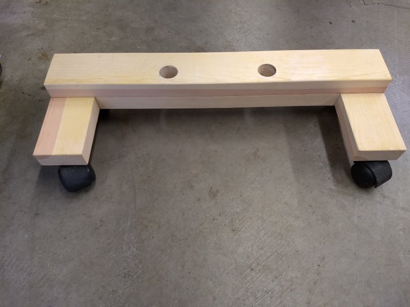

I made a little dolly for my jointer, so that I can easily tuck it away beneath a workbench for storage. The casters were salvaged from a broken office chair.

algale
Posts: 4841
Re: DIY Mounting Base?
Post by algale »
I like that design, Dennis! I use dollies for all my SPTs but they aren't that elegant!
Posts: 3814
algale wrote: Mon Jan 11, 2021 6:46 pm I like that design, Dennis! I use dollies for all my SPTs but they aren't that elegant!
Nothing but the finest scrap 2x4’s for my jointer! :D
Scrap 2x4? They look far too good to be called scrap. Clear, straight grain . . .
