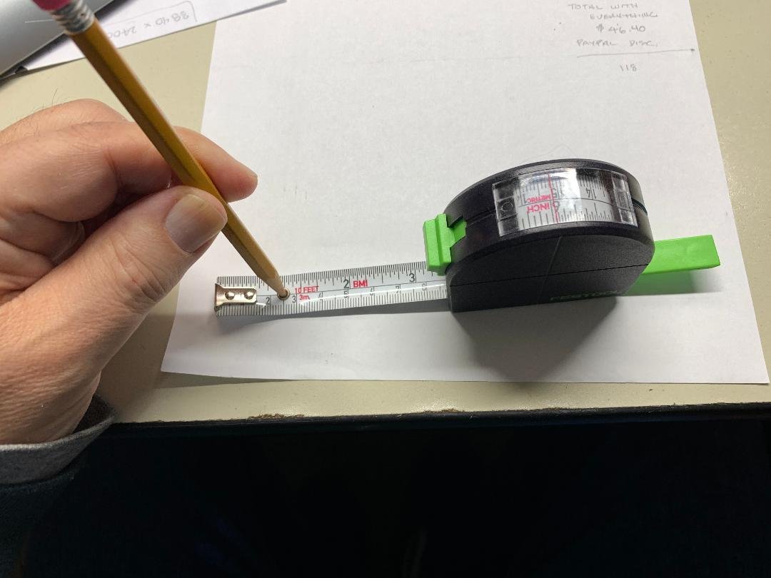

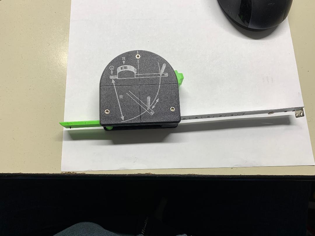

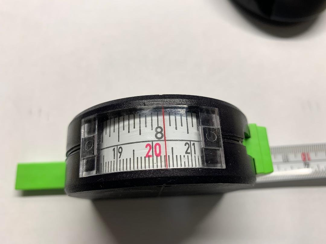

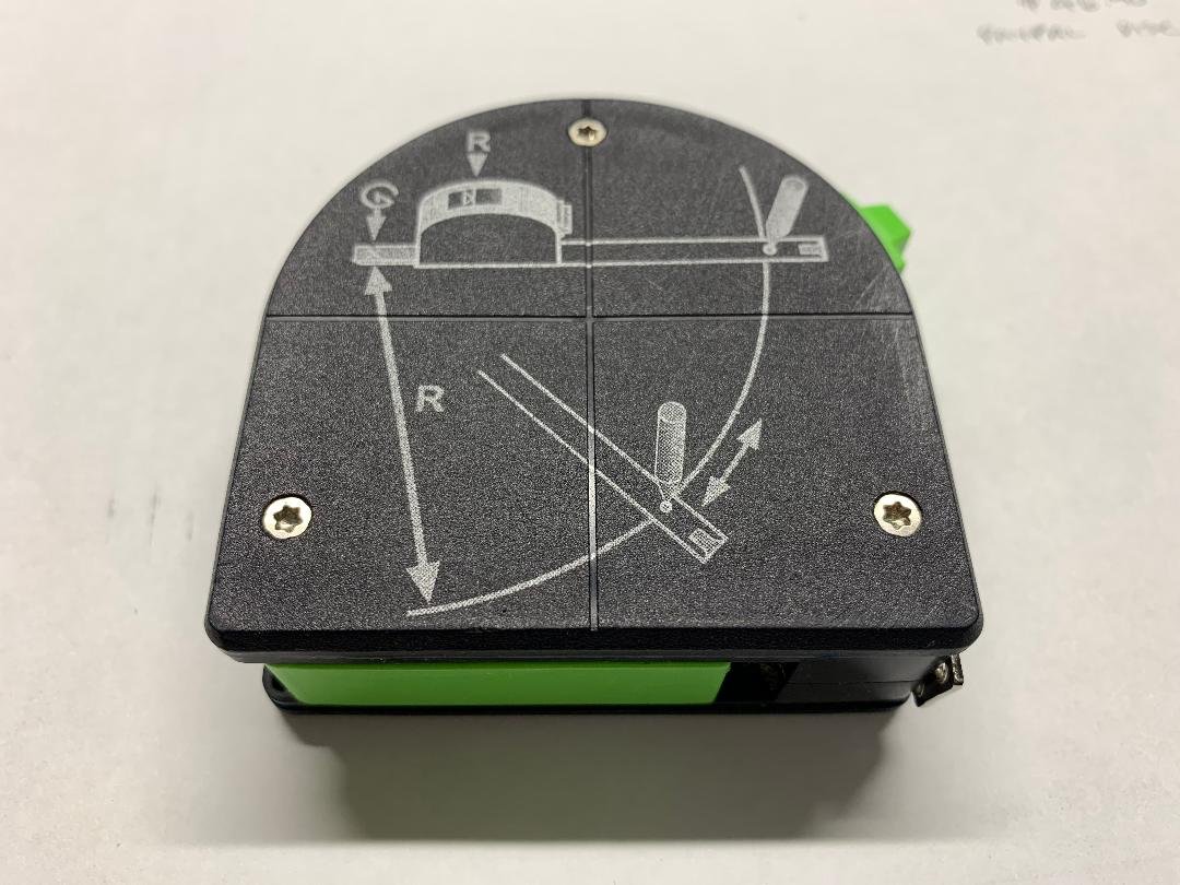

Re: Which tool do you USE the most
There are tape measures that allow for pretty large radius arc/circles. This one can do a radius of 118" but practical would be more like perhaps 72" which is still a pretty large circle.
