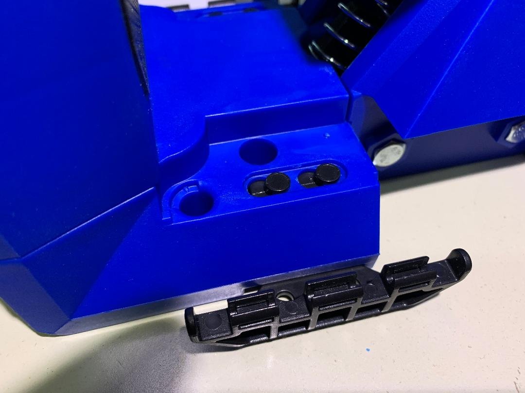

I think it might be useful to show some pictures so you can see the parts involved. I removed one of the "wings" so you can see inside and this makes everything much clearer.

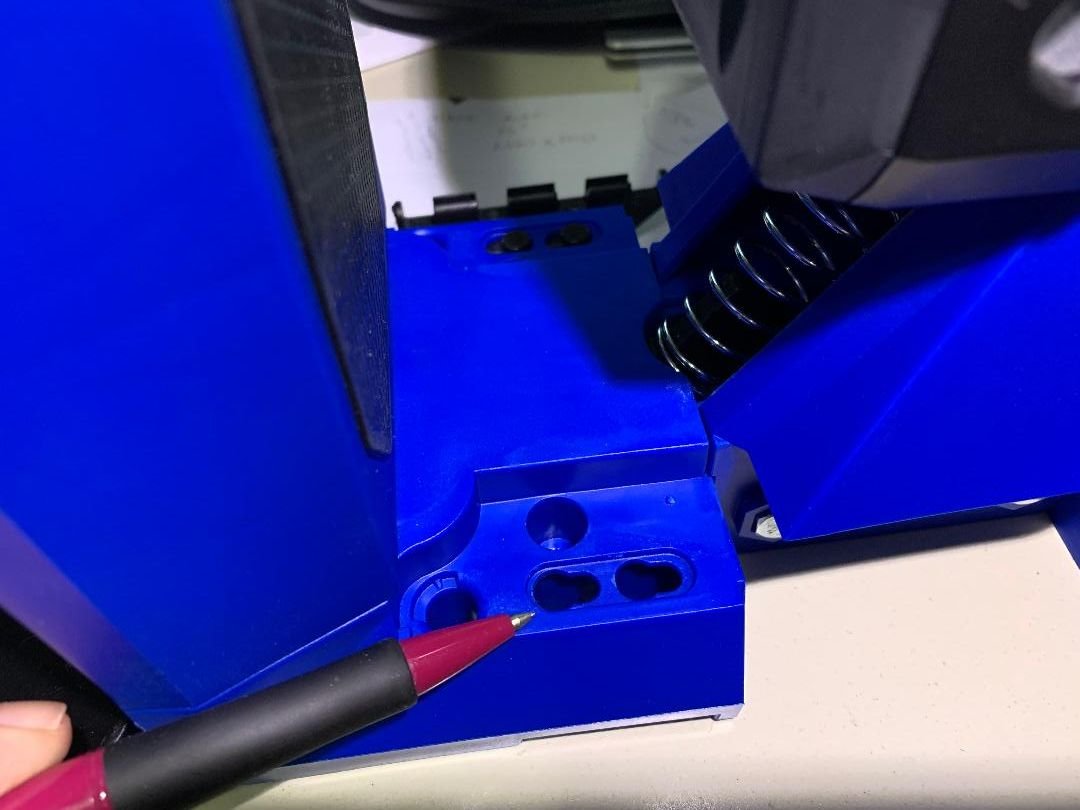

This first picture is the main jig and the slotted holes that the "lego" part fits in.

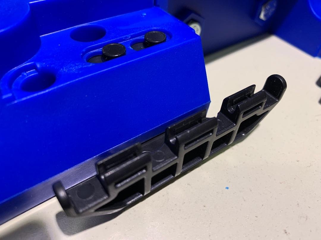

This next picture is the "lego" sort of part with the posts that "fit the slots", well more or less.

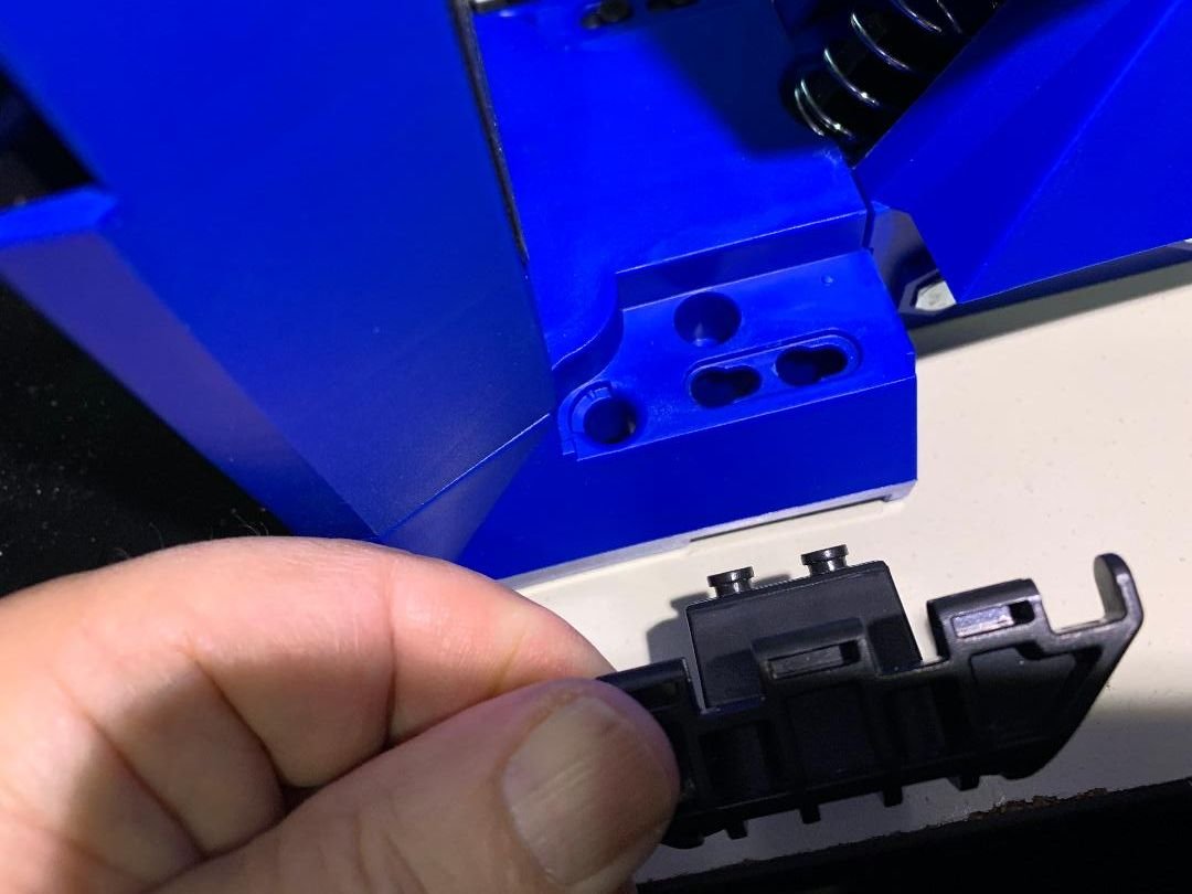

In this shot the two parts are mated and locked in position.

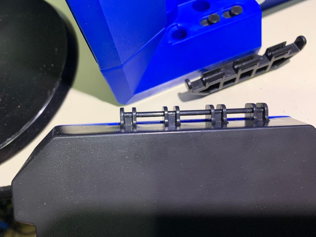

Next is the thin plastic hing on the storage box wings.
And finally the other portion of the hinge that resides on the "lego" part.
