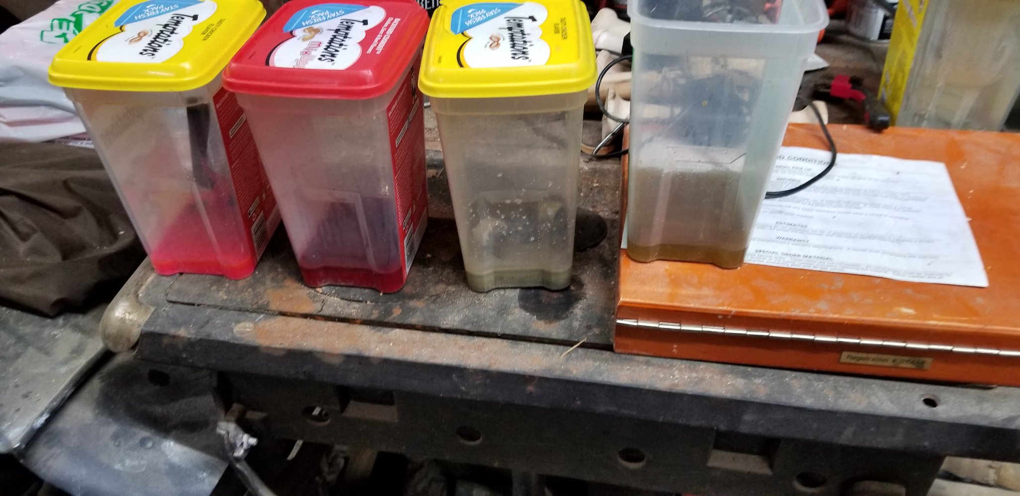

After wire brushing the screws and hinges they were chemically treated and re blued, one container has rust remover, one is a cleaning de-greasing solvent one is the bluing agent one is Kerosene and the last is a oil .

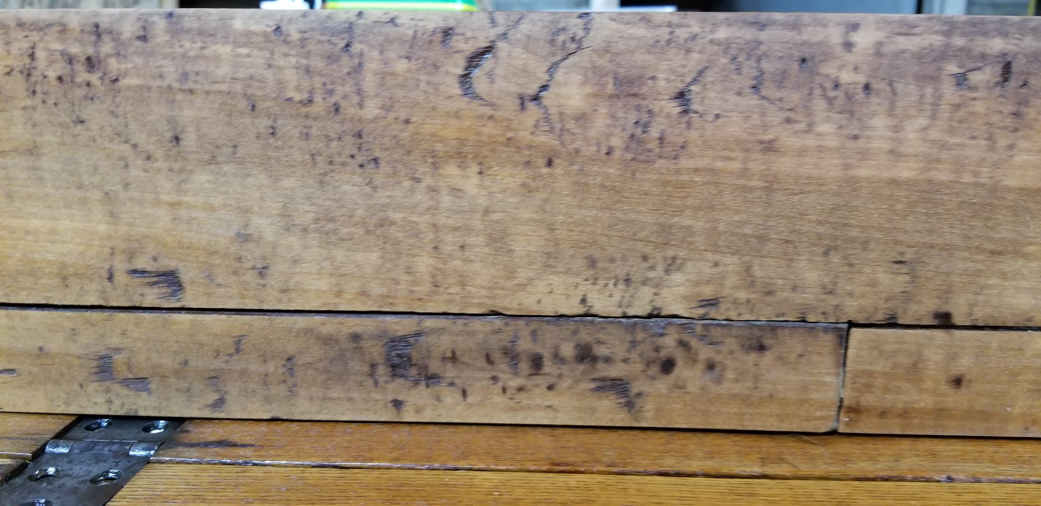

Here is a picture of the grain showing chips and fuzzy tear out that makes us believe this is butternut .

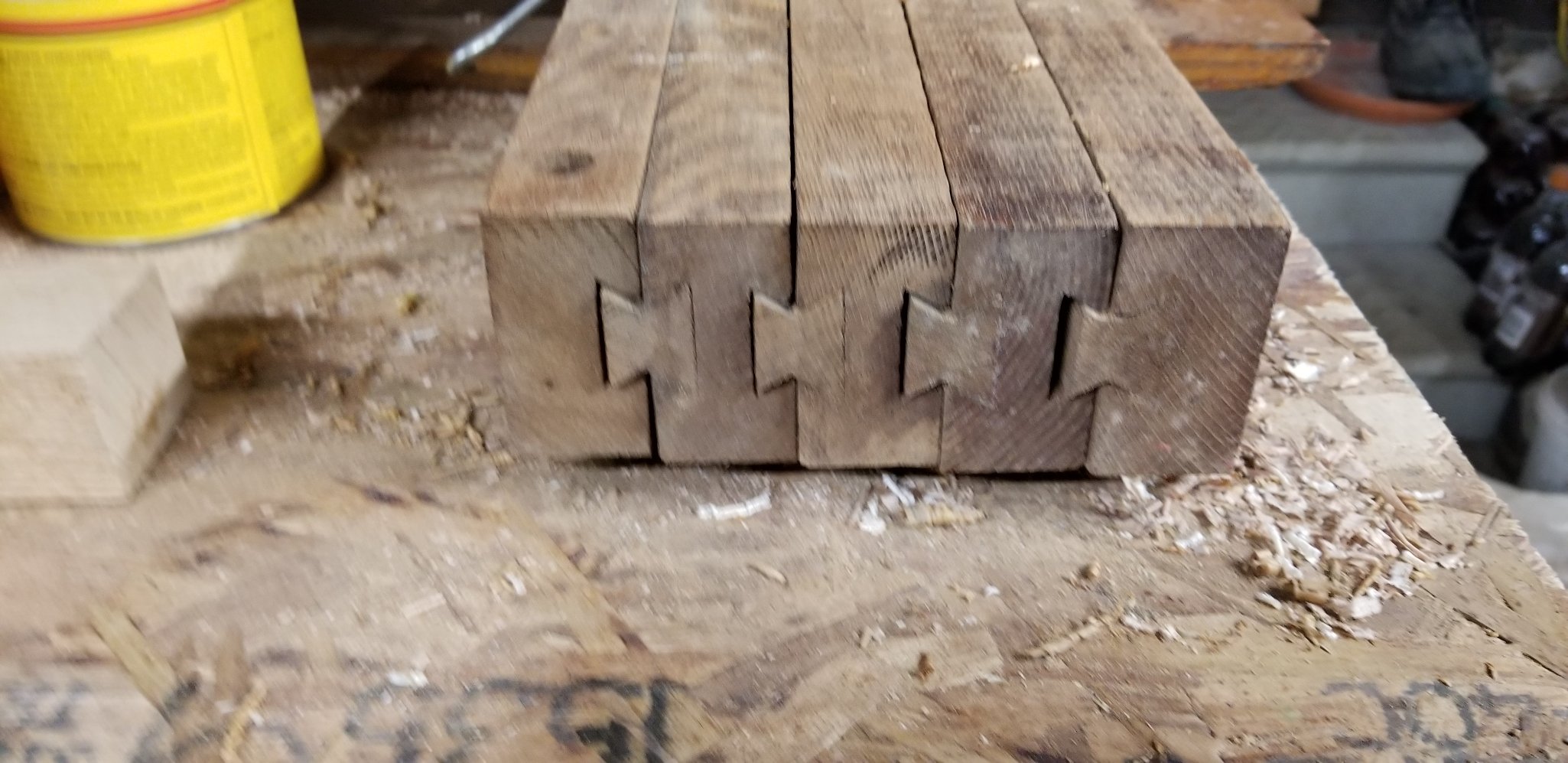

the sliding dovetails

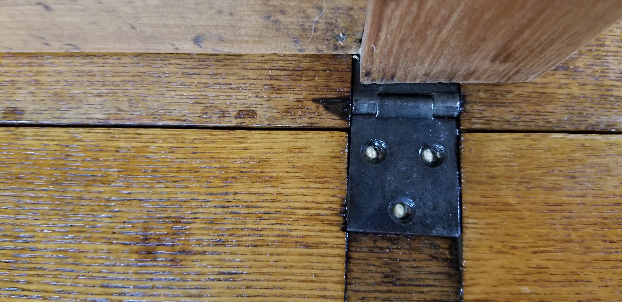

The hinges are looking a lot better , All of the screw holes have been plugged and will get re-drilled ,2 of the boards in the table top had came apart over the years, after the needed adjustments to the edges were made, and the grunges / table scraps / cleaned out the boards were re-glued
