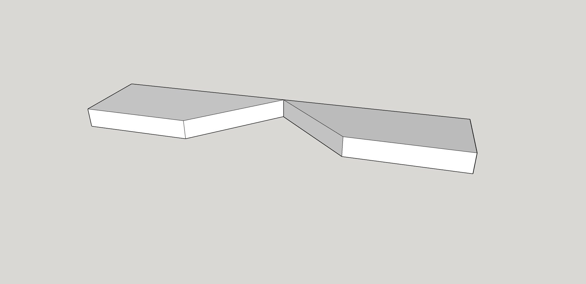

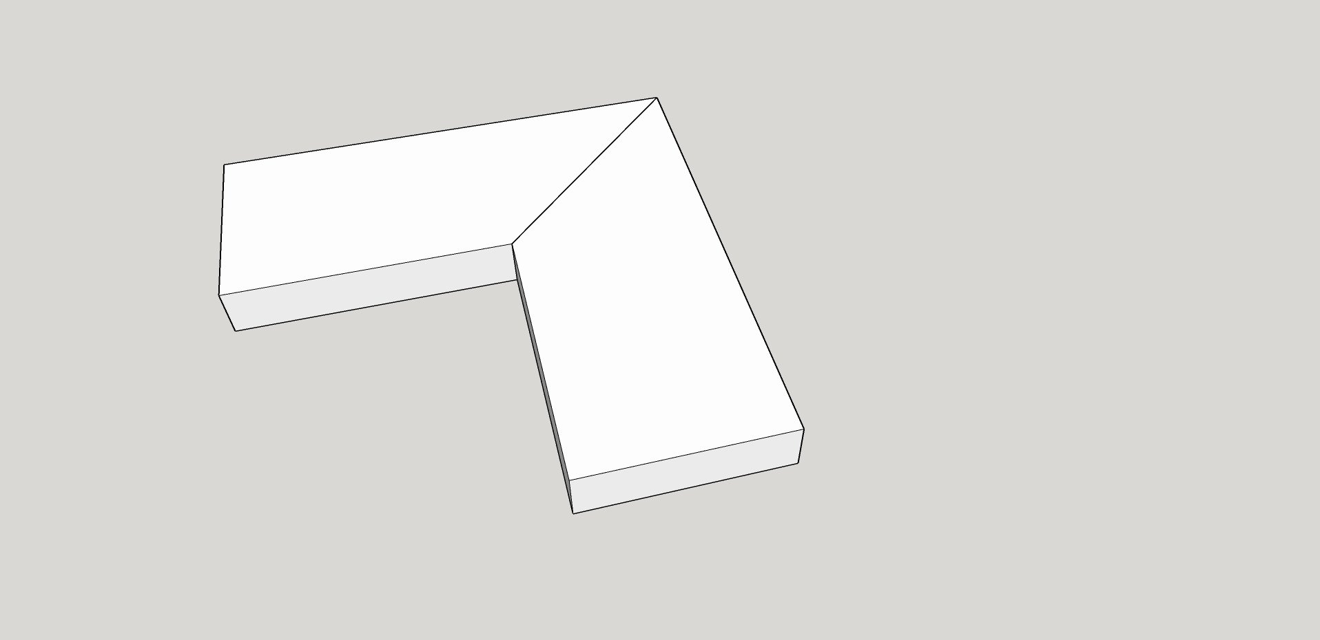

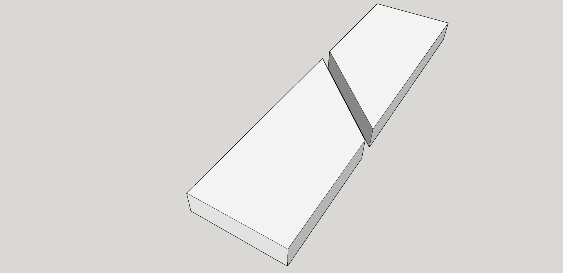

While we wait for pictures, could you do this without using the MiterSet. Use the miter gauge and whatever you would use to set it at 45 degrees.
The final fit (45.3) should be perfect and measure 90 degrees (both inside and outside). If it doesn't, the MiterSet won't help at all.
Now flip both pieces over and recheck joint for mismatch. Hopefully there are none on either side.
Perfect 90 degree corner???
