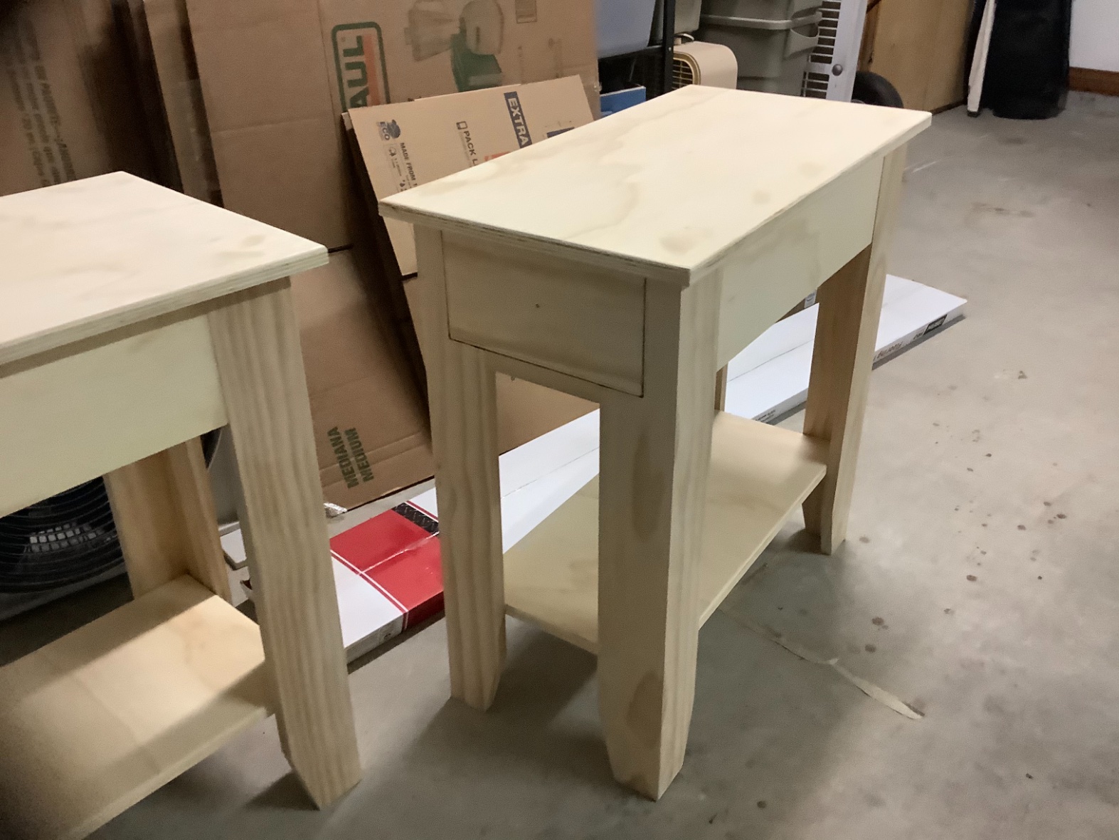

Here is a photo of finished (not painted) tables. They were made per the requests from my daughter with here plans for the construction method and style. I decided to use round over router bit on plywood top and shelf and filled in some rough spots with wood filler. One full extension drawer in each. She will put knob after she paints. This would not have been a suitable method if it were to be stained but it what I was asked for.
Posts: 3812
Re: Routing plywood
And fine-looking tables they are! That uniform gap around the drawer wasn’t the work of a beginner.
I’m curious about your daughter’s painting plans. Any chance we can see a pic after she has worked her magic?

Yes, I’ll get her to send me pics. I believe she is painting black to match other stuff in room. Unfortunately black will show all imperfections. I hope she puts enough coats with in between sanding. I ‘ll suggest and see how that goes.

Nice ! the edges came out very nice .

I like the side draw(er) idea !
