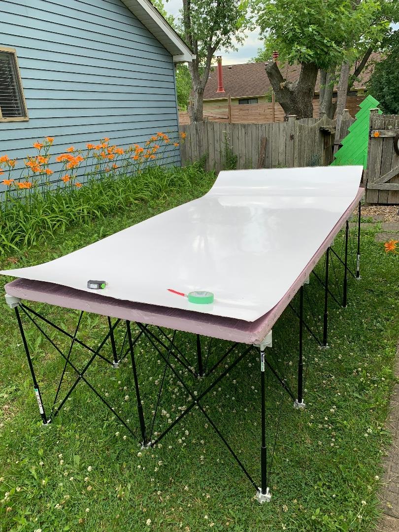

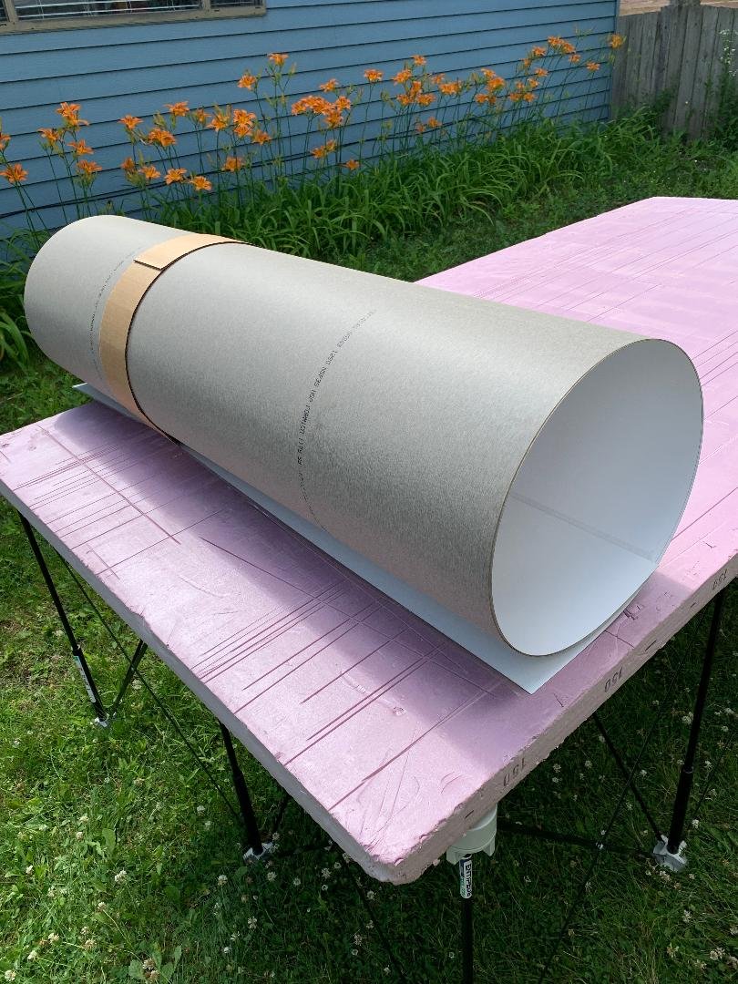

Finally got on this project. I did have to order the material online. It did as expected come in a box where it was rolled up and protected.

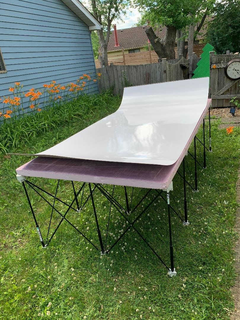

You can see the memory as it was unrolled:
Even sometime later it still had a bit of a memory:

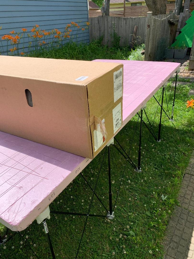

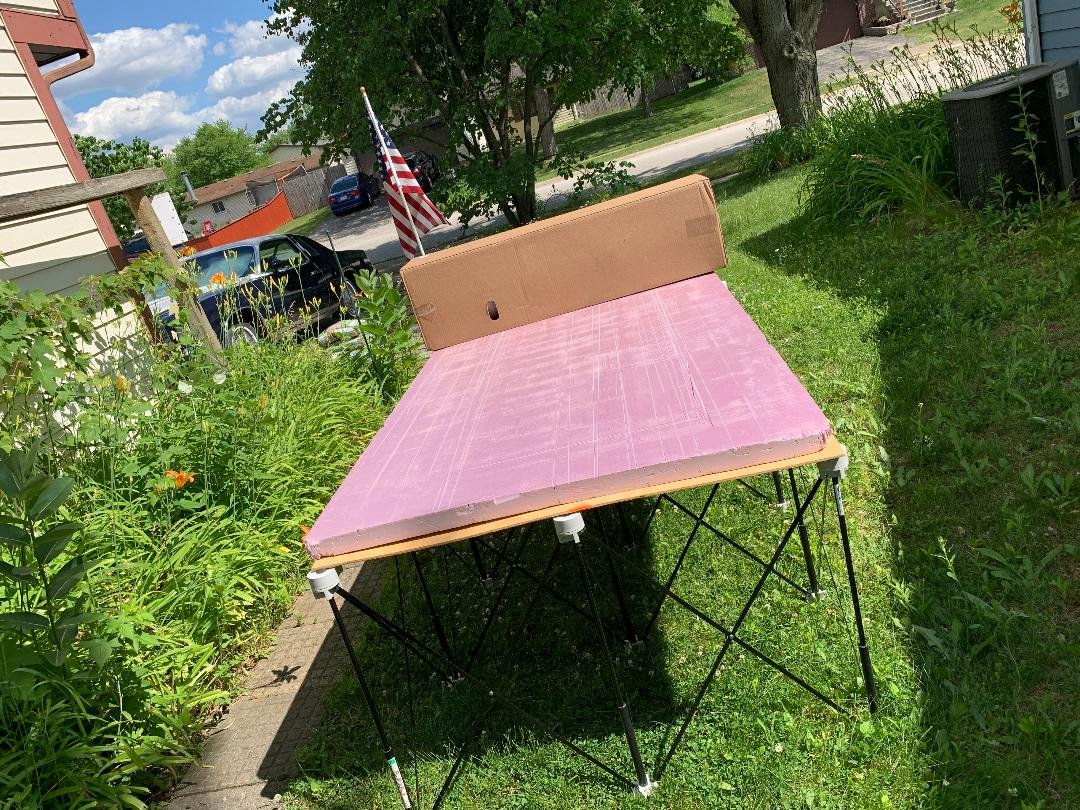

At about this point the sky darkened and it looked like it could rain so I had to go into super mode and get it cut up. Sorry no pictures.
I used my track saw and the new blade in the saw and it cut beautiful. Nicer then I had even hoped for.
The cut pieces still have the curl but still have a few days before I will be putting them on so fingers crossed they go flat or the curl doesn't effect the procedure.
The cut pieces were for half the project and I ended up with about a 1/4" strip that was waste. I found that all the lengths were the same and then 3 height versions so not to bad. The other half will be a while since it a destruction project before I can get the measurements. At least it is now in manageable sizes I can store.
