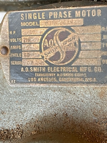

In John's pictures above the upper belt cover that originally came with yours would be the one on the left. As for the wiring I would replace it. That is something I do for all my Model 10 restorations and I do use 3 wire to ground it plus a new switch. At 70 years plus or minus the wire and switch are iffy at best so spend the $20 to replace them. A lot of them have had cracking insulation. It may require splicing the new wire to the existing wire inside the motor or the motor may have terminals. For the ground I usually attach a ring terminal and put it under the cover plate and screw.

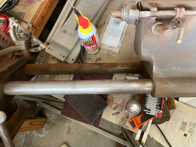

I began working on cleaning up the machine...I was able to get one side of one way tube pretty decent, but the other end is not cleaning up as well for some reason.
Also wondering what the closest shade of gray enamel would be...hoping I can buy it at Lowes’s... I saw quite a few colors of “professional enamel” spray cans there recently. Also, should I use the spray “cold galvanize” product on the cast iron parts? (After masking where appropriate, of course)

The paint on the one I restored shown in the previous post is Rust-oleum Charcoal Gray paint and I add a Matte Clear Coat to remove the gloss finish. It is one of the closest colors I have found to the original color. I use Rust-oleum primer prior to painting it gray. Do mask anywhere paint should not go. It is easier to keep paint off surfaces than to remove it afterwards.
One thing I noticed in your last post was the Headstock and the Quill Lock installed backwards. The handle should be on the front side.
I had mentioned but did not directly ask, do you have an Owner's Manual? One thing the original Owner's Manuals recommended under maintenance was applying a light coat of oil to protect and lubricate the way tubes and other parts. Do NOT do that. Instead follow the recommendations in the supplement PDF attached below.

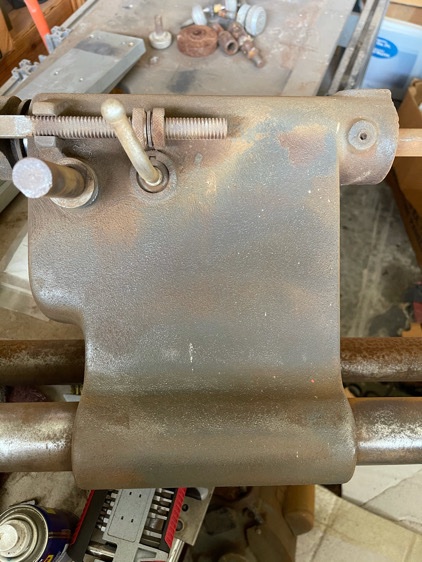

More pics of progress...

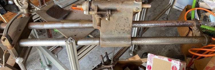

- Posts: 35451
Re: Beginning fixing up a 10E — Need help please
Cannot tell fer sure, but the headstock appears correctly mounted. The carriage appears backwards. The quill lock is on the back side rather than the 'operator' side. Reversing the carriage will place the carriage lock on the 'operator' side. The trunion is correct to the headstock, but reversed with the carriage.
